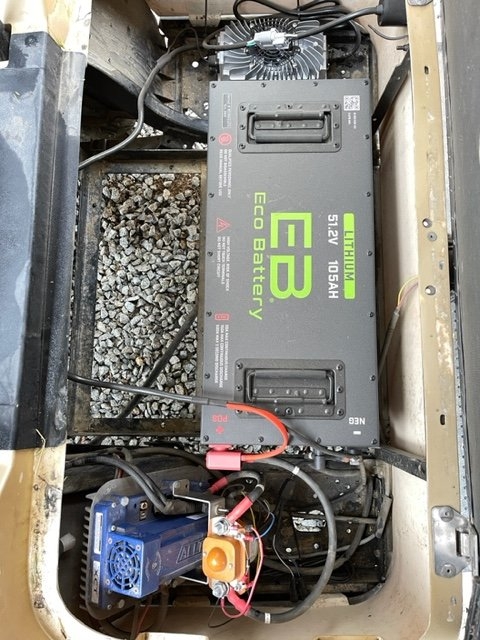

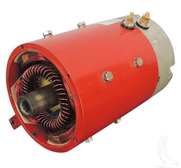

We have used modified electric golf carts on our ranches for 50 yrs. Terrain is rolling soft to rock. Big 14 hp high torque motors, limited slip conversions, Lithium battery packs, and big controllers are a game changer for these handy carts.

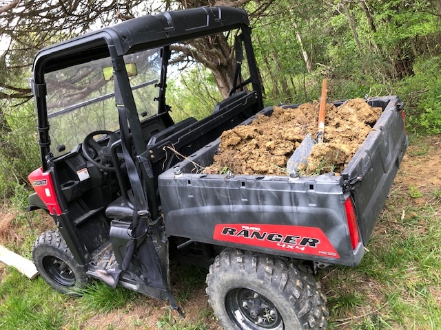

We have a 2017 Ranger 500 that my wife gave me for Christmas in 2020 (used) - what an incredible surprise! - to use at our lake cabin.
It's the only ATV I've ever had, so minimal experience here, but while I typically operate in 2wd (i.e. with the differential locked), switching to turf mode to drive on the road, but when the ground gets soft or there're wet leaves (as others have mentioned) it's super helpful to be able to flip the 4wd switch and power right outta there.
My dump bed seems to unload easily. Just this week I had it filled with heavy clay soil (pic), but it didn't take much muscle to dump it. Also I was surprised that the payload capacity is 1000#, so I like to use it instead of the subcompact tractor if I'm going to carry stuff that I don't need the tractor to lift.
