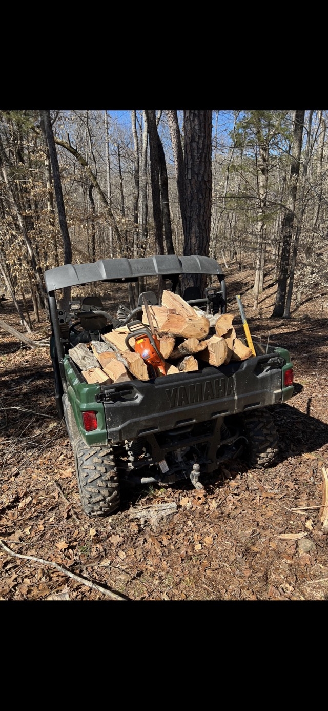

Had a Yamaha Viking and with the live rear axle it takes quite a bit to get it stuck in 2WD. the Long throw suspension seems to float over bumps and has plenty of power. It does have a locking diff and 4wd which can be handy when you find yourself doing questionable things. We live on fairly hilly property and it stays in 2wd most of the time even when it snows. I Load it up with firewood and haul brush as well. I do use the 4WD when climbing creek banks that are sandy soil. I added a HF 5000# winch which has come in handy a few times. My neighbor has a golf cart w ag tires in the rear and does quite well. It tows trailers etc that seem pretty heavy. Batteries aren’t cheap but the viking doesn’t exactly sip gas either. Company bought a pioneer and got it DOT prepped. the 1WD mode is neat but the heat in the cab is def something to deal with.

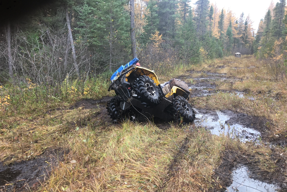

I had both ones for many years and I am not going to get in the who ride in the worse area with you but I bet I can hold my own. I used to share your opinion at first and it might be subjective but it is now my opinion that it is pretty much useless according to my experience. In my experience with it, it was useful in 1 or 2 instance out 10. Sometime you put it on and you think it will get out but it start climbing out on the left or right instead of straight where you actually want to go and it wants to flip you sideways or start climbing straight up... Much more control with limited slip... for pulling I don't think it pull more with the wheels locks it just spin more … like I said I had one for several years and it was rarely useful and longer we had that quad less we used it and at the end we never used it...
Like this? tell me how looking my front differential would've help even the left wheel doesn't touch the ground, might not look that deep but my exhaust was in the mud in the center and it wasn't like I was ''stuck'' I just couldn't get out regardless which side I was trying because it was too steep ... most time I get stuck that the issue it want to flip me over on one side or the other or even straight up vertical but at least I have more control.
