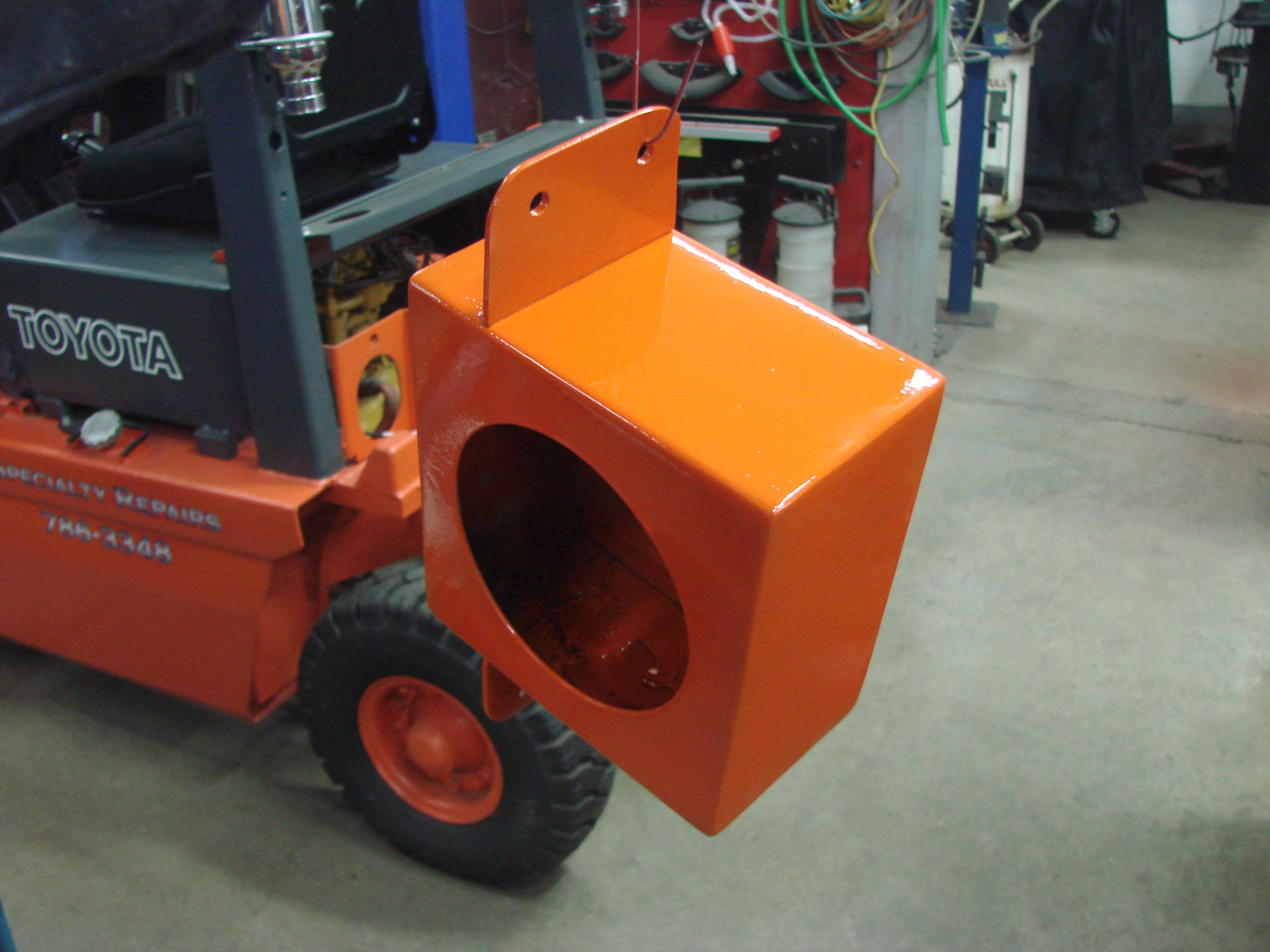

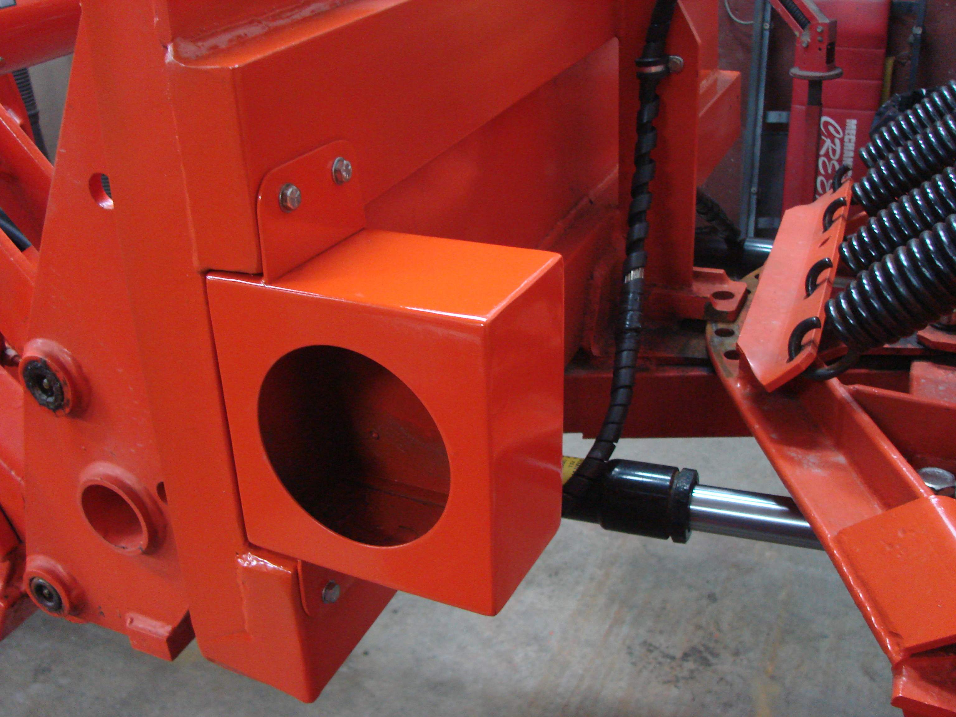

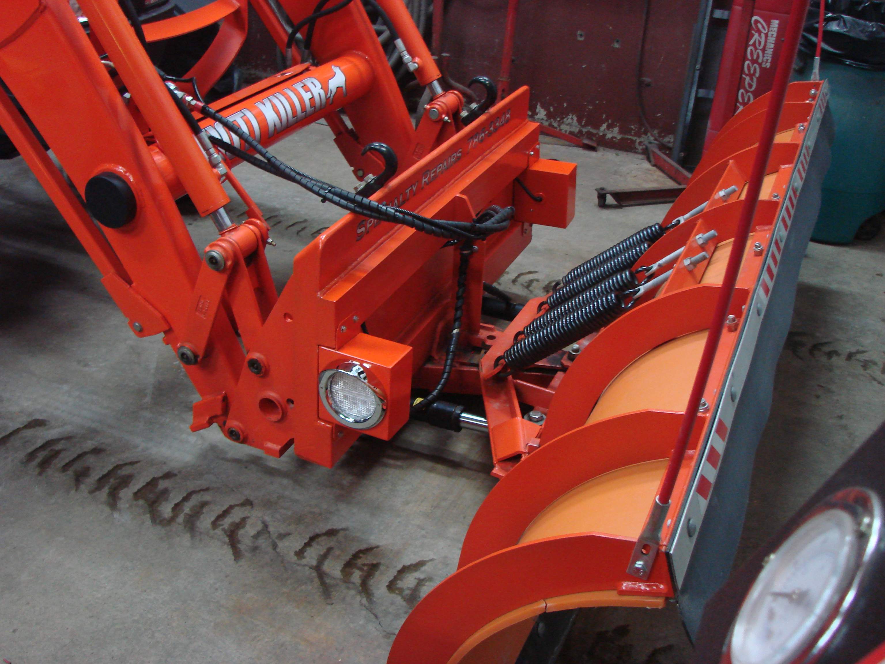

This winter I've been doing a few driveways along the main road close to where I live. In one situation I have to back into the driveway and use the snow blower. The problem I have doing this is that the guys driveway always has a tall snow bank out by the side of the road and when I back into his driveway my plow is partly out in the street and where the snow bank is so high I've had a few close calls with vehicles whipping by and just missed hitting my plow. The vehicles may have seen me and they might have been just driving fast but I don't like taking chances so I decided to install a LED strobe light up front of the fel seeing it's sort of a dark spot right now.
I made the boxes to fit the plow attachment I made last fall. I didn't want to mount them right on the plow because of the trip springs and although Grote said these lights are bullet proof I really didn't see a good way of putting them in that location so I went with the space I had available. The lights are part of the plow and not the FEL. I only needed the lights for the plowing operation of the tractor. I used the new Grate Super Nova LED strobe lights. These things aren't cheap. I paid $100. for each light not including the rubber gasket or the wiring pig tail but there worth every penny in my opinion. When I did the install I also put a pull connector at the quick release and one up by the FEL so if I need to disconnect it's still easy to do. Anyway I'll add a short video when it uploads but here's a few photo's to bore you all with of the project.

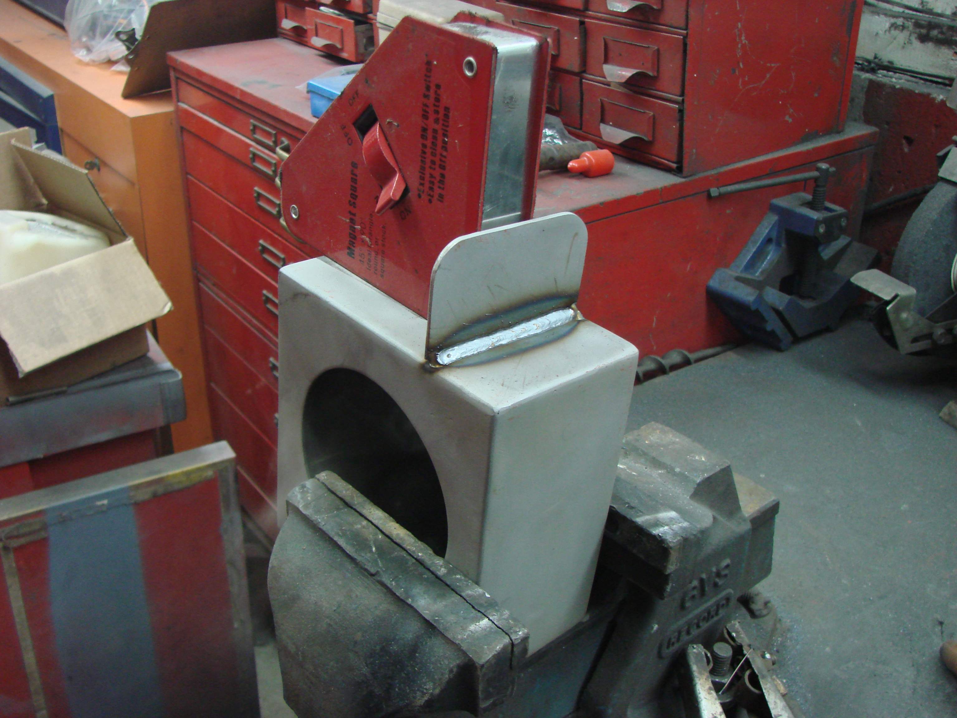

Nice weld in the first picture. Did you have to grind it or was this as welded.

No grinding on that weld. It's right from the gun. That was done with my Mig. If I wanted a really good looking weld I would have Tig welded it but it's good enought for what I needed.

May need to keep an eye on them as snow covering does not melt off.

In this case I only wanted the light to be on each side of the FEL in the front pointing straight from the left and right side so motorests would see me side on if they were coming up on me if I was backed into a driveway with my FEL pointing out towards the road. The top cab light is an actual double strobe light that can be seen at 360 degrees. Putting these lights on the front of the FEL gives me lighting all over the tractor.
