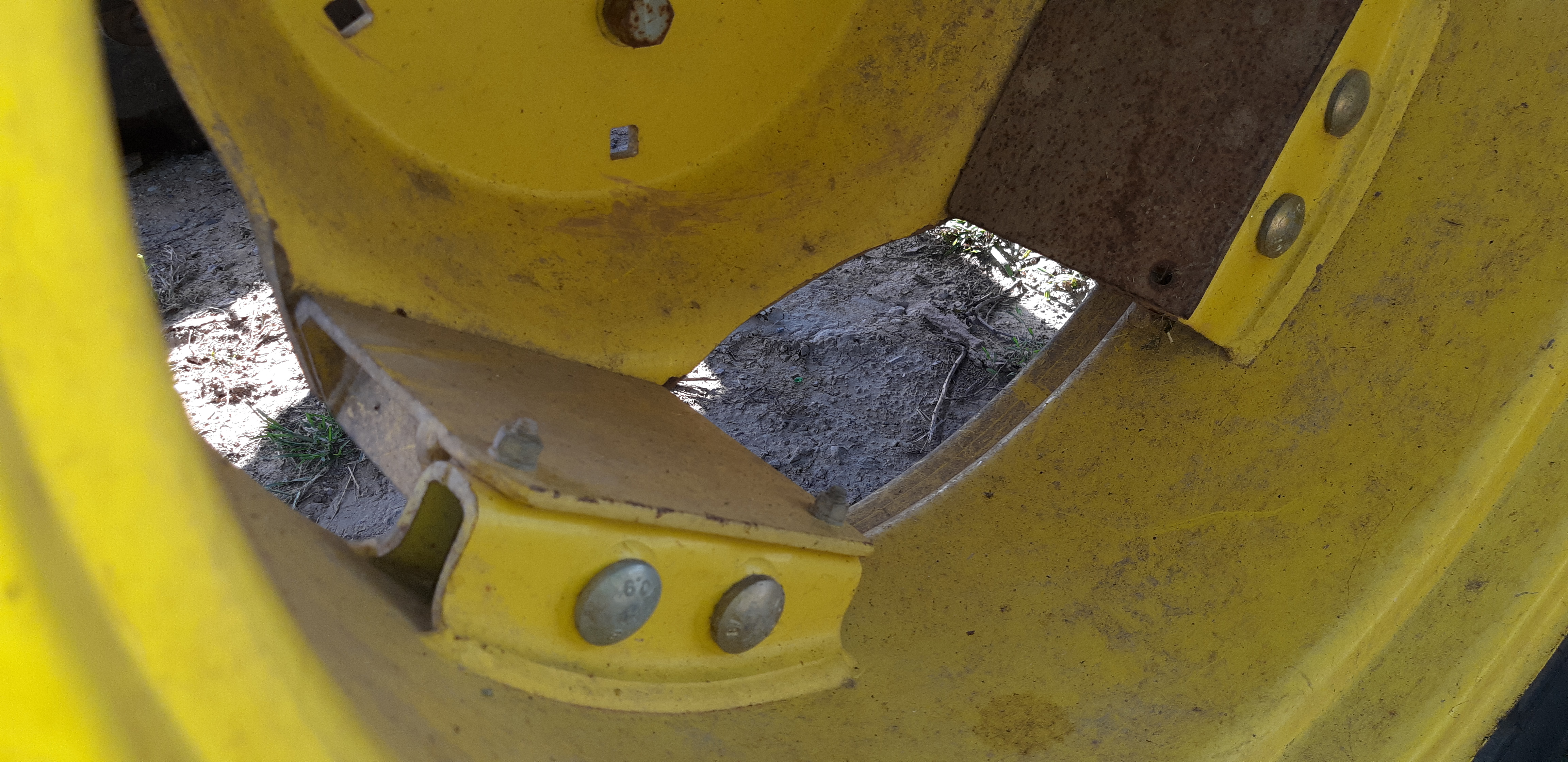

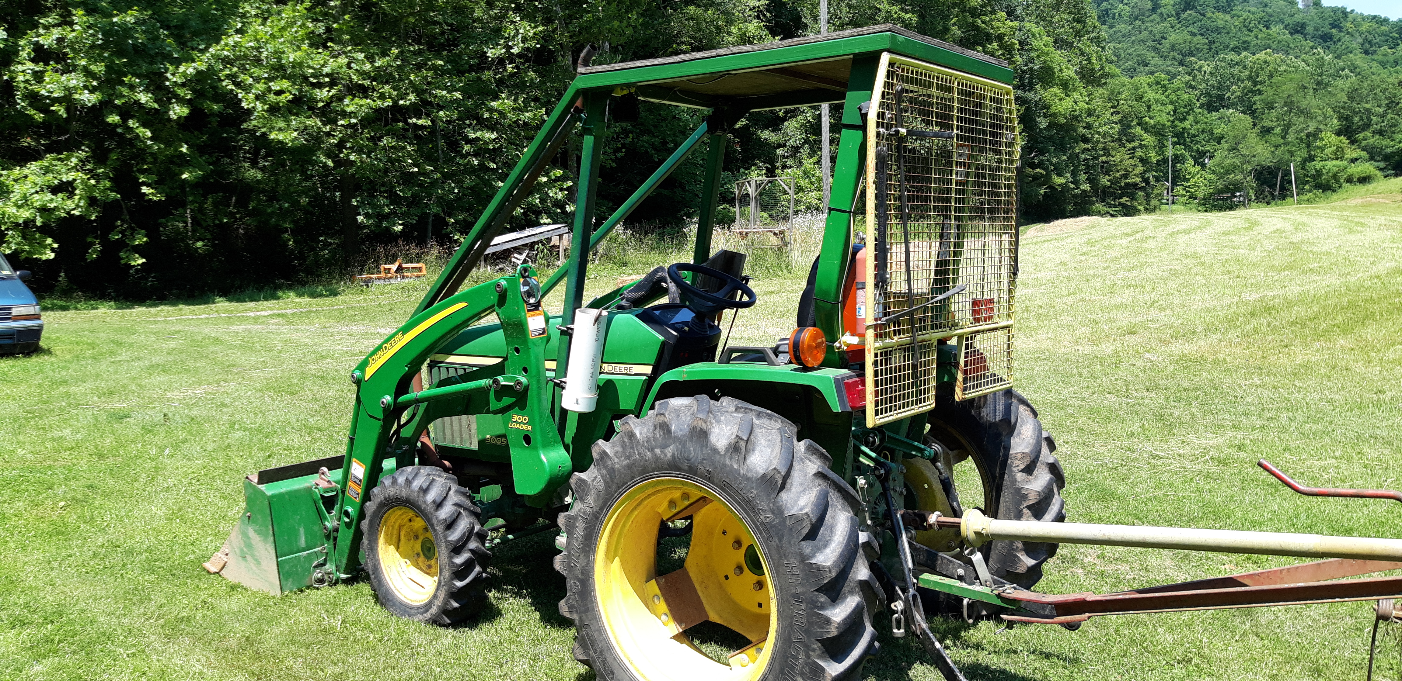

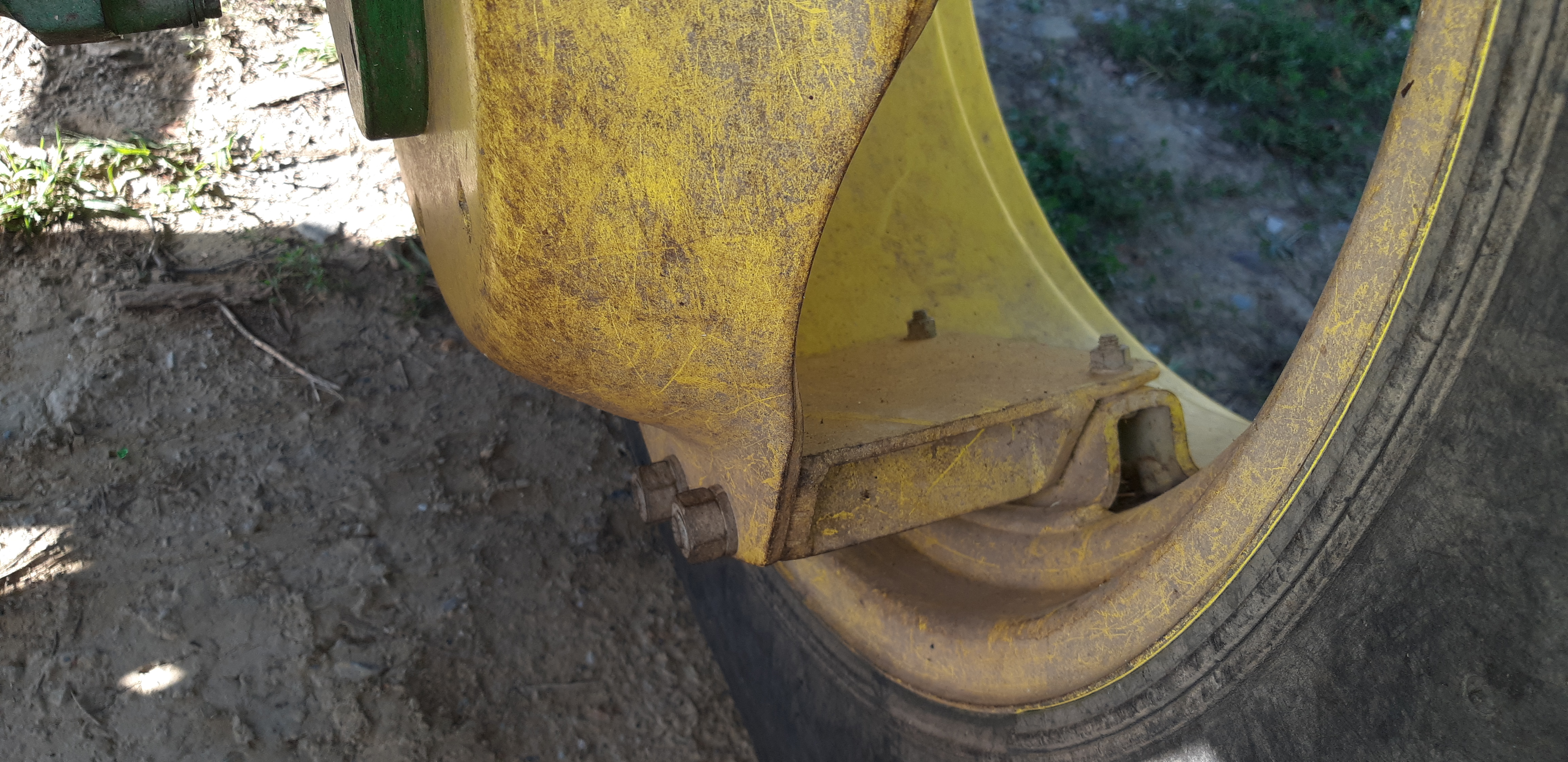

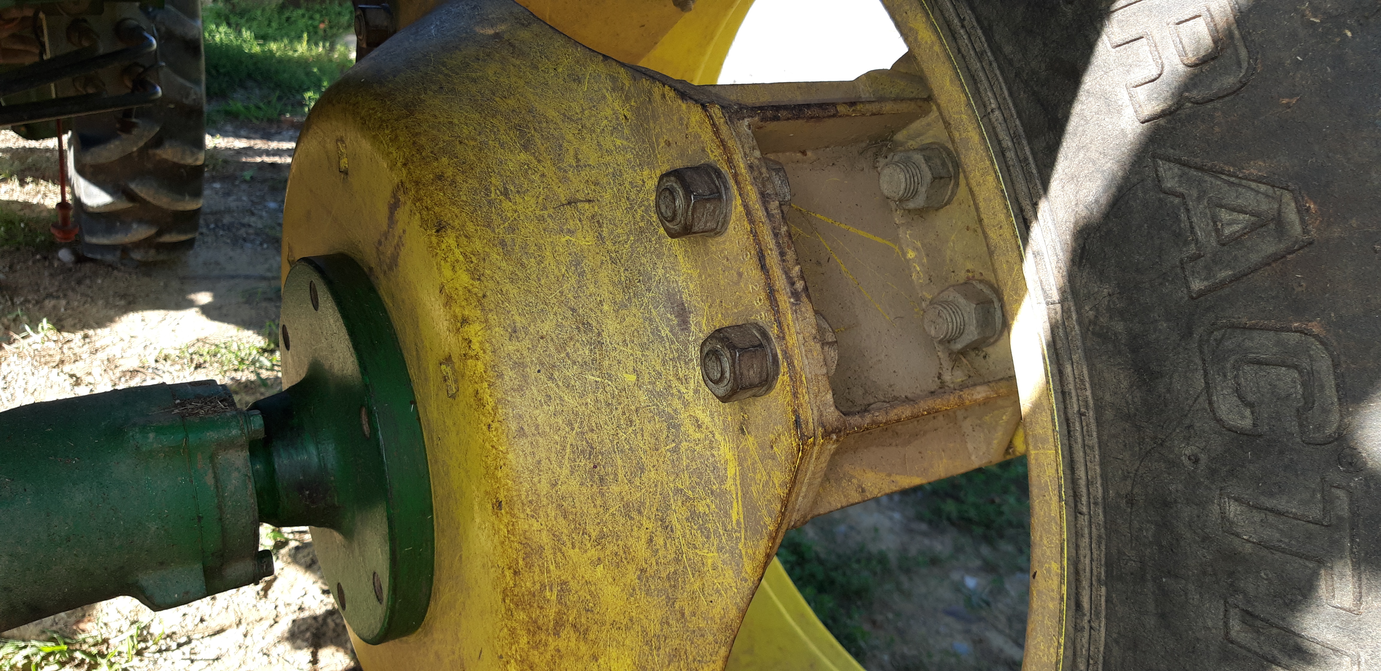

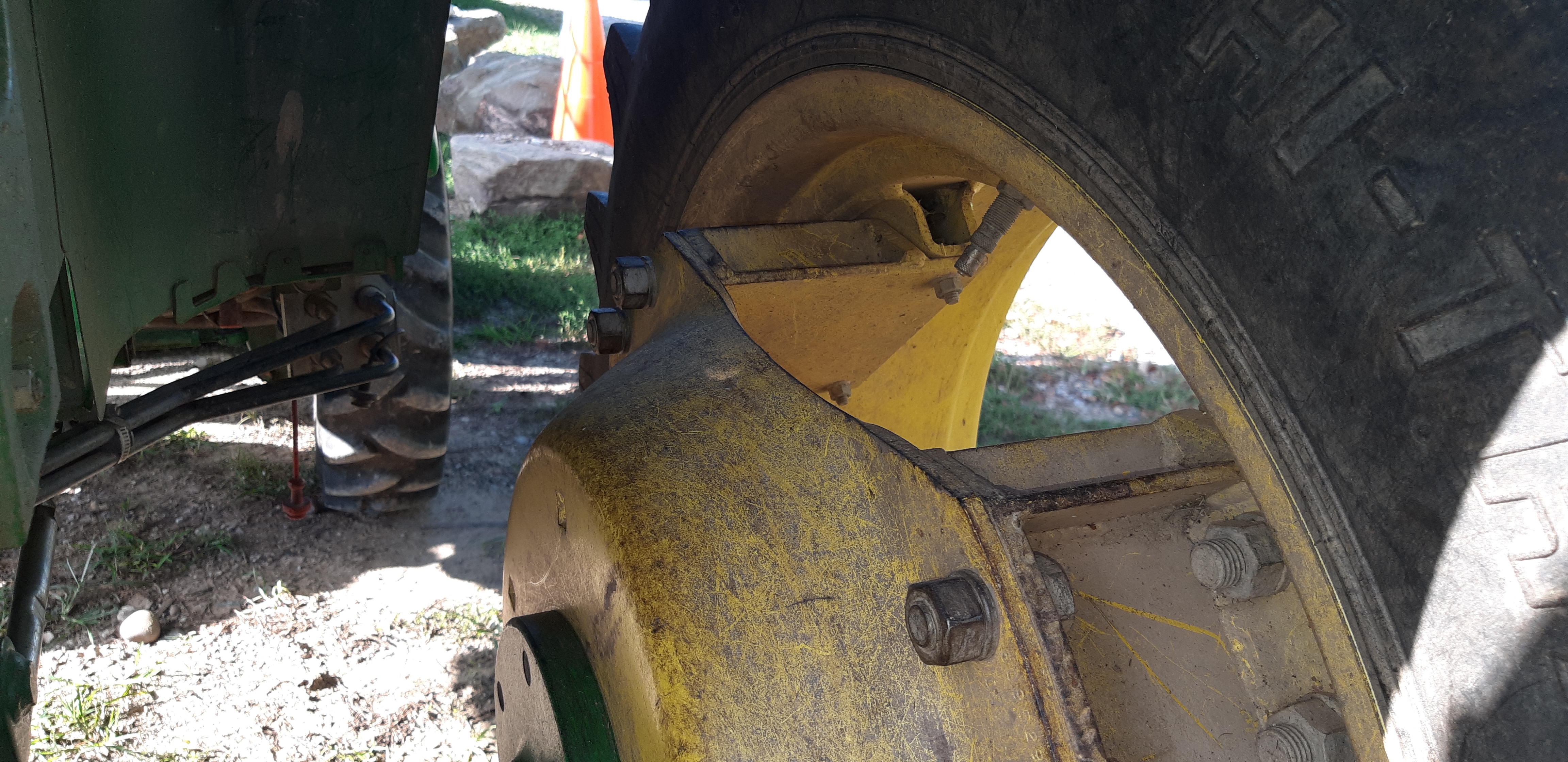

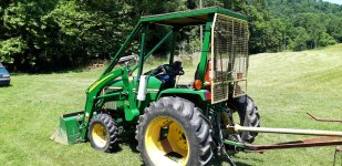

@Greg: Really interesting what you describe (not the redhead ;) ). Do you have any detailed photo's of what is looks or how it is built?
I hope the photos will help... a picture is worth a thousand words in any language!

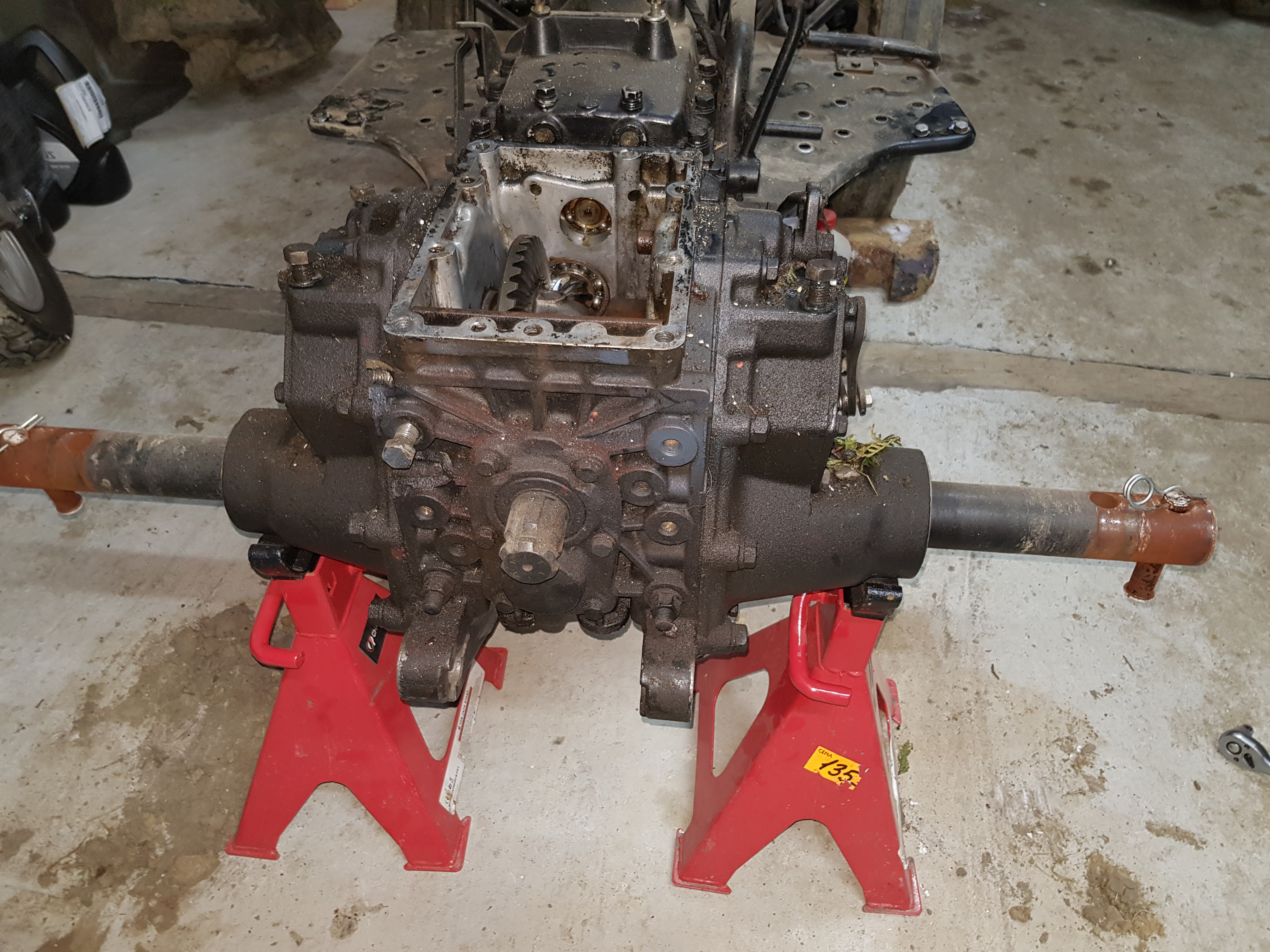

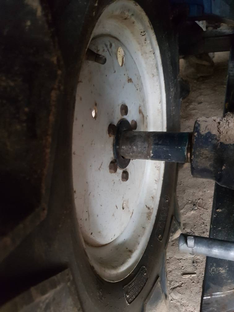

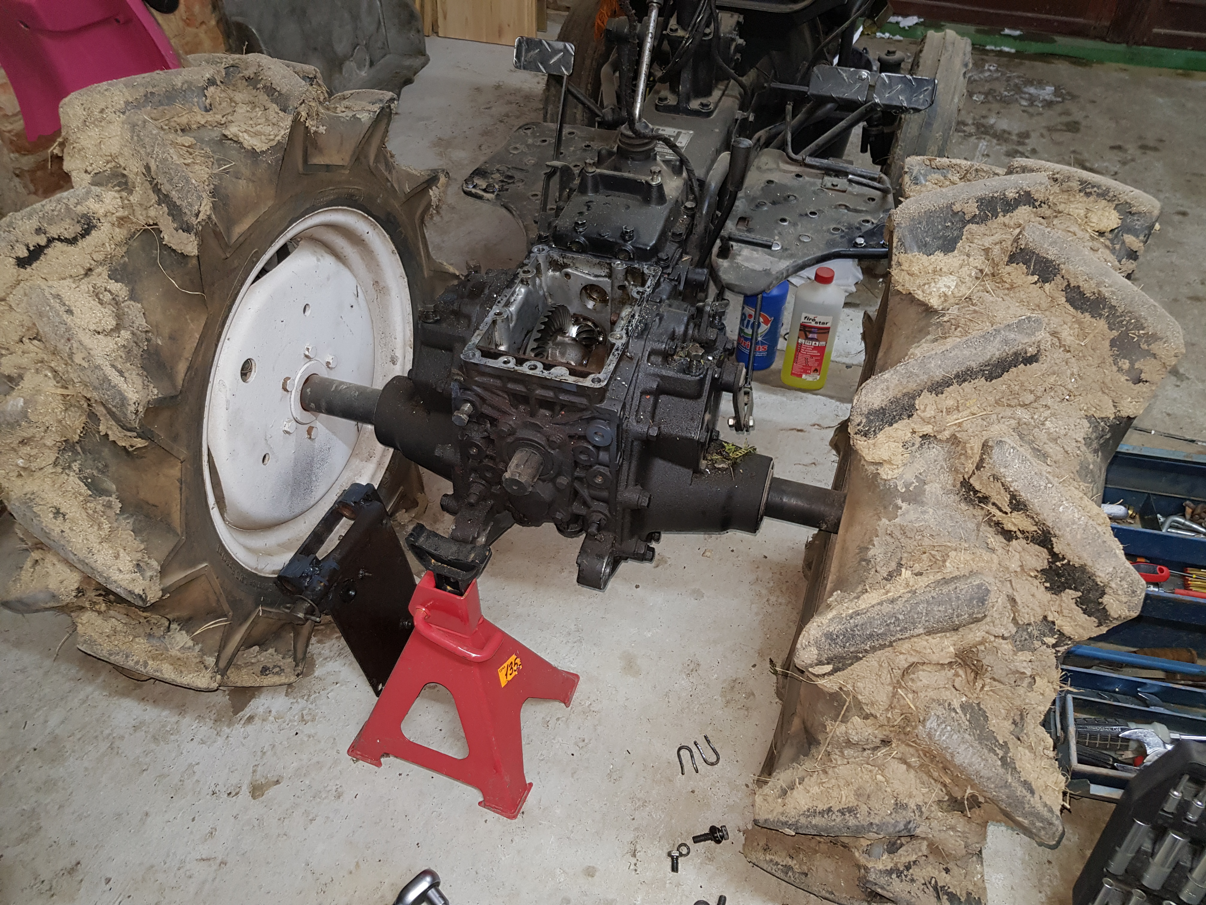

Ok i see what you mean... But my wheels have a different structure, cannot do that. But it got me thinking...
My wheel-axes are just sticking out of differential, and the wheel is shoved onto the end of this axis. So what i could look for is some big cylinder that i can put/shove onto these axes, and then stick some piece of steel (same thickness as the original axis) into the overlap part of this cylinder. I hope this makes sense.
This is what my wheels and axis looks like:
I will start looking for some steel next week. Thx!
   / sided my tractor: question about weight #13
Can you remove the 6 bolts on the hub by the axle, and add spacers there?

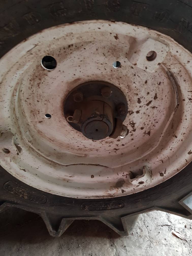

Hi d2cat, good observation, that could actually work. These bolts connect to a cylinder to go around the wheel axes, with a hole in them to secure position. I think I can move these cylinders from outside position to inside position?
   / sided my tractor: question about weight #17
Thx M. View attachment 620163View attachment 620164
Reverse the hub, as well as check the dish of the wheel... if the tires are swapped side to side to keep tread direction correct, you may gain some width that way as well, no fabrication needed.
