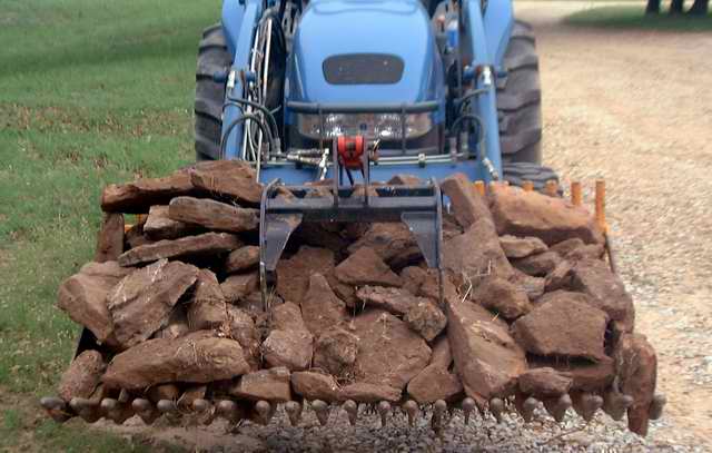

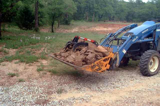

I was looking back at this thread and realized I hadn't shown any pictures of my rock bucket being used to collect and haul small rocks. I can use the bucket to dig and pick up rocks until it's about 2/3 full. Then to fill it up completely, I get off the tractor and hand-toss rocks until I get a full load. Here's an example of the average load of small rocks. Of course, I can only get two or three large rocks in the bucket and then I have to fill in with small ones by hand. It's hard work.

#119
Another angle...

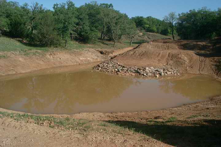

Woohoo! 5" of rain. /forums/images/graemlins/cool.gif /forums/images/graemlins/cool.gif /forums/images/graemlins/cool.gif
I'll have to wait awhile to add more rocks to my fish structure. After the last picture, I got about 6 more loads hauled. I wanted another 10 loads, but I'll have to wait until the next dry spell (hopefully never). /forums/images/graemlins/grin.gif When the water goes down a little, I'll put the rock face on the first terrace. I've got plenty of flat rock for that job.
