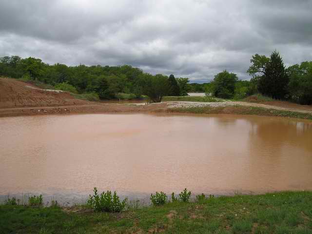

Now I can plant some grass too. I've suddenly got plenty of water to keep the grass seed wet until it germinates. I don't think I'll be able to lower this level much. /forums/images/graemlins/smile.gif
If you look far into the background of this photo, you can see our lake too. It's within 2' of the overflow, up about 6' from it's previous level.
Did I mention that my garden got watered pretty well too? /forums/images/graemlins/wink.gif
OOPS! Wrong photo. /forums/images/graemlins/crazy.gif

We are supposed to have a little more rain this week. I could easily handle another 2" rain. The pond can come up two more feet before overflow and my second pond where this one overflows is still down over 3'. Here is a photo of my spillway. It doesn't seem to wash out much, perhaps because it is native soil. I do want to get some grass here, but any seed would be washed away. I may end up putting down some rock. Decisions, decisions... /forums/images/graemlins/smirk.gif
