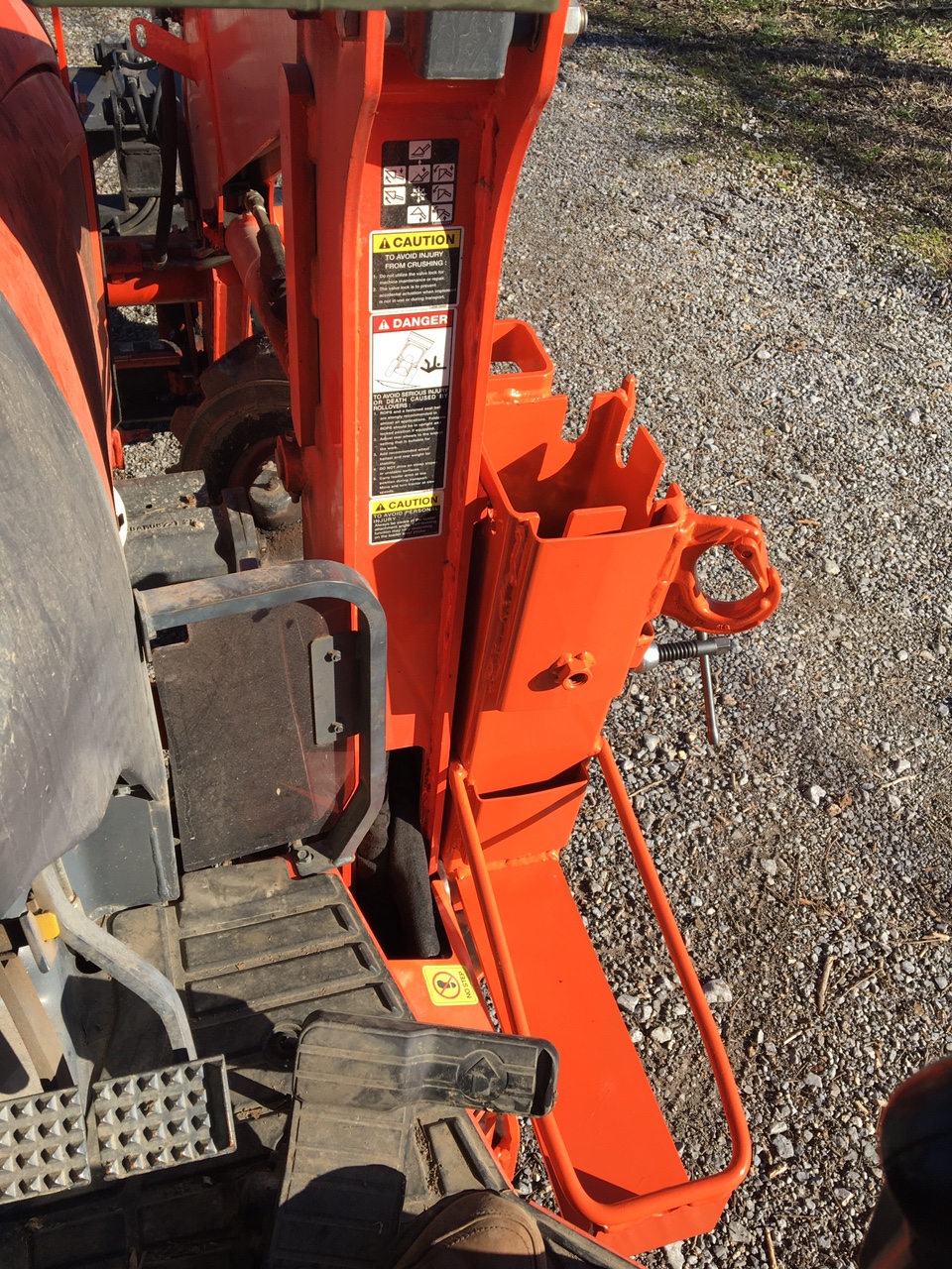

Beowulf: What did you use to attach the 6" PVC pipe to your loader upright?
   / Simple chain carrier
#14

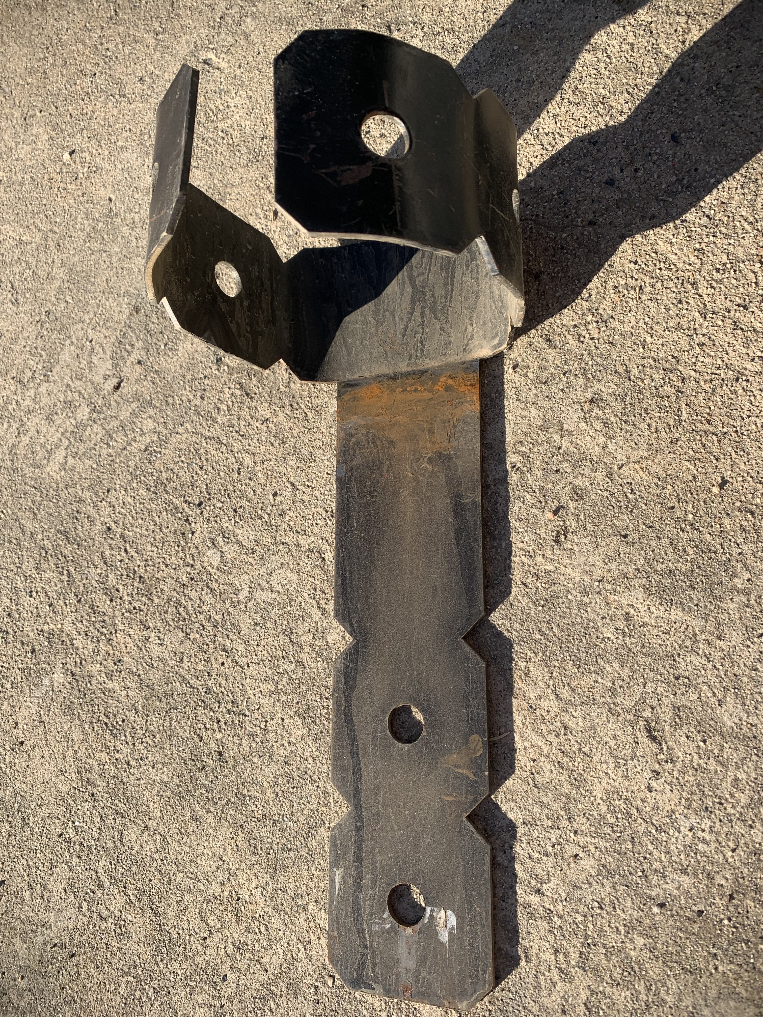

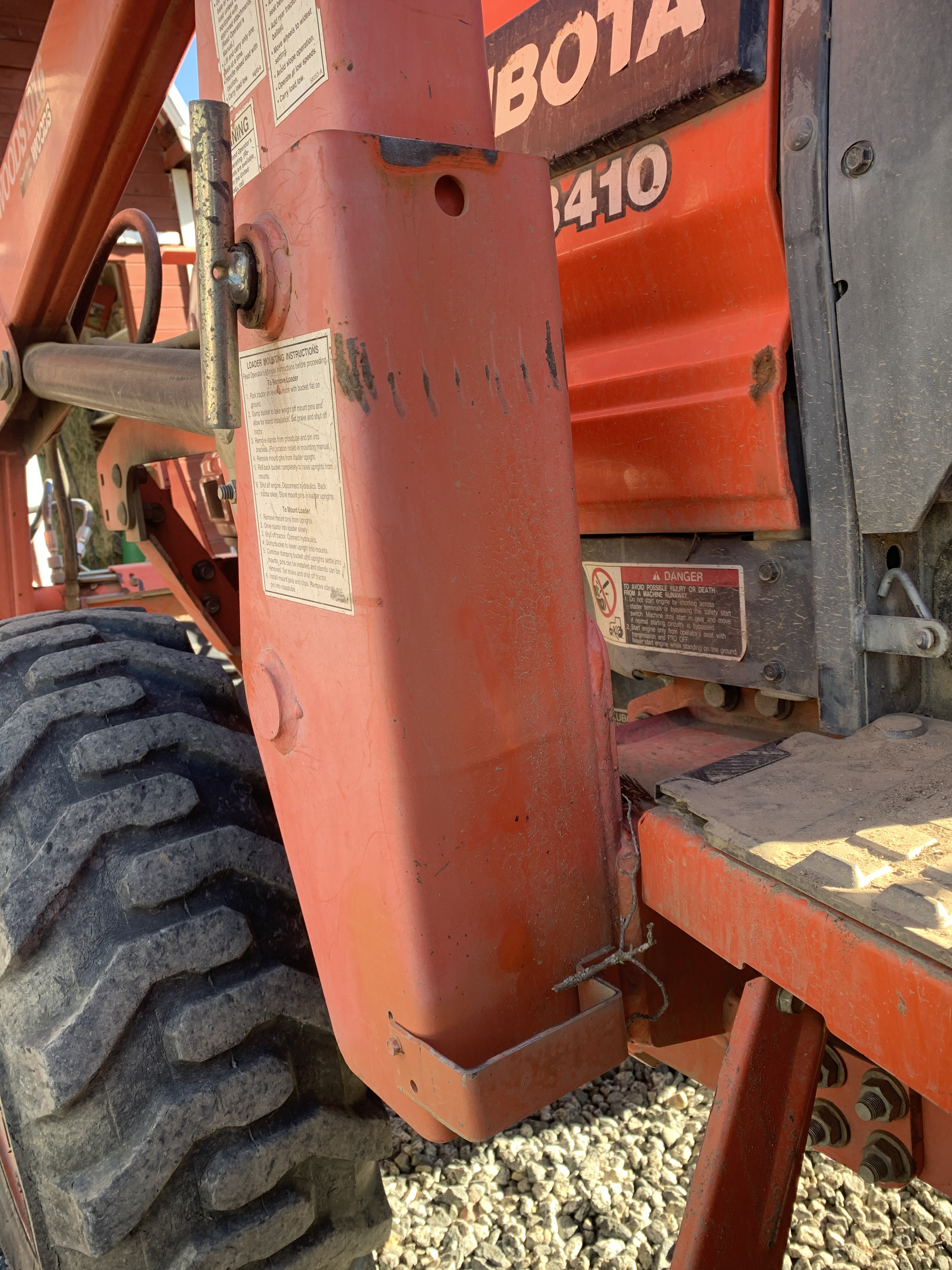

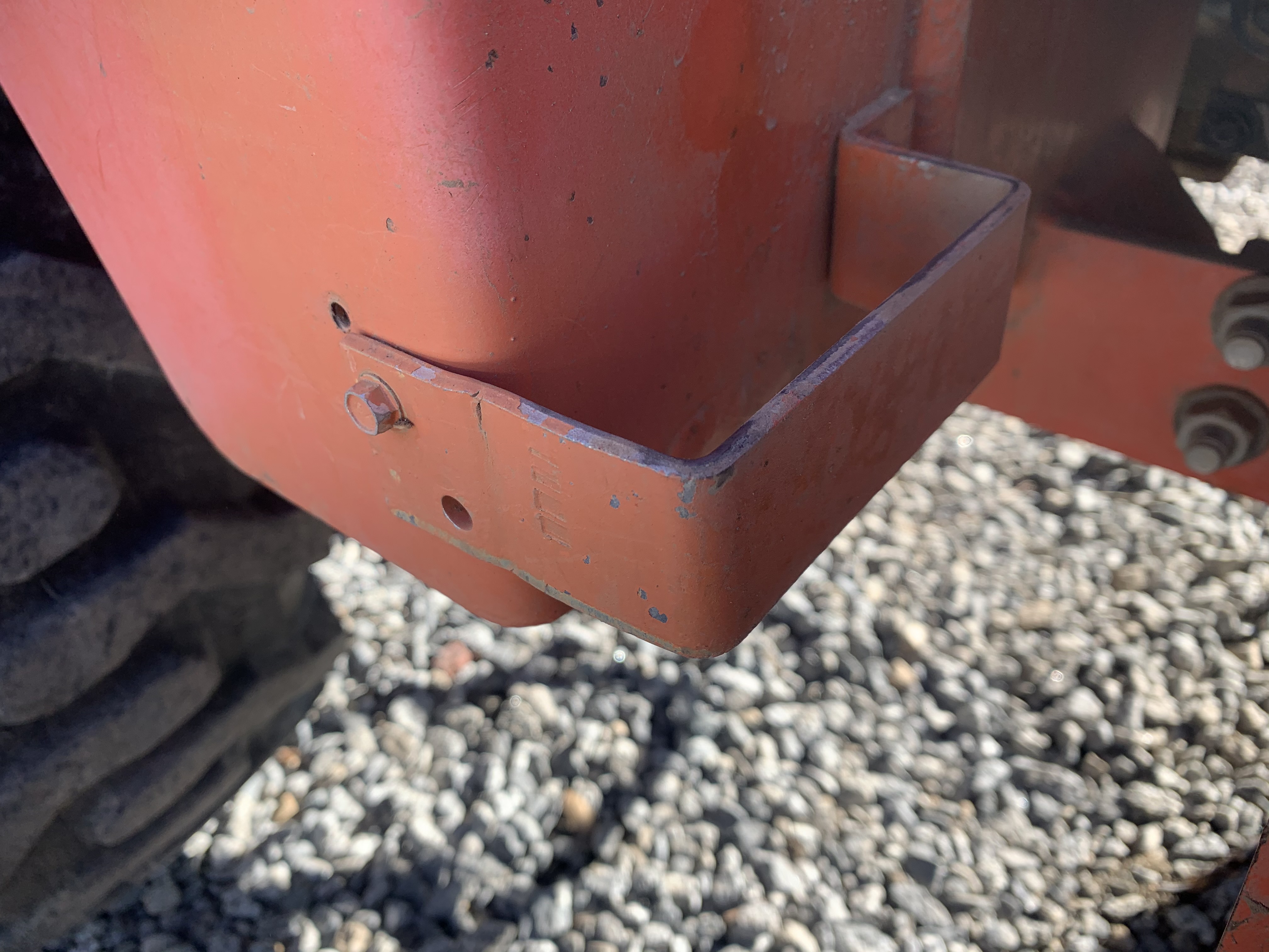

Actually, it was what I had here already. I will try to attach the Home Depot links to the items I used - or to similar items. To hold the top of the ABS pipe against the loader upright I used an ornamental black T bracket, the horizontal T part was shaped around the ABS pipe. The vertical part of the T slipped nicely into the gap in the loader upright. For the bottom support I used a 2x4 stake holder (or something similar) bent/shaped in a vice to fit my needs and attached it with some self tapping screws into drilled holes. Simple but works fine and lifts off as necessary.
https://www.homedepot.com/p/OWT-Orn...ERCH=REC-_-searchViewed-_-NA-_-206842595-_-N&
https://www.homedepot.com/p/Everbilt-2-in-x-4-in-Zinc-Plated-Stake-Holder-31230/205386640
Some pics of the holder pieces separately below. Earlier photo shows it installed on the tractor.
