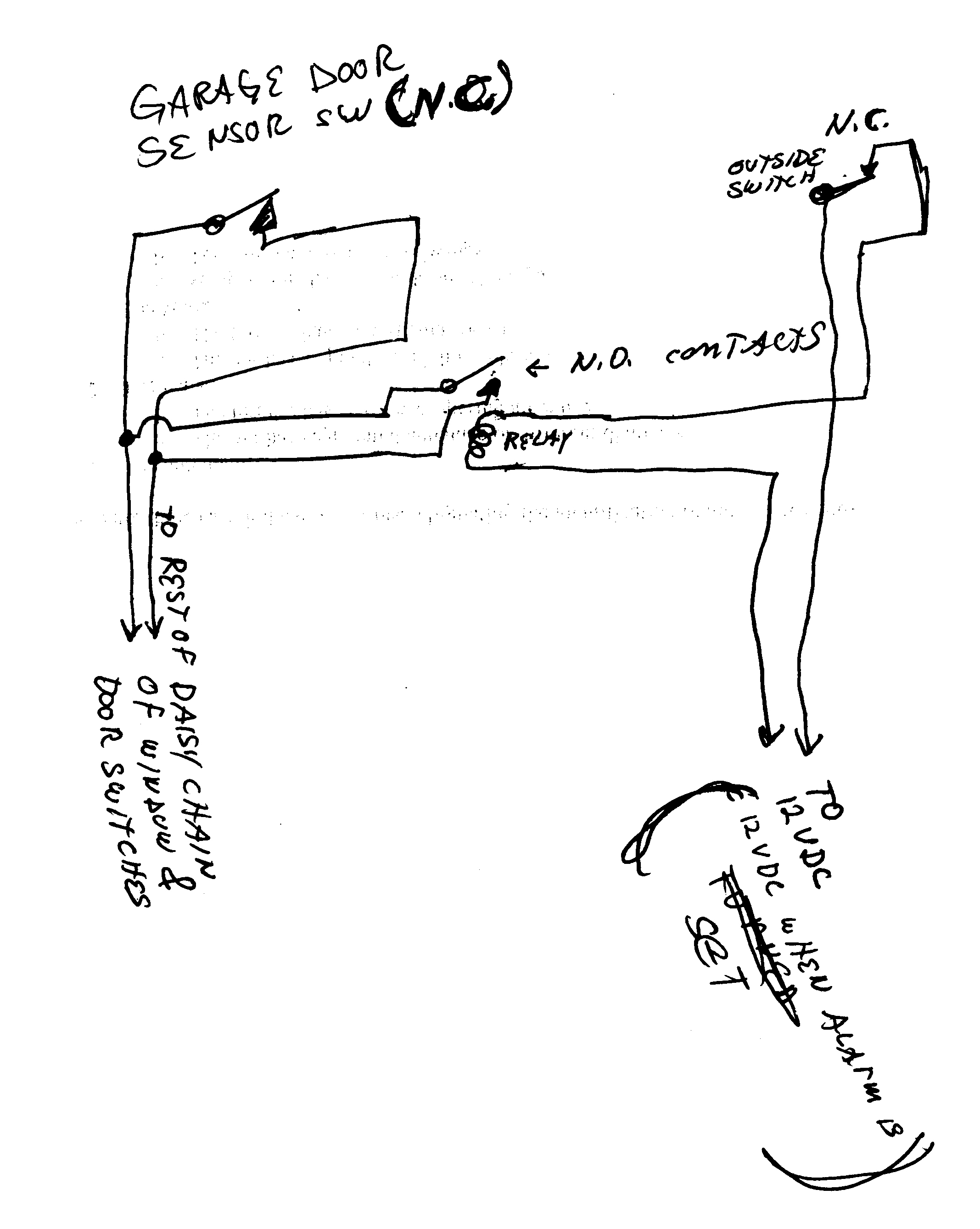

yah, when you have time, do me a schematic, please. both for the pushbutton garage door interrupter, and the inside delay switch; i bet i could use a single pole light switch, complete with box/plate cover, etc., and put it inside the door just slightly apart from my light switches; would only be found by accident if you dint know...that 'hide it in plain sight' has come in handy for me over the years....

Rebb, I tried to delete this message but couldn't. I need to mod the drawing. I may not get back to this for a few days but I will do it for you.
Pat

As regards alarm stuff. Wire your garage door(s) with sensors (switches) just like everything else. That will be compatible with any mods I provide.
