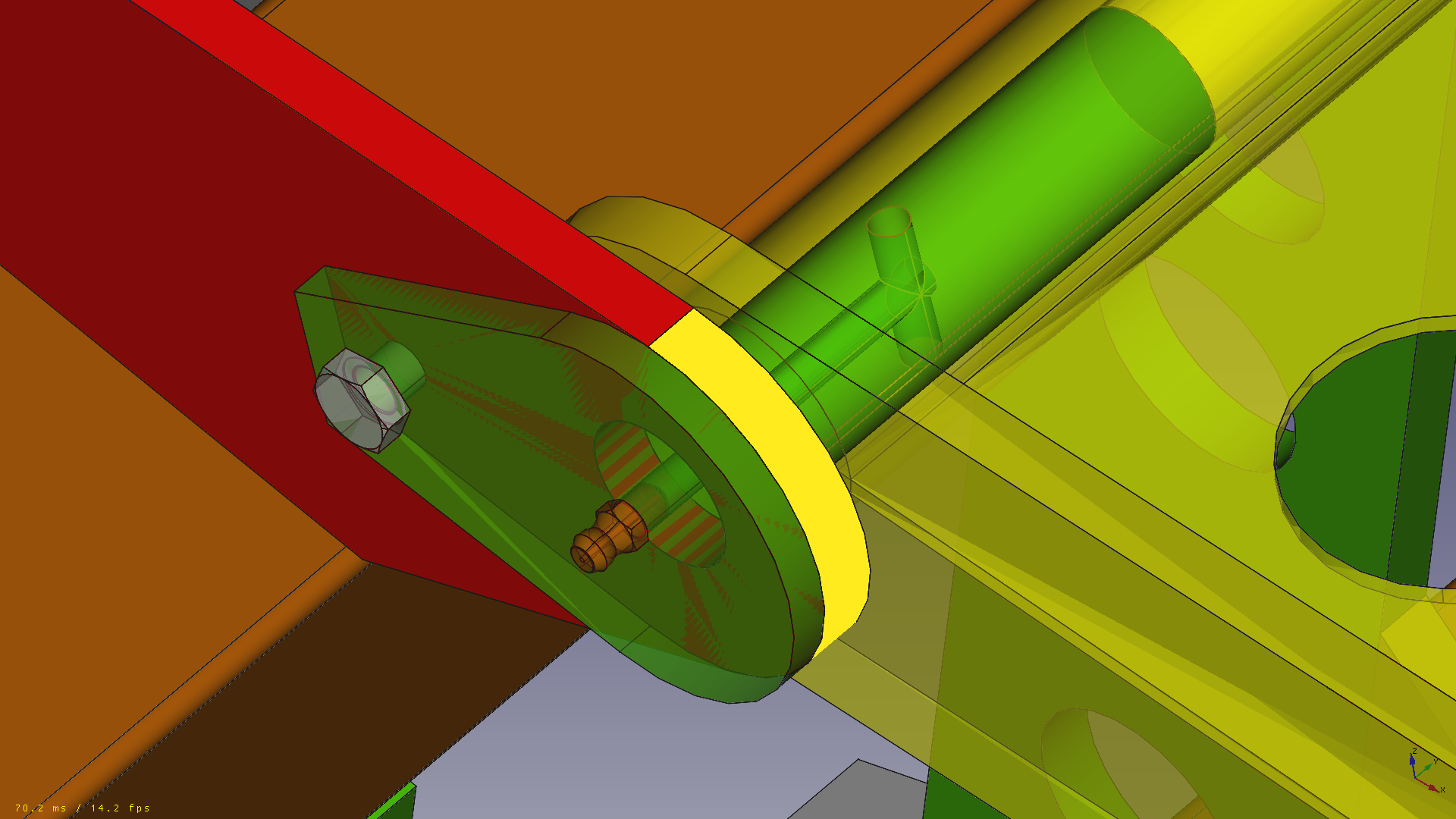

The first thing a non-greaseable pin will do is rust, jam, or gall in the hole preventing disassembly without large amounts of jacks, chains, big hammers, torches, mashed thumbs and swearing. Ask me how I know. Do not rely on any lubrication method that requires disassembly of parts to add lubrication. If anything, lube parts while in place to aid in disassembly when needed.
I don't know the metric numbers off the top of my head, but for 1/4-28 zerks, you drill in from the end 7/32, then tap 1/4-28 (fine thread). Drill crosswise through the diameter to intersect inside the mechanism, can be any size from 1/8 to 1/4". Be careful of the bit catching and breaking when it intersects the other hole. If the pin is mild steel, it is very easy to do.
Ok hear you! :) I will do it, cheap insurance :)

GLyford thats for you! :drink:

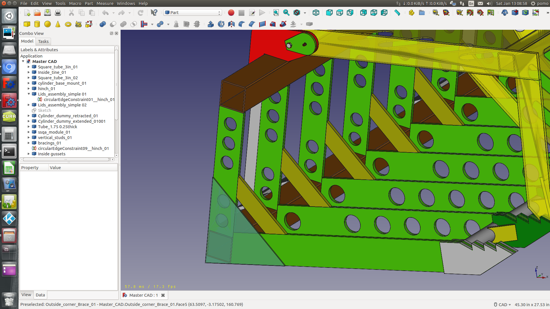

So I finished the BOM you can see them here
Whoever wants the 3dmodel can download it from here
BUT..... the grapple will weight 448lbs without the cylinders. Isn't that tooooo heavy, that will restrict me from lifting 16ft green oak logs? max diameter around 16in. My tractor has lifting capacity 1800lbs at the pivot
I am so close to start fabricating and I have all kinds of second thoughts, like
a) The square tubing (the 2 brown ones) are 3" x 1/8" . Isn't too thin?
b) Mostly everything is designed out of 3/8" , should I downgrade to 5/16"? it will save my around 50lbs
c) If not what about downgrade to 5/16" and choose higher grade steel?
d) Or maybe 63" its just to wide of a grapple for me?
e) Anywhere else I could save weight? MAybe do just the lids from thinner material? But that will just make the steel order more complicated and I will have lots of leftovers.

This is why a lot of people simply buy one...someone else has already made about six of these and learned all the lessons. Like using a higher strength steel which is more expensive, so that the end product can be lighter. When we start out thinking "it is just steel, how hard can it be...?" we very often do not see the decades of learning that went into getting something into its final form.
The smaller the machine, the more the weight counts. Believe it or not, 70 lbs made a big difference on one of my machines.
