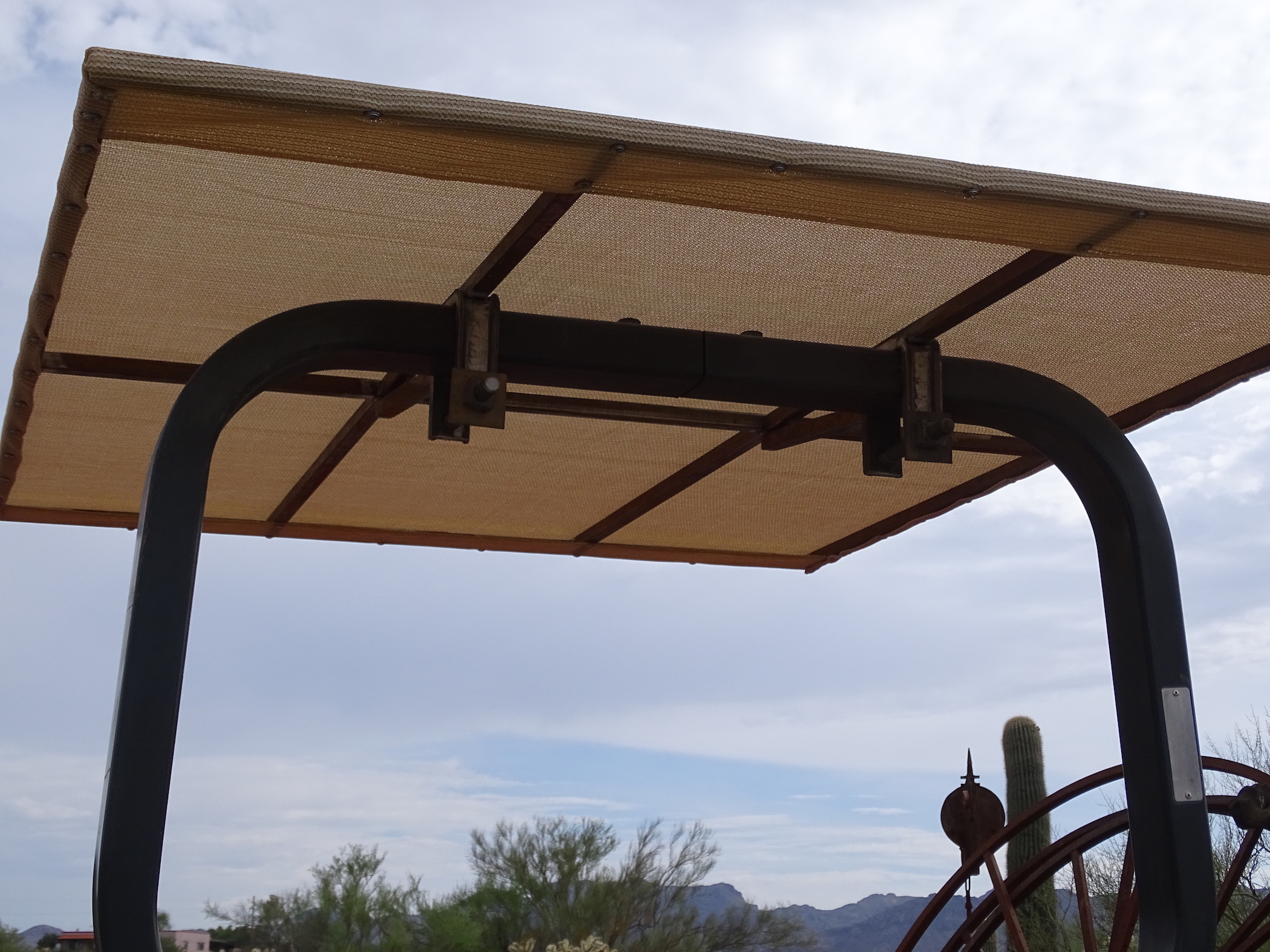

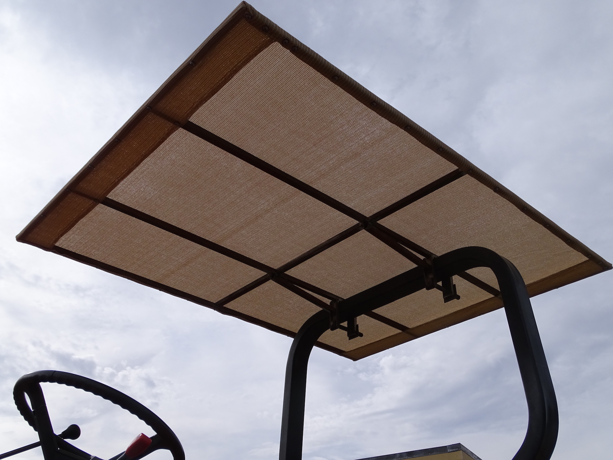

I made this canopy from 3/4 inch square tubing and a pair of heavy brackets. I covered the frame with 90% shade cloth using tek screws and steel and rubber washers. It measures 60 x 48 inches and provides nice cover from the sun. I live in the desert, so protection from snow and rain isn't much of an issue...
The materials cost about $50 and it took six hours to build with help from my wife to stretch and attach the cloth.
It attaches with just two bolts and weighs less than 20 pounds, so it's easy to get on and off.

True. I made this because of sound issues and clearance. Units I'd seen on the net add about 12 inches in height. That would have kept me from parking in one of my structures. This unit only adds 1.25 inches and the sound isn't a factor.
I know some people hate the "DIY" look of such things, but I like creating my own solutions and I had all the materials on hand.

I got the mounting brackets from a steel recycler along with a bunch of bolts and other hardware from power poles. The bracket would be easy to make with a piece of heavy "C" channel, however.
The canopy is working out great; it doesn't rattle and it doesn't reflect back sound from the engine. The sun here is brutal almost all year long, so shade is really important. The only drawback is that the screech owls that live in my shop sit on the canopy at night and eat and poop. Kinda makes a mess of my tractor...
