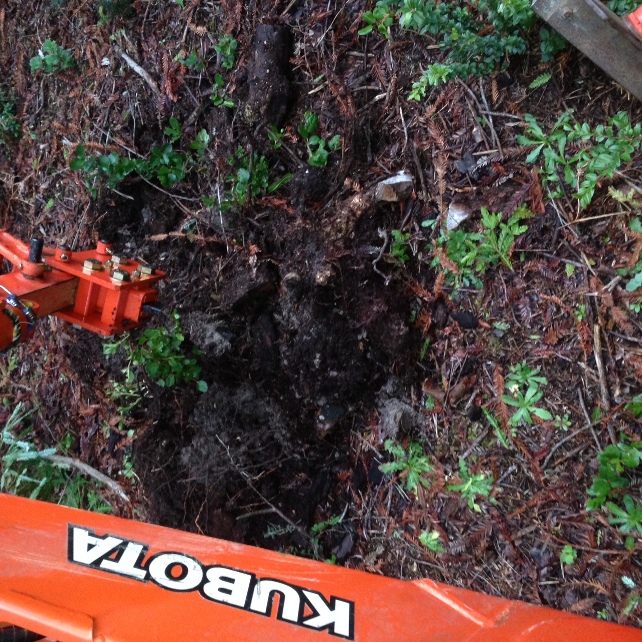

Photo 6 - demolished this small stump in seconds with minimal soil disturbance.

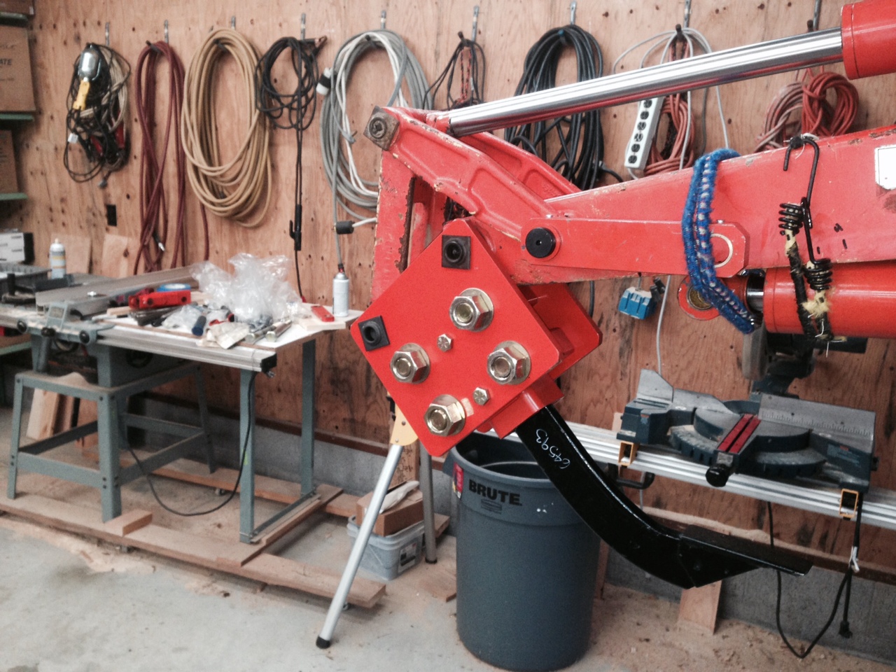

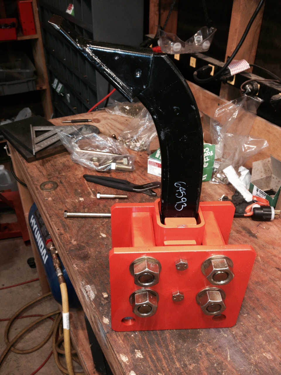

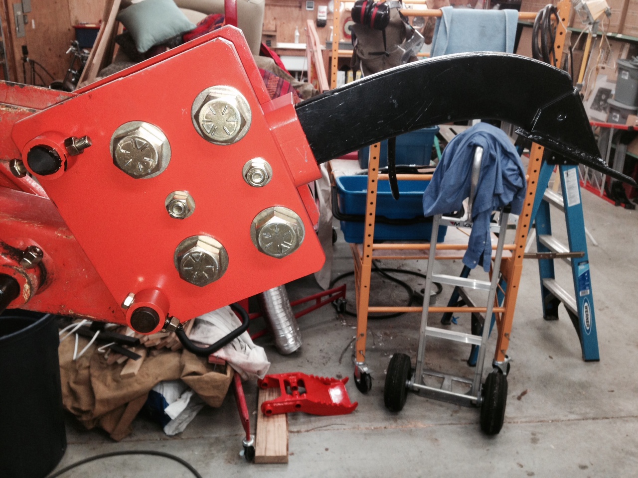

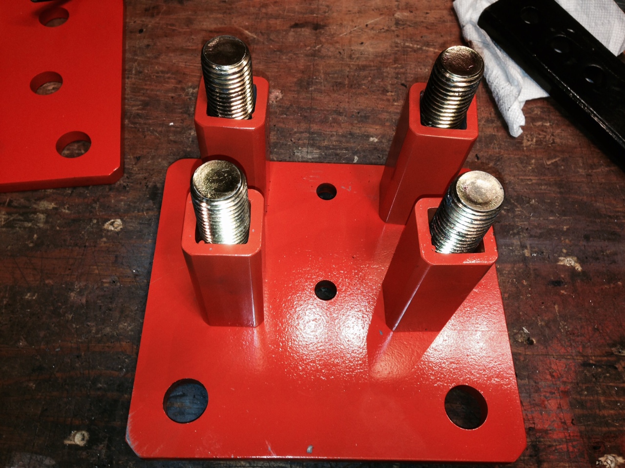

This is what I got from Bro-Tek. Haven't tried it yet.
The second photo is with the trenching attachment.

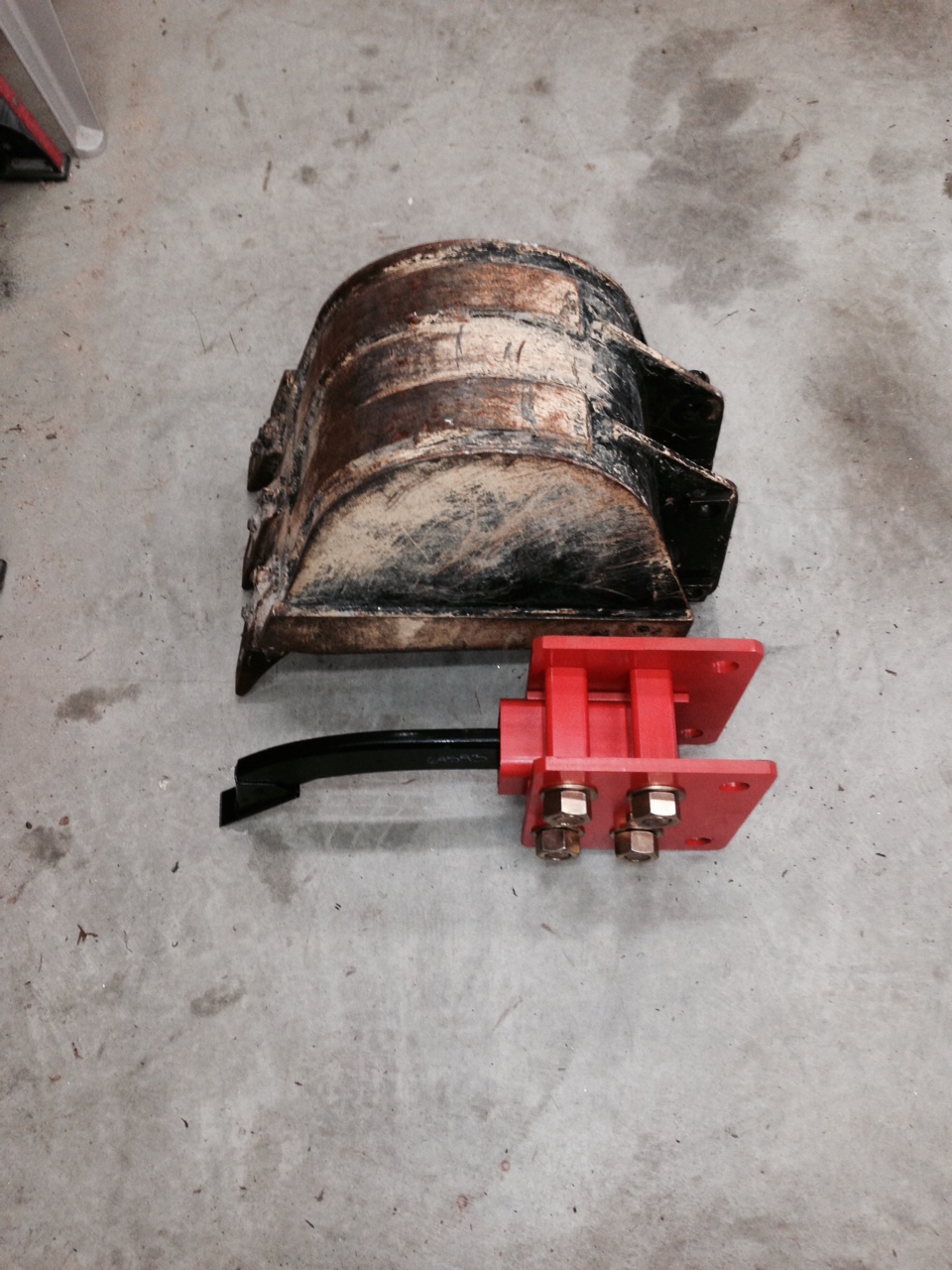

Actually, it is a Canadian company from the East Coast, and both pieces together cost me about $430 plus tax. Look it up online, and you can order it.
