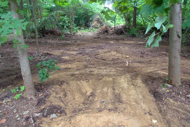

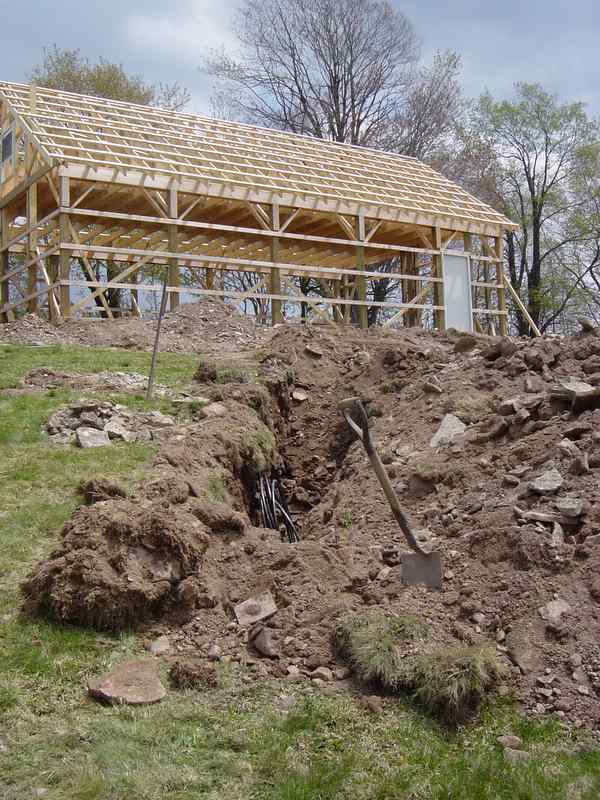

If I hadn't seen him sign "Randy from Long Island" I would have guessed Long Island from looking at the soil in the hole. Some people call that soil sand!
Not knocking the XL at all, but I am curious if it could do the same in clay/rock.

I was refering to the picture attached to post #714200. I was actually quite impressed with what it accomplished. Parts of LI are quite sandy, I was wondering how it would do in clay/rock.

goneandbrokeit - Thanks for the reference. And thanks for the picture. I can't tell the width of the trench, but the soil composition and the rocks don't look like they would be a problem for my backhoe. I took a couple pictures of some smaller trenching I've done. I've done some other work, but didn't have the camera handy. There are a couple of of photos of the backhoe subframe and the controls, in case anyone is interested:
