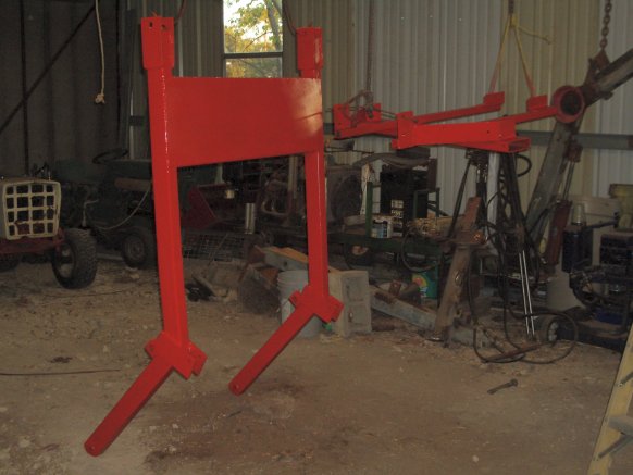

   / Simplicity Loader
#12

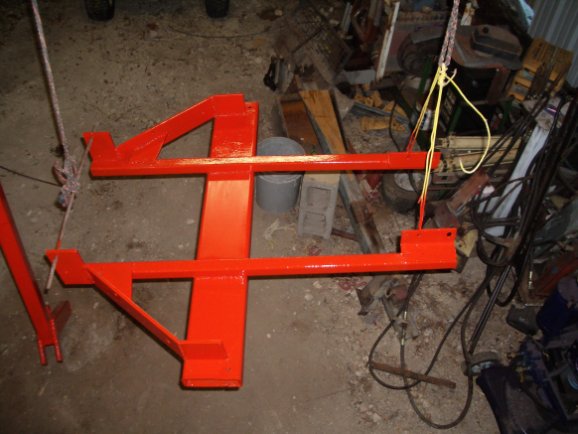

I finished up the brackets and supports, then I disassembiled. I had a few welds to run and grinding before I could prep for paint. Here's the results of arms and subframe.
J.I.Case orange will have to work as it was on hand.

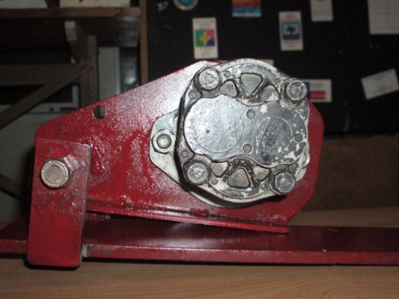

   / Simplicity Loader
#13
I've been working on the pump mount and it was fun getting a 3 1/4" hole in the 1/4" plate when I only had a 3" hole saw. I used a wore down grinding wheel and round file to enlarge the hole till the pump would just clear. It only took an hour.
I also got a little more paint on parts. Next will be boreing the post for 3/4" supply line and comlpeteing adjustable pump mount.
Not to bad for 11 days and working a full time job.

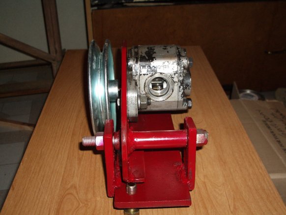

   / Simplicity Loader
#15
Got most of the pump built today and it has my take of Dancos tensioner. I put the final coat of paint on posts and brackets and if dry enought tomorrow I'll start reinstalling.

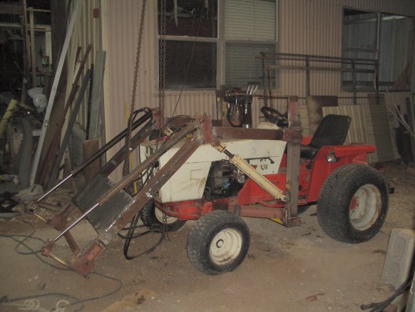

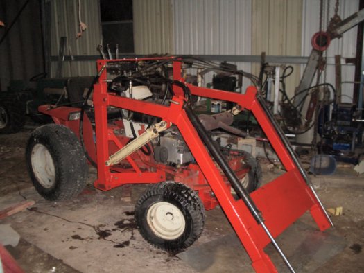

   / Simplicity Loader
#17
Got the pump mount finished up and installed and the loader back on tractor with a lot of the hoses ran. I'm working with the hoses I have on hand for now.

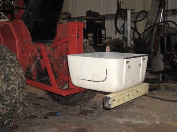

I put it to work today moving dirt and found out I needed a weight box to help keep the back tires from spinning.
I took a piece of 2" sq. tube, a 24" 3x2 solid bar for bumper and an old mc travel trunck loaded with scrap steel sealed with a 80lb sack of quickcrete, This slides into the receiver hitch. there is some room left on top of the concrete that extra weight can be added.
Pic's tomorrow.

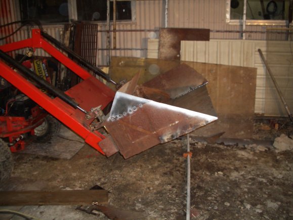

   / Simplicity Loader
#20
Here's a pic of the weight box and one of the the side and top plate on my reshaping of my old bucket. Still only money spent was hydraulic fittings.
