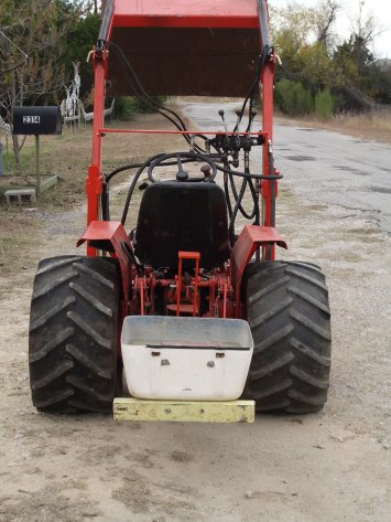

Worked some more on the bucket and spent an hour removing 6 lug bolts so I could layout the holes for my wheel adapters to mount 31-15.5x15 ag bar tires that are on 10 bolt wheels.I'm not sure if these lug bolts have ever been off or oiled. I loaded the tires and wheels in company van so i can cut out centers tomorrow as I'm out of gas for my torch.
I'll probly weld in the adapters tomorrow evening and then take pic's.

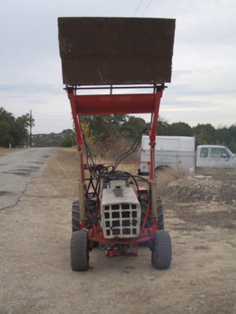

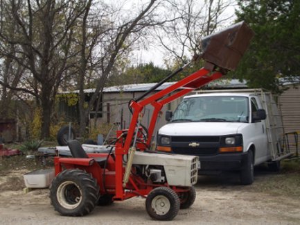

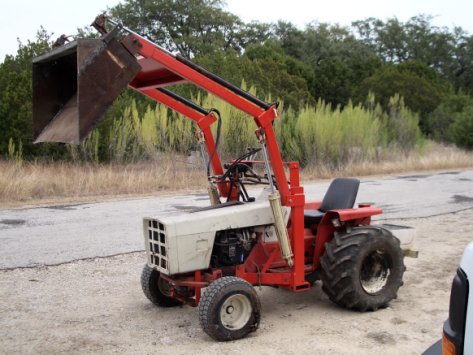

I've got the wheels and tires on now and have provided for your entertainment a few pic's as it is today.
