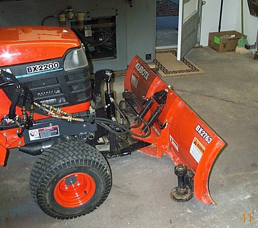

blade on the tractor

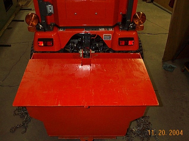

Here is pic's of lid on the wieght box. the lid is made of 1/4" ply wood and has a notch cut in front center so ply wood will side under the top link and to hold it from siding out I screwed a piece of dowel to the under side of the ply wood so it drops in the 1" square hole on the front edge of the wieght box and painted with Chevy engine orange

Thanks for the pics Larry. You have a really sweet setup there.

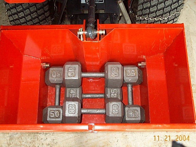

Junkman I use hex dumbells stacked in the weight box, they interlock together nice and tight in the bottom of the box. No I didn't buy them for weight, I use too lift in my prime. See photo
