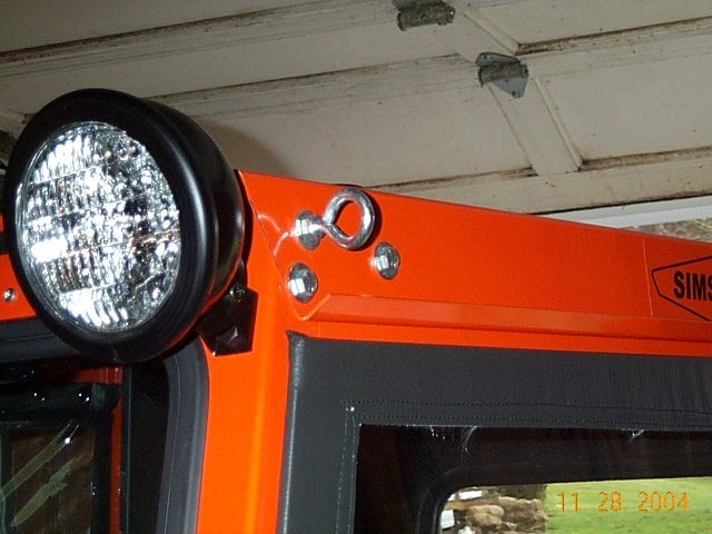

Thanks for the info. Looking at your pictures I noticed eye bolts on each corner of the cab. Is this how you pull it off? I was looking at Harbor Freight web site, they have an electric 800 pound rated hoist with remote control for $75. I was thinking I could use it to pull off the cab each spring and reinstall each fall. How do you store the unit when not using it?

Yes I use the eye bolts to lift it off in the spring with my engine crane and I made a wooden dolly that I sit it on and roll it out of the way. The switch box I made and you can buy different sizes at your local electronics store. I will take a pic of the electric hookup from under the dash

Thanks again! Can you take a picture of the dolly and eye hooks also? I placed an order for the Sims cab today! Adding the front snowblower and cab, will be ready for snow in a few weeks. /forums/images/graemlins/grin.gif /forums/images/graemlins/grin.gif /forums/images/graemlins/grin.gif

Tom here is a pic of the eye hooks that are on each corner of the Sim's cab. you will see how to do it when you get your cab
Good luck, I am vary happy with mine.

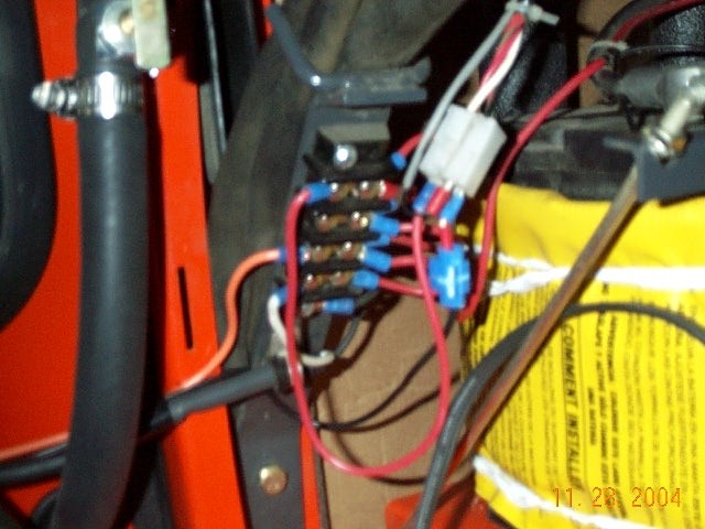

The second pic is how I hooked up 12V power to the cab with terminal block
