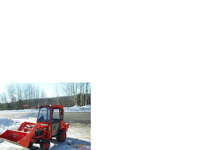

I purchased the Sims cab w/ glass rear window, standard equipment, no other options, 1495.00 plus 50.00 to get it across the boarder. Curtis Cab 1595.00 plus 295.00 for glass rear window, saved 345.00. Went together very easy and there was no drilling holes like with the Curtis. Used it the rain and wind yesterday and it stayed 54 F. inside cab, windshield wiper worked great. Over all I am vary pleased.

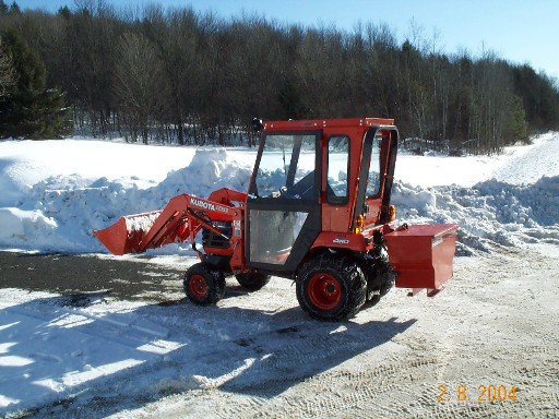

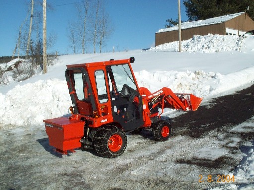

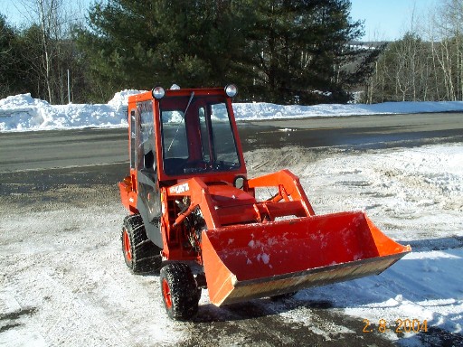

Here are 4 more pic of sims cab.Will take some close ups of fuel fill and hydraulics over the week end and post. To answer some of the other questions.It took 6-8 hours to installand that was taking my time and cleaning all the parts first. I don't see why it cann't be removed because it is bolted on by removing the Grab handles which leave 2 10mm studs on each side of fenders and you use the bolt at the front edge of the tractor floor board on each side and 2 "Z" straps that hook around the ROPS. I am going to use 2, 2" straps around the roof panel and host it up off of the tractor. "I hope" It weights about 170 lbs. or that was what was maked on the boxes (110lbs. & 60lbs.) If you goto www.simscab.com and look up Kubota-Sub-Compact Tractor-Standard Cab part # 52BX22000201A you can read all the standard features. I bought from my dealer for 1495.00 w/ no shipping cost (65.00) but he did charge me the 50.00 brooker fee to get across the Canden boarder. All the glass windows are tinted safety glass. Visablity in all directions was very good when I was removing my snow banks Sunday at the bottom of my driveway. So far I am very pleased with it. I ordered the HD alternator and will get some filter with the money I saved not buying the Curtis cab. Thanks every one for all your input.
