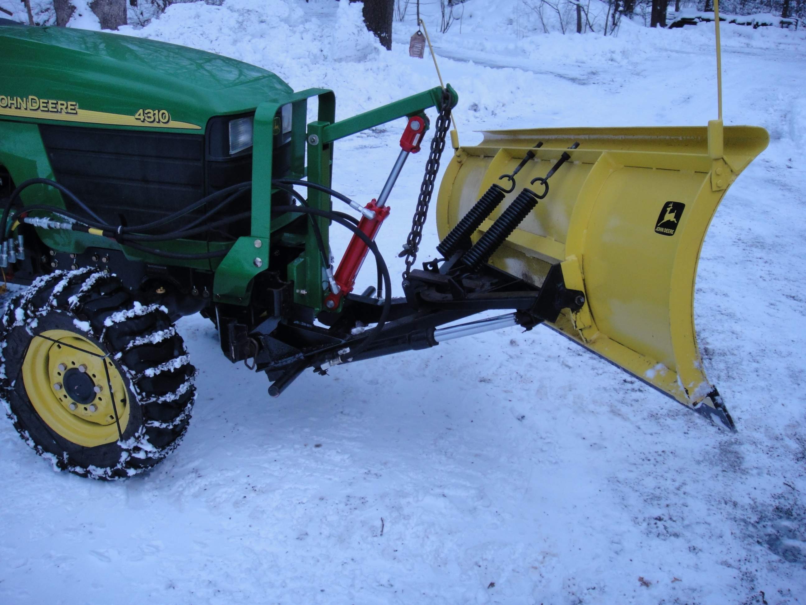

That's what I do, works great.
Someone in another thread mentioned that it's better than just one DA cylinder, because the plow is better suported, backed by cylinders on each side ??
JB
