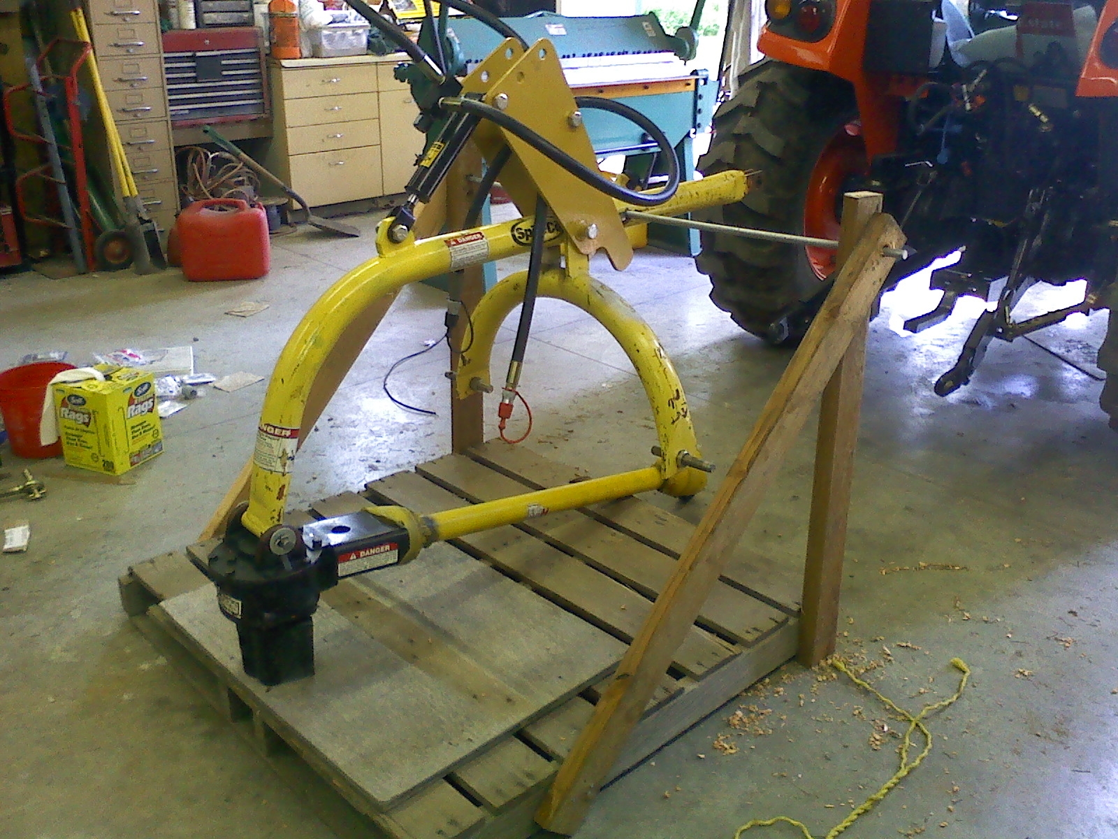

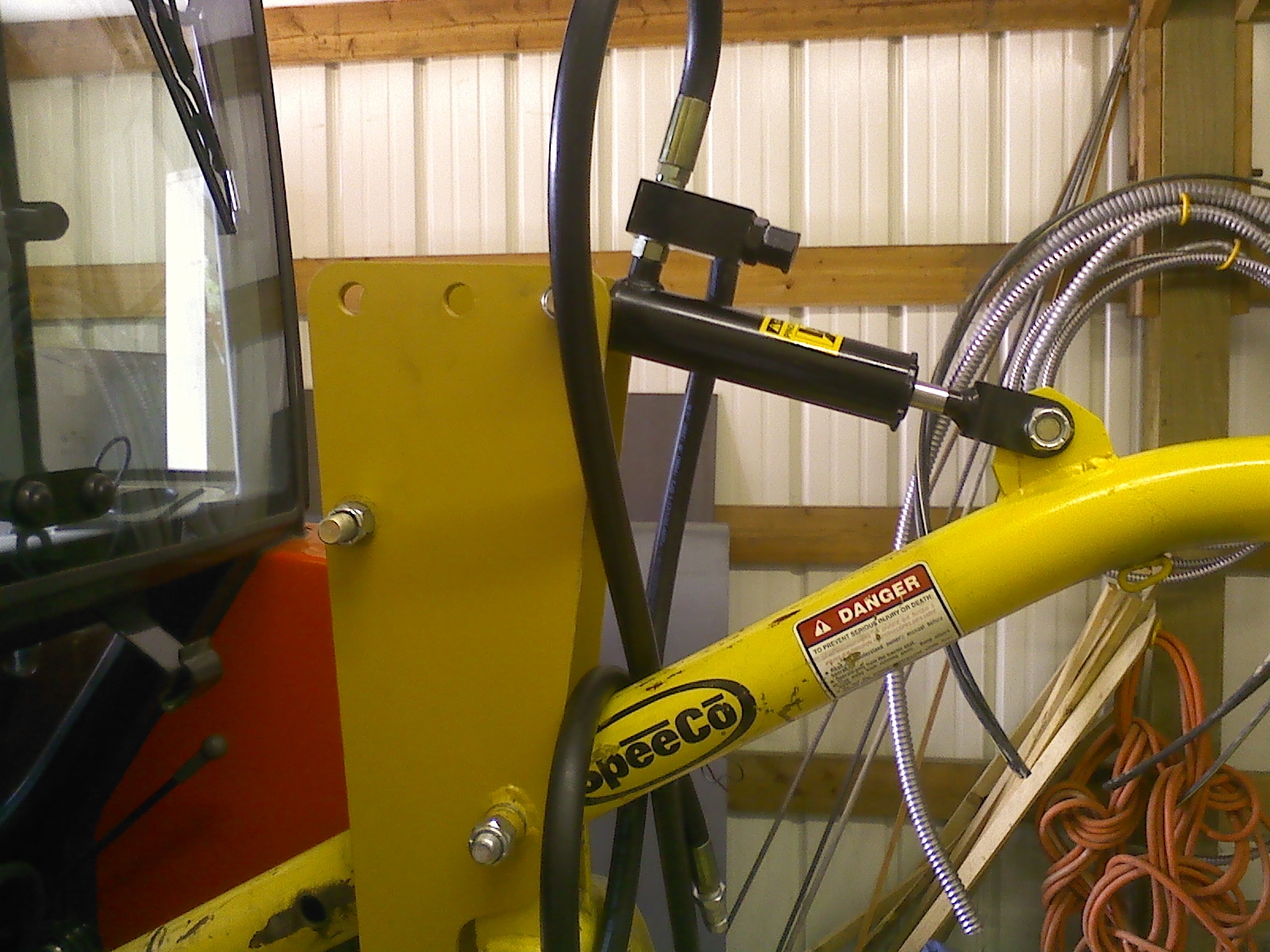

On single cylinder hydraulics, there should always be a hose run back to the tractor fill port. I was told not to just leave 1 hose unhooked. What Kioti did was have me add a connector to the hydraulic fill port on my tractor, than the second drain line went there. It still uses only 1 of the standard rear remotes. In my case it was power down rear post hole digger and float when PHD was raised. This port is the same thing they add if i was to install a backhoe.

Most single action cylinders will only have one hose. The other end of the cylinder is normally just vented to atmosphere.

the cylinder itself has 1 hose, but theres a diverter box before the cylinder with 3 connection points. (on mine)
