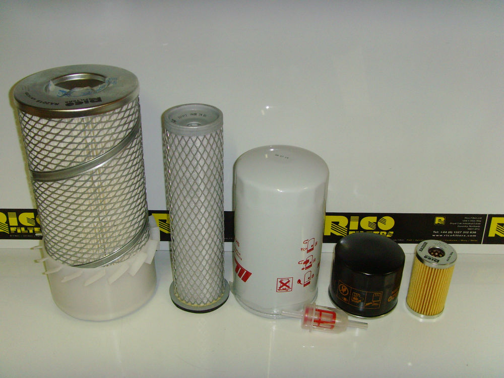

That's perfect. That's exactly what I needed to know. I had a feeling that would be the case, but my only other way of finding out would be to order on and see how they fit. Does the open end of the inner go toward the intake, like on the outer, or is it backwards? I suppose it will make sense when I see them together.
Anyway, here's the picture of the finned cup I was talking about. It came up when I was searching for pictures of the DK air filters, to see what the inner looked like. This particular image is from a cheap, cobbled together kit on eBay, so it's probably not OEM, but it shows up on a lot of images, so it appears to be pretty common.
Ahhhh, I see what you're asking now. That finned cup is actually made on to many filters. For instance, my John Deere 2510 requires an intake filter that looks exactly like that. Many other tractors use the same or similar. However, this is not part of the filter required for our DKse tractors.
As far as the installation of the inner an outer filter, you are right when you say "it will make sense when I see them together" Both the inner and outer open ends face towards the intake. You can pop the inner filter on first (as if it were the only filter) then the outer filter goes on right over it. The baseplate of the filterhousing is shaped to accommodate this.

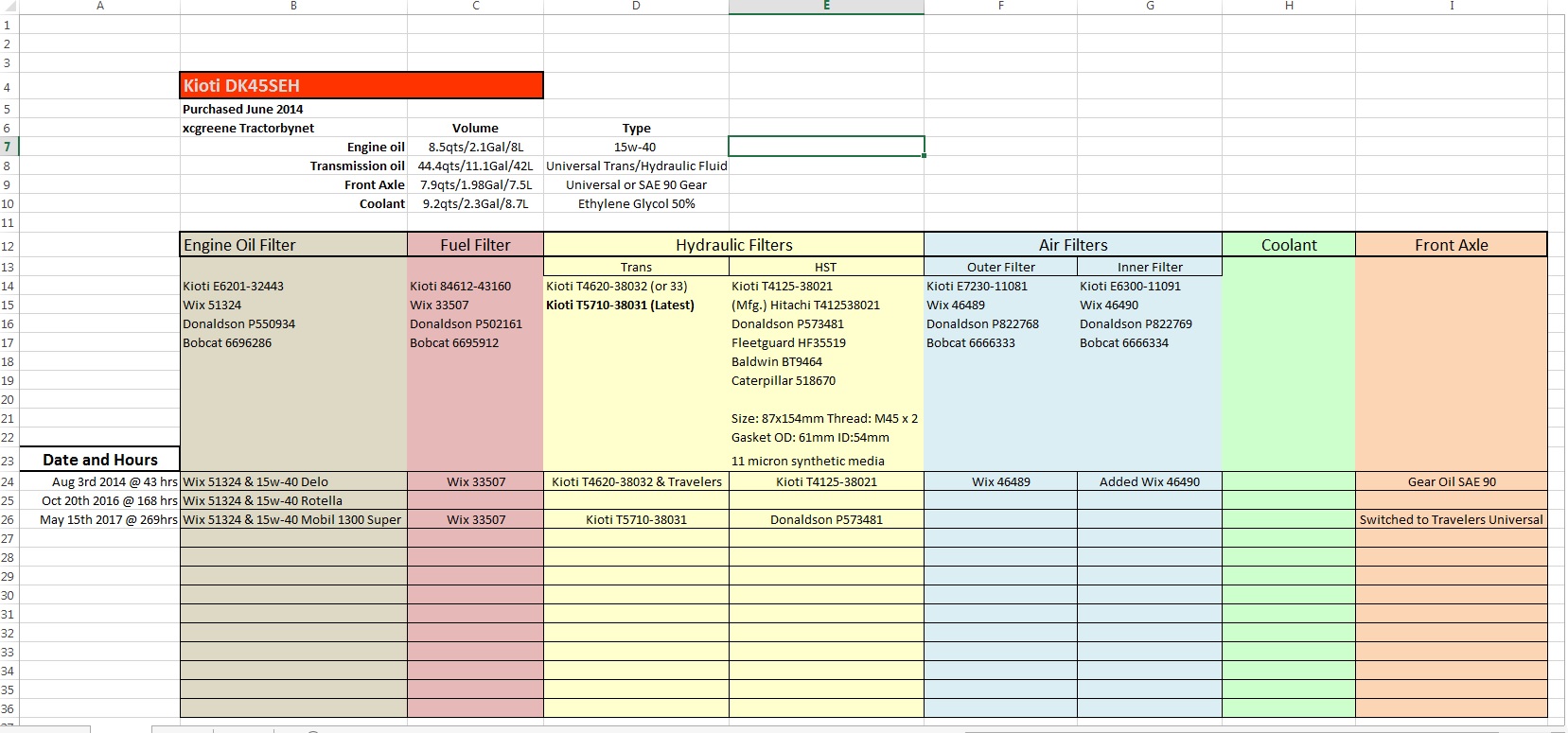

For my DK45SEH maintenance log, I put together this excel sheet. Lots of time spent looking for all the filter cross references, but I like having the options. Perhaps you could find it useful for your DK40SEH

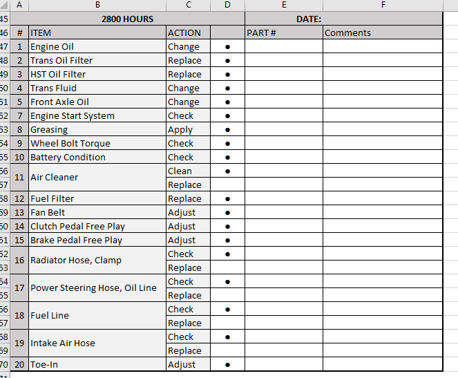

Thanks. Unwittingly, I started with your sheet from another thread, trying to make a chart to put in my maintenance log.
I made an Excel version of the PMCS chart from the manual and then made up a small binder that has checklists through 9000 hours (maybe a bit optimistic on my part). It took a little mental gymnastics getting through the first 3000- making sure I got, for example, check boxes for the 100, 200, 400, and 800 hour items for the 800 hr service, but after that it was just a copy, paste, and print exercise.
I ended up with 2-3 service interval per page, with room to take notes, so it printed out to 40 pages or so, and it's formatted just to click and print with the margins right and no page breaks in the middle of a service interval.
Looks like this.
