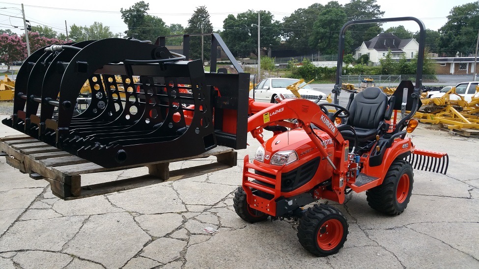

Oh, and here's some eye candy for you as you're waiting for the grapple!
   / Single Lid CUT Wicked Grapple..If your compact tractor could talk....
#145

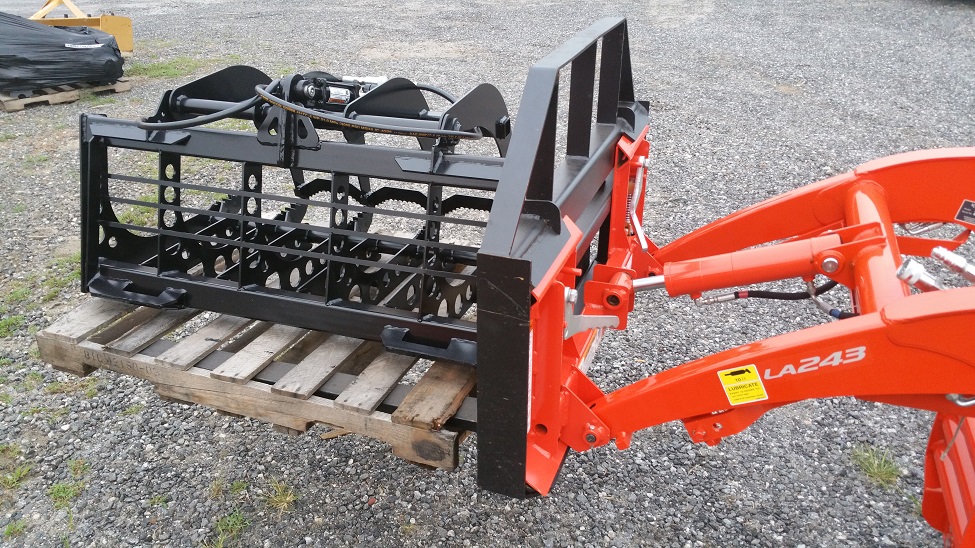

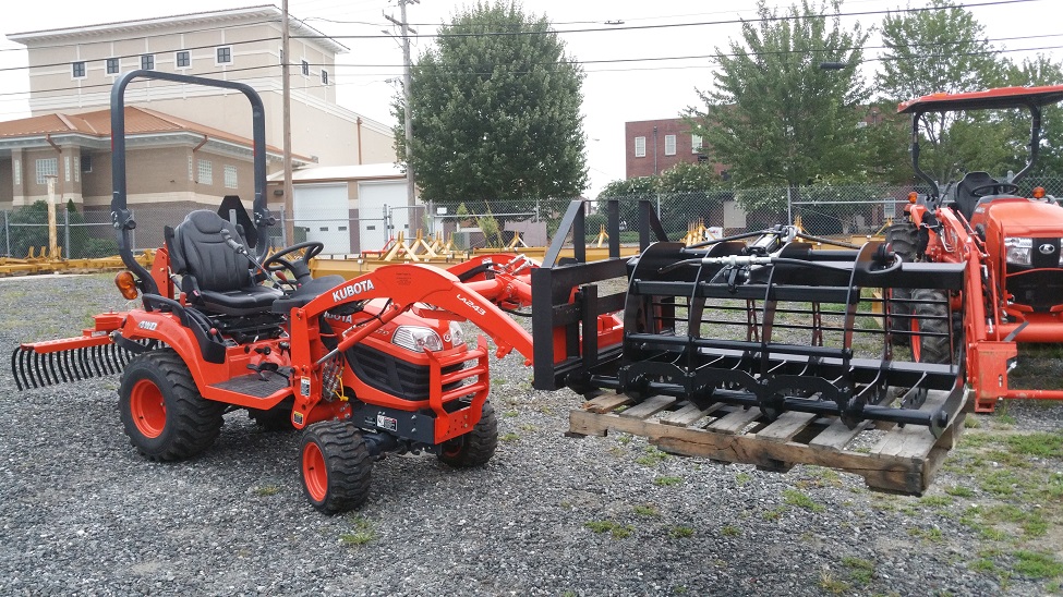

I was in the mood for pics this morning.
Travis

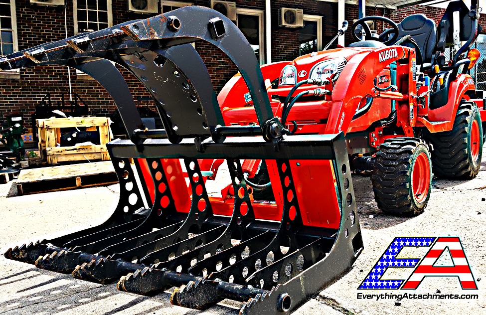

I was surprised by the fast opening/closing cycles this little BX produced.
I posted a short clip on our EA Facebook Video Page.
This is my favorite pic.
Travis
