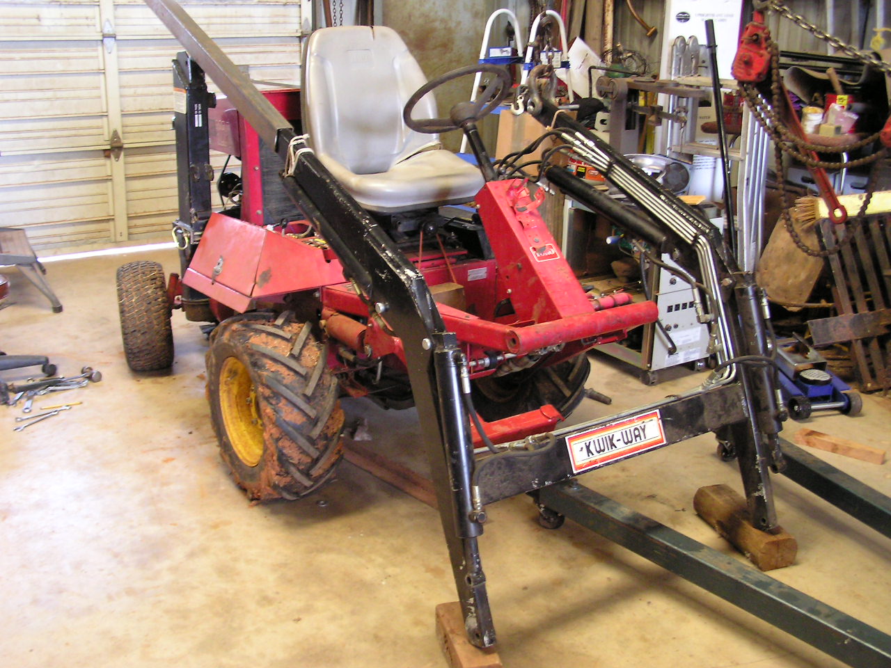

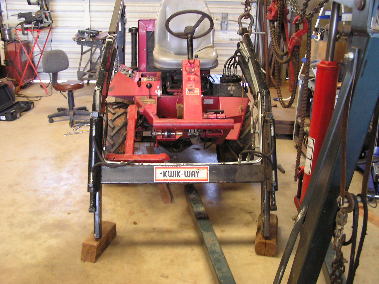

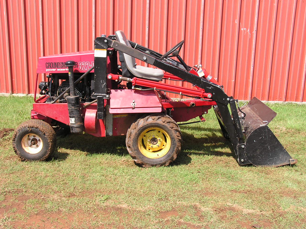

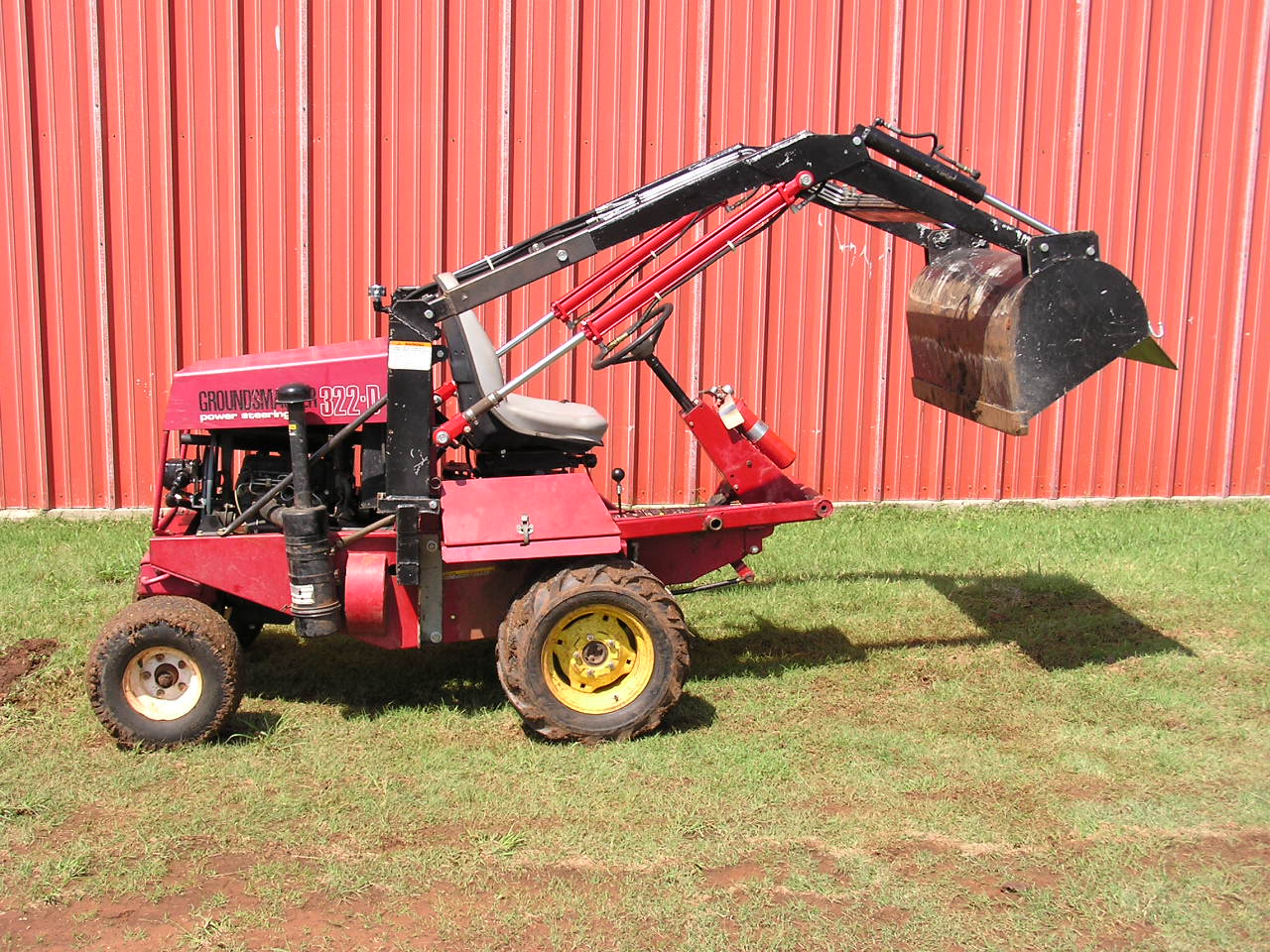

22 hp, 850 lbs lift, 9' high. Should handle it just fine. :thumbsup:
