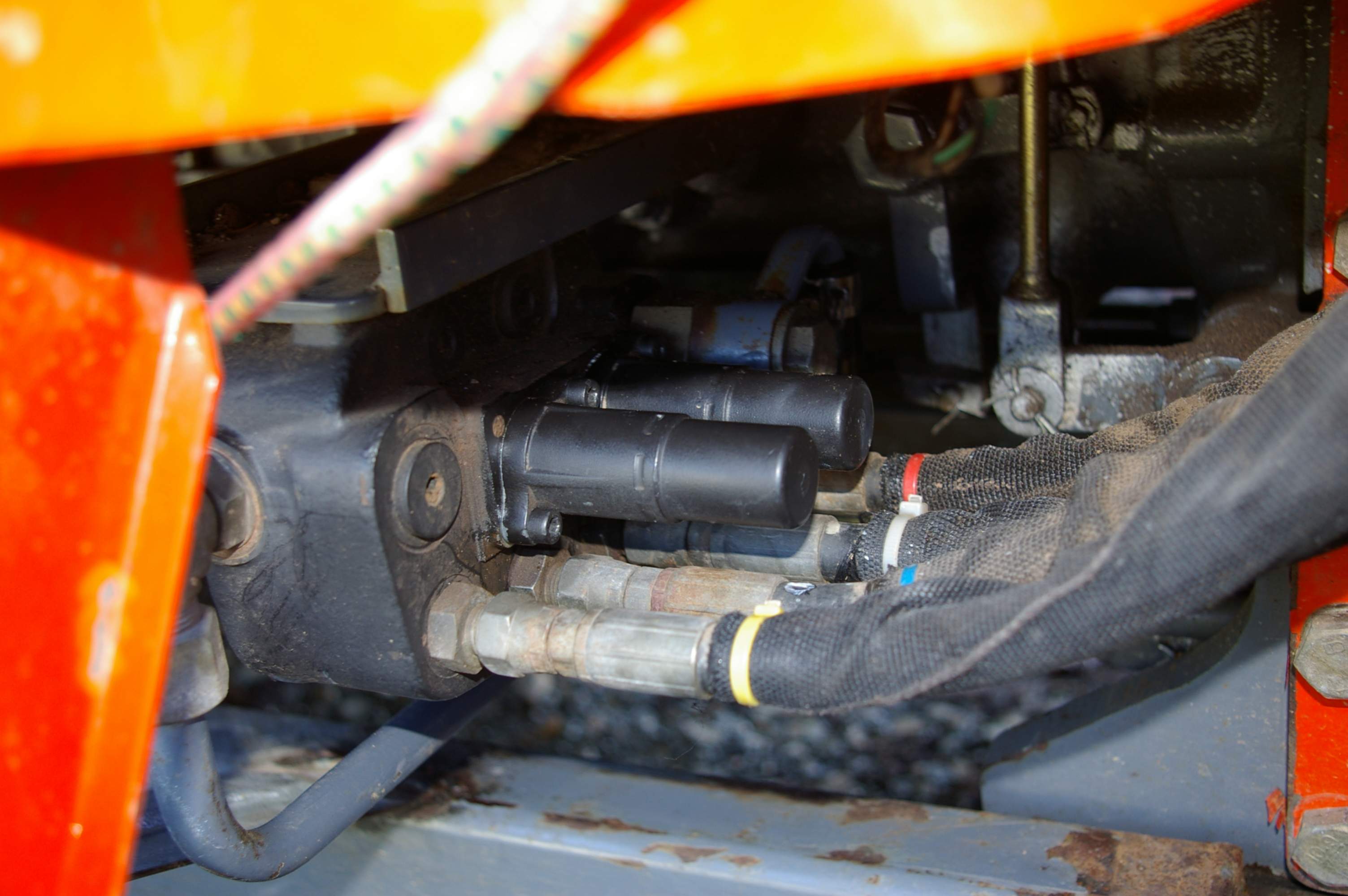

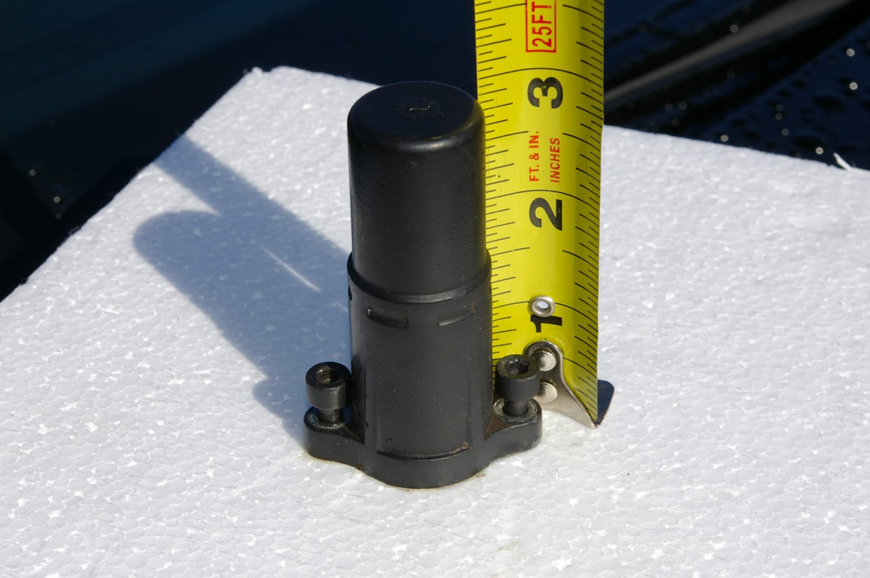

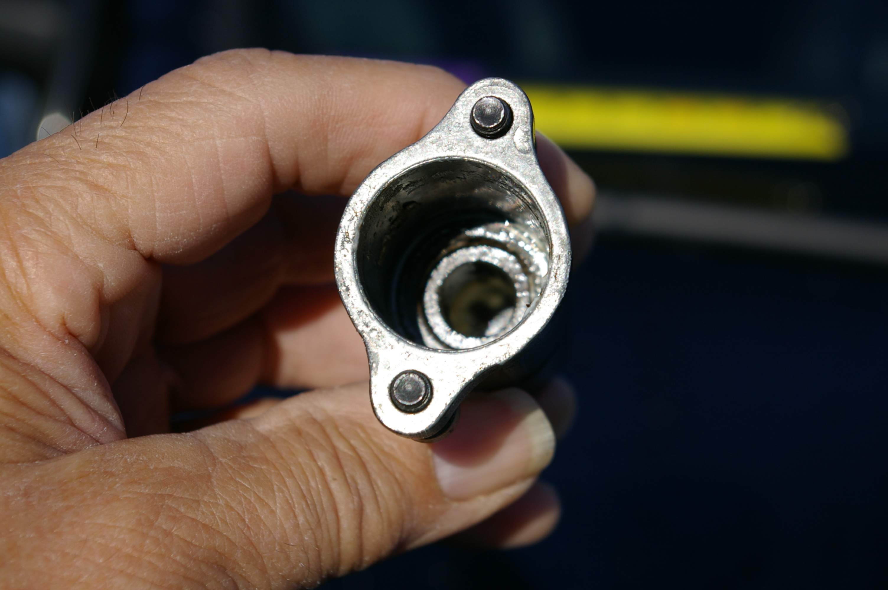

   / Single Remote Lever Wont' Stay in Position #8
Wallace:
No the part I am looking for is the Spoole Plunger Cap down under the tractor
That is controled by the joy Stick .... Pictures attached.
Thanks..
Dave

   / Single Remote Lever Wont' Stay in Position #9
I have the same problem. Only difference - my float quit working and I discovered the balls were very corroded in that cap. I greased everything and the float still will not hold because the balls are worn down due to no lubrication. I have accepted that the float is gone. The detent that the balls fall into may be worn also. I can feel a slight "grab" where the float position use to be but it won't hold no matter how much grease there is. Good luck............
   / Single Remote Lever Wont' Stay in Position #10
Hodak:
Have you pulled the cap off the bottom ( the Spool Plunger cap)
and take a look and see if the balls are in the cap. they could be all gummed up or rusted and not moving the way they should. Take a look at the pictures I posted.. As the other posts state, there is 3 balls in there,and they need grease to keep them working.
