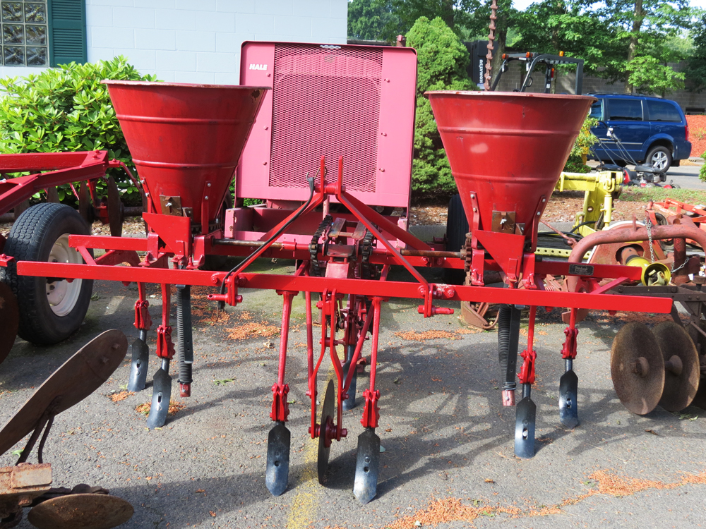

To answer this along with your other post, sounds like it may be easier to find a good used 2 row planter, then find something like in the picture below to cultivate and side dress.

Showing my ignorance here.... but that cultivator set up has a planter attached to it correct? I mean, if it was just a 2 row cultivator with fertilizer attachment, all the parts in the middle would be missing, right?
Yeah, after thinking things through somewhat, I'm kind of thinking that I don't really need a fertilizer attachment on my planter, and as you suggest, maybe the fertilizer attachments on the cultivator makes more sense. I'm assuming you can still use that type of cultivator without dropping fertilizer?

That's a 2 row cultivator with side dressers. No planter... The outside row when you start would have fertilizer just on one side, unless you went back and hit in between the center section. But once you start, and come back the next two rows, fertilizer would be dropped on both sides, from there on across the section of planted rows.
Yes, it can be used without the side dressers. Don't have one, but assuming you can either fold up the drop tubes, or they are easily removed. Loosen the chain tension sprocket, and remove the drive chain. Actually, you'd only be side dressing one time, about the time corn starts silking up.
How many times you cultivate, basically depends on weed growth. And a lot of that depends on rain to make them grow. Might be once a week, or every two weeks. But it's best to get them when they are small, and I mean when the first two leaves of a weed are the size of pinheads. You don't really want it plowing deep, just sort of scratching the surface well, enough to turn the roots up on the weeds. There are more than several Youtube videos on cultivating.
I know one thing about 3 pt. cultivators... Once you get set on the row, don't look back. One slight turn of the wheel, and you've plowed out some corn. Especially if you do get set up with the tires 4" from the plants... If you have very much sideways slope, it's going to be tough to hold it on the row. Seems the tractor wants to drift down hill.
You don't say large of an area you intend to plant, but you could broadcast spread the fertilizer on. The crop just needs a starter to get it going. Maybe not as potent as having the fertilizer directly on or beside the row, never the less, it will pick up the nutrients. Better in my opinon, making the roots seek the nutrients forming a better root base.

DJ54- I still don't understand the way that thing works. Why does it have a coulter (or whatever it's called) on the front middle? I mean, why are the sides and middle different? I'm assuming it has something to do with driving the chain and sprockets for the fertilizer hoppers.
Do you come back on every row or every other row?
Do the outside cultivators line up with the rear tire centers?
I know. I'm thick!
Wow. didn't realize people cultivated that often with a tractor.
As far as broadcasting goes, I have a spin type broadcaster. Out of curiousity, if you were to broadcast for field corn, would you broadcast at planting or wait until the plants had germinated. My problem with broadcasting these days is that all the readily available N is so volatile..... always praying for rain!
