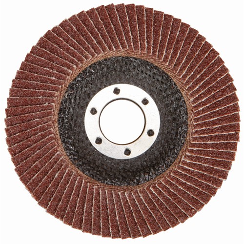

I splurged a year ago and bought a Milwaukee 5" variable speed grinder. I like to slow it down for a wire brush. So much better than the HF grinders I have, but cost a lot more too. The wire brush is the only thing I can see any reason to slow it down. I haven't used flap wheels, don't know if they would benefit from slower speed.
You are missing out on not using flap wheels. Try one for metal prep and see how good it works.

You will be surprised how fast a flap wheel ( sometimes called Tiger paw) will cut. I use them to sharpen my lawnmower blades. They cut fast but don't overheat as bad as a grinding disc. They aren't cheap but they last a surprisingly long time and unlike grinder disc that get out of balance and bounce up and down on the metal, the flap disc are smooth as silk.

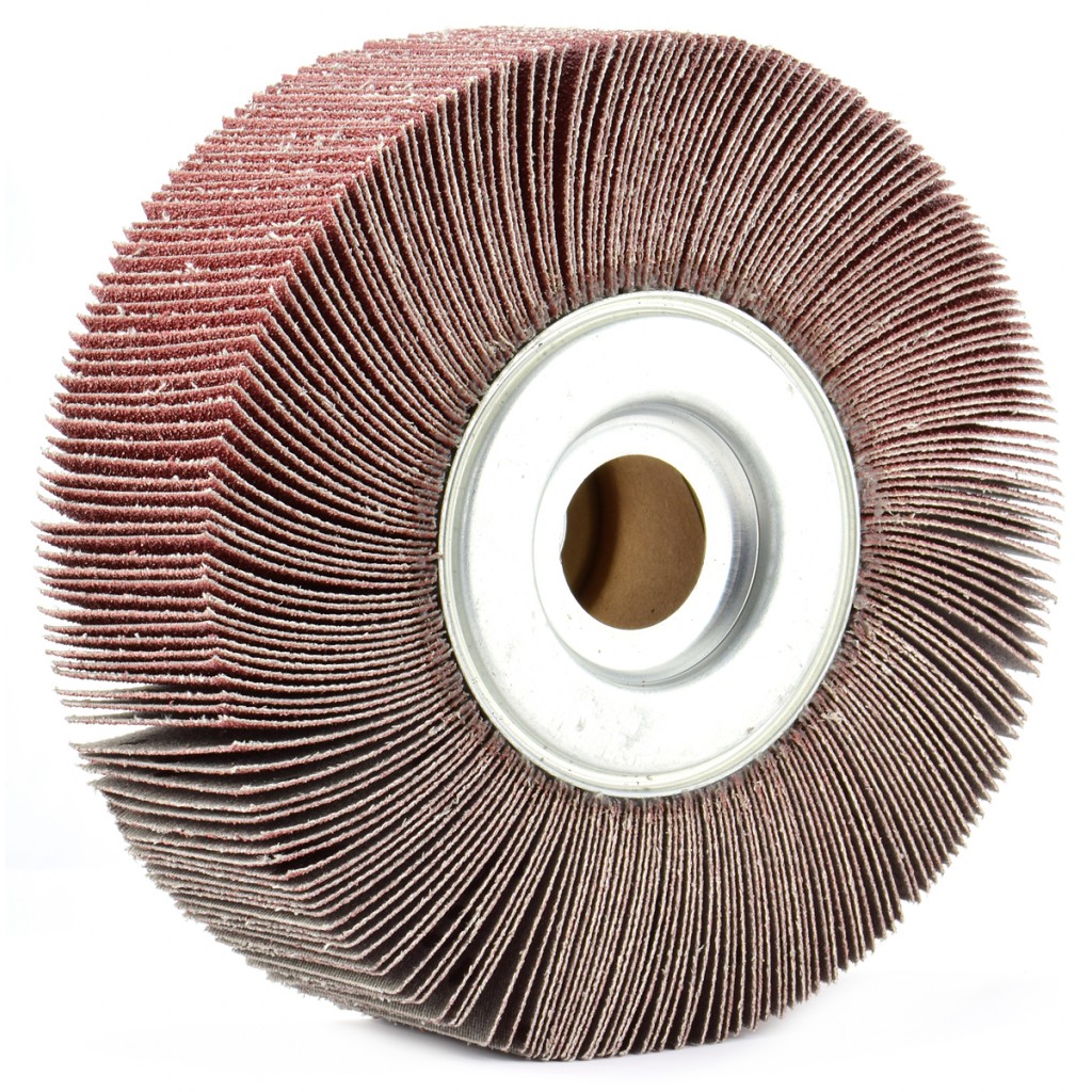

I am not sure on the terminology now that we are talking about flap wheels. I often use and really like what I call 'flap discs' and love them.
But I have never tried what I think are typically called flap wheels.
Are we all on the same page here?
   / Single speed or Variable speed angle grinder ? #26
I use both but am definitely guilty of referring to the flap DISC as a "wheel". Glad you pointed that out.
