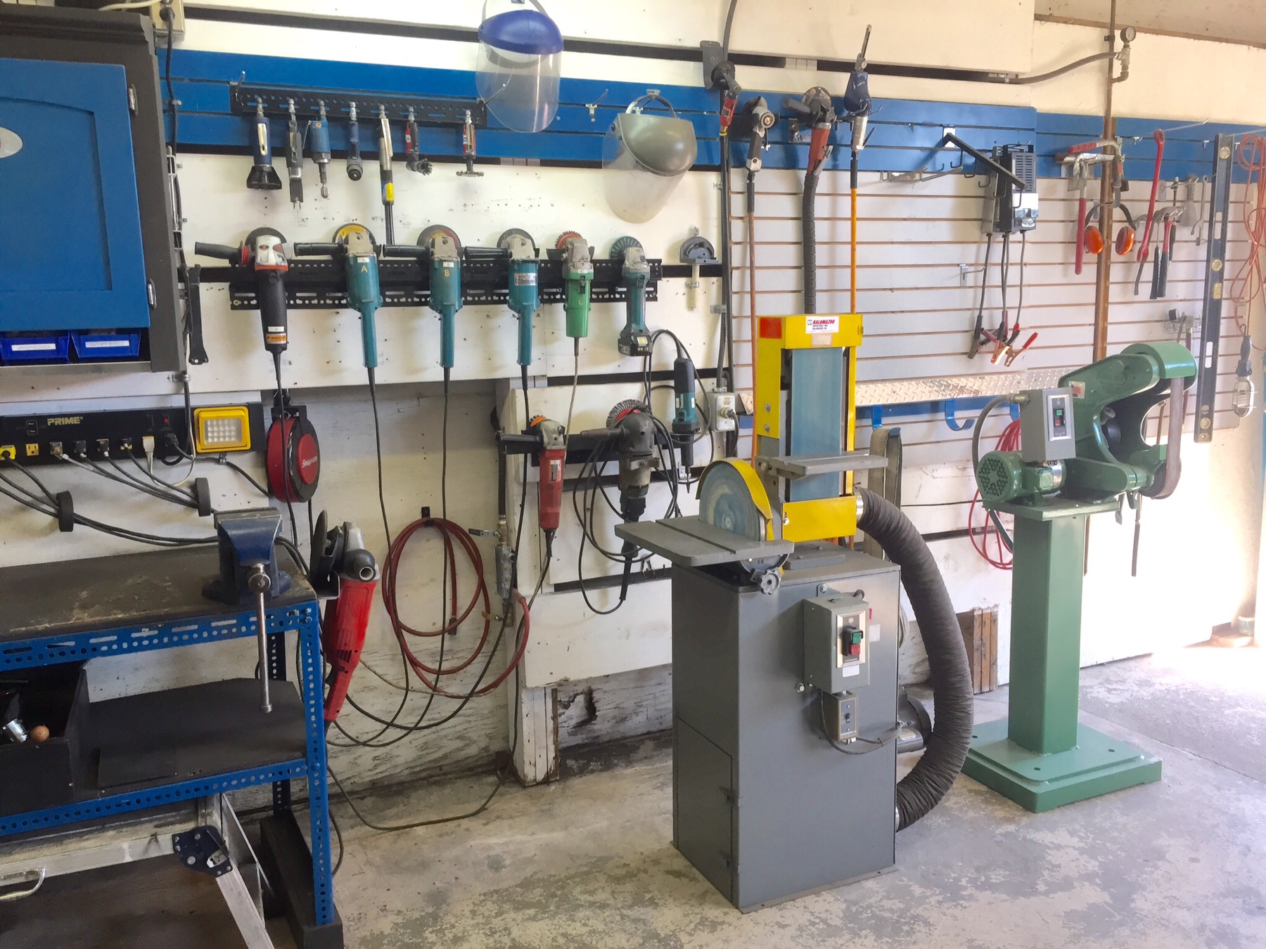

Big Barn. I have been looking for a commercial bench top combo Belt & Disk Sander. I see you have two floor mounted ones. How come two?
/ Single speed or Variable speed angle grinder ? #14
The combo belt/disc Kalamazoo on the left is used mostly for squaring up stock. The green Burr King next to it can be used for slack belt and contour sanding using the radius of the bottom idler wheel. Hope this helps.
/ Single speed or Variable speed angle grinder ? #15
Thanks. Yes, I need something to square up stock. But I don't have the floor space to put something like you have. Well, I might, if push really came to shove. Is the wide belt good for squaring up stock or is the disk better? Most commercial units seem to have narrower belts and generally no disk. That seems to be more of a woodworking thing, no?
/ Single speed or Variable speed angle grinder ? #16
Industrial Toys.
I find the 12" disc quicker for squaring up stock. The 6" wide belt is nice for finer finishes and sharpening tools. But then that's just me...
You might consider a "knife making"belt grinder. Lots of kits and plans for them available. You'll need one with a tool rest or table for squaring up stock. They don't take up too much room.
