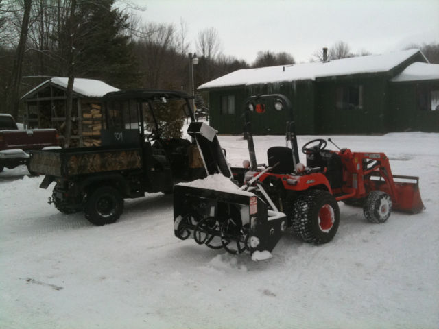

I have a 48" luck now on my bx 2200 and that is all I would ever want built heavy and manages it well any bigger and I'd be crawling IMO

I went back and forth between a 50" and 60" rear blower for my BX2350. I ended up with the 60" and am glad I did. I have some good drop offs near the edges of some parts of the driveway and the extra width keeps me a little farther away. Also, even with the wider unit, I still end up running over unblown snow with the front tires when making steering corrections.
FWIW, I also have chains on all tires due to a 10% grade in part of the driveway.
