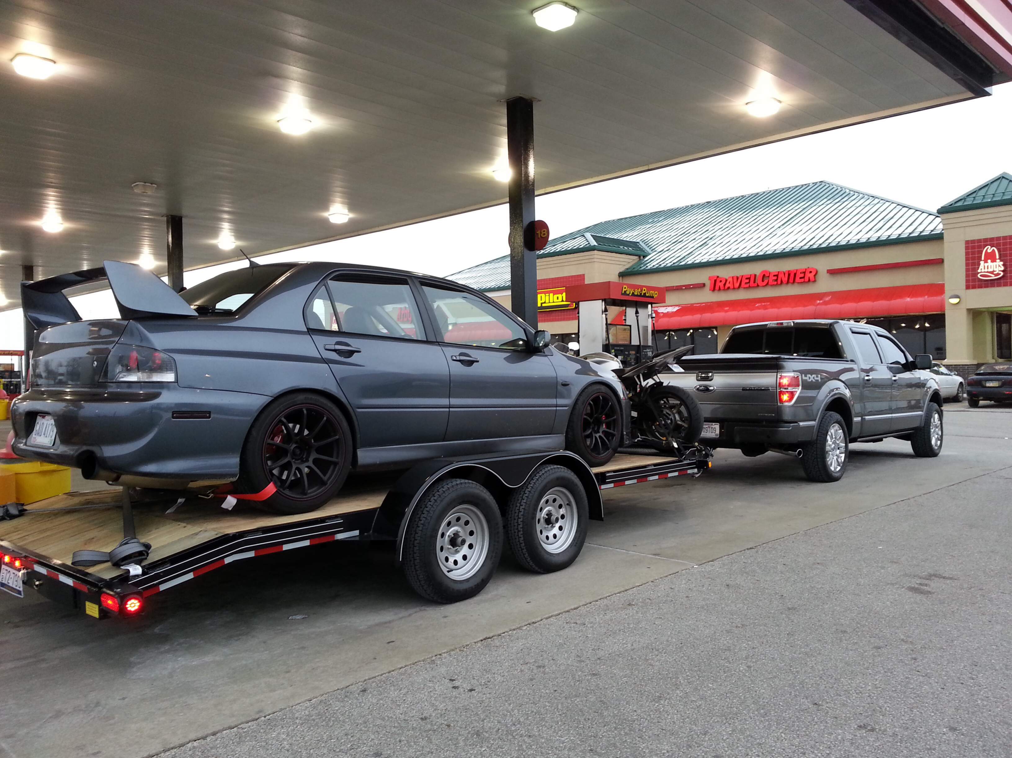

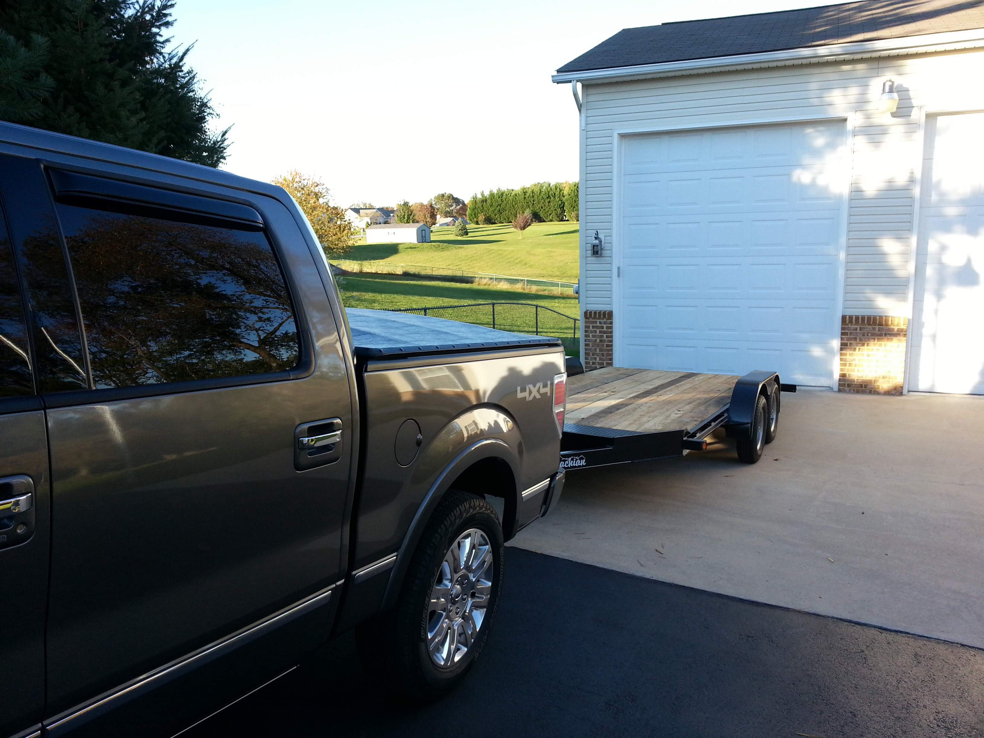

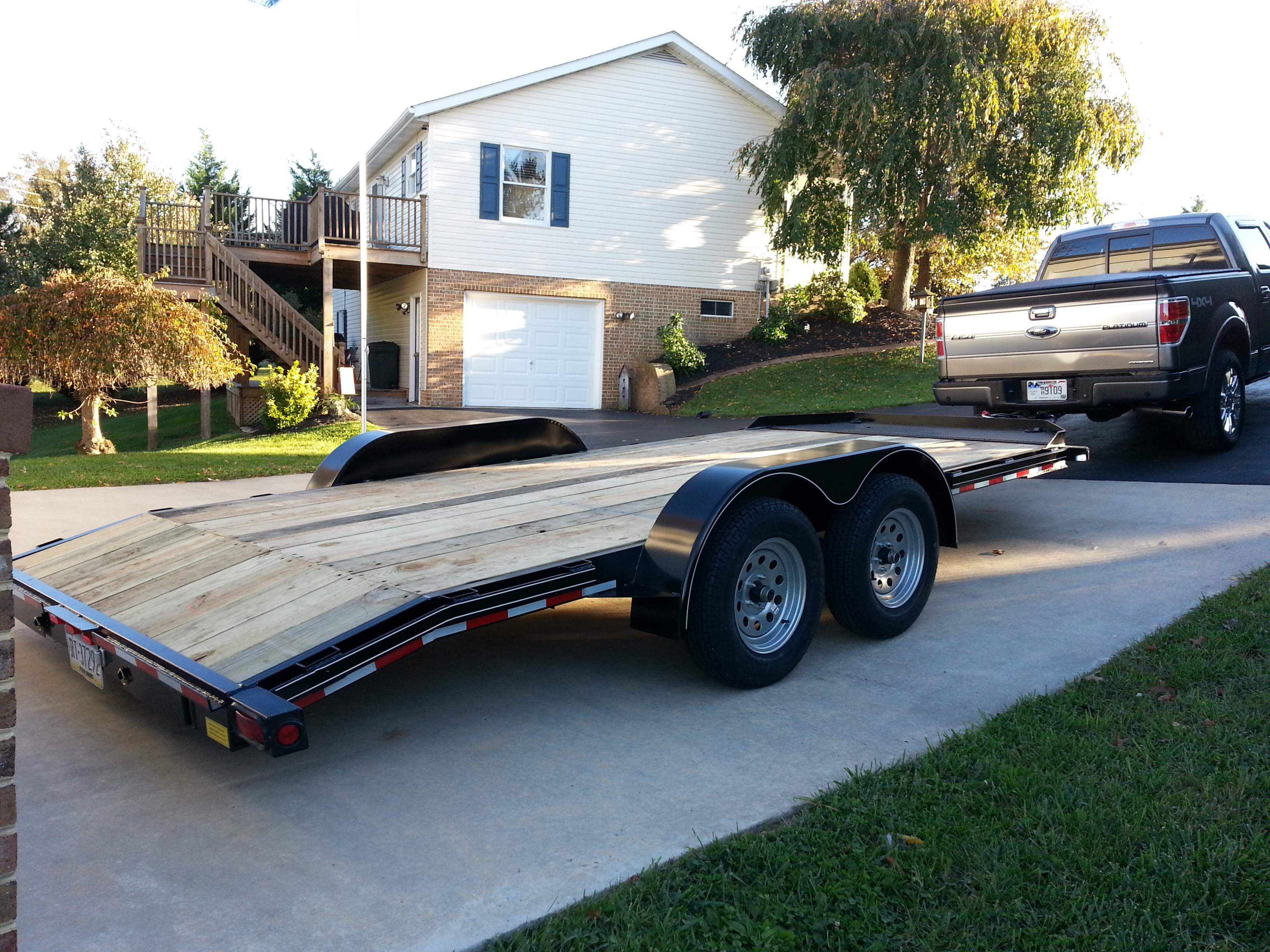

I use an 18' tandem trailer. Brakes on both axles. Appilachain manufacturing. Nice 7,000lb trailer. Comes with 5' full steel ramps that are stored in the rear underside of trailer behind doors. $2695.00 with upgrade to radial tires, and winch plate.

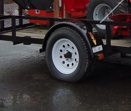

There is no way I would haul that much weight on a trailer with 2" coupler and 3" frame rails. That would list a 360 lb tounge weight provided you distribute on the trailer right. Wrong answer.
