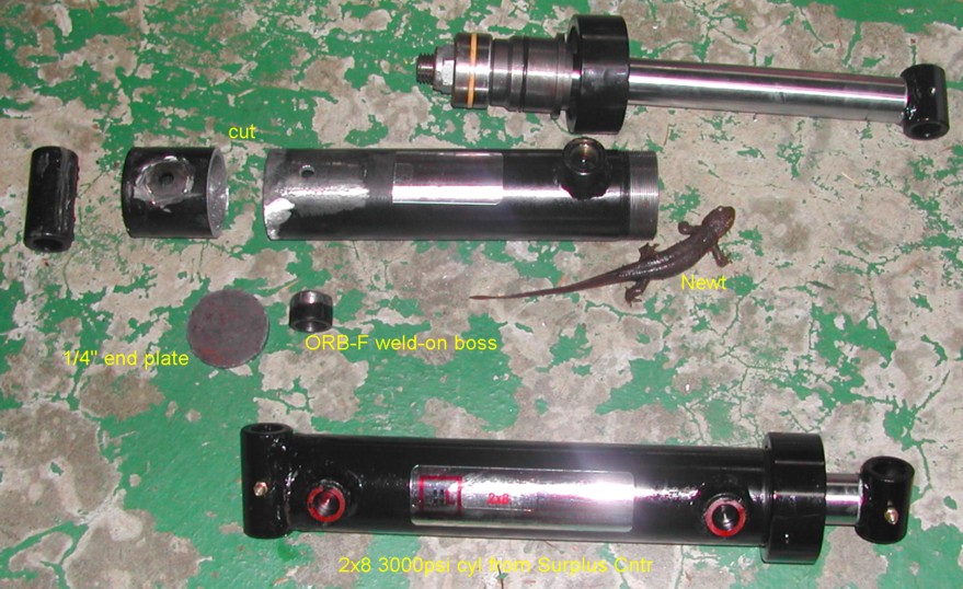

I am just finishing up my 3rd Generation backhoe thumb, which
will be an hydraulic version of my fixed or articulated thumb. Some
comments come to mind as I read this thread:
> don't get into an "analysis paralysis" situation when doing your
design. It is not that complicated.
> the forces exerted by the thumb cylinder will vary as the thumb goes
thru its arc. Your thumb needs to be strong enough but also
retract far enough to get out of the way, while not hitting the
dipper. These are conflicting parameters.
> I like welded cyls for this application and Surplus Center had some
3000psi 2x8 cyls for sale for only $45. I bought several. This is a
slightly larger ID than my curl cyl, but the bkt curl will have more leverage
thru most of its arc. I do not know the max pressure specs for my
curl cyl. It is prob not stated for the Bradco either. I doubt they are
the cheapo 2500psi cyls since the Bradco and my Prairie Dogs handle
2500psi wp by design. What is the 509's curl cyl OD?
> if you are concerned about overpressure damage to your thumb
cyl, consider using a shock relief valve on the retract side of the thumb
valve you will be installing. I don't think it is necessary myself.
> In my design, I am using a poppet style solenoid valve connected to
the curl cyl ckt so the thumb cyl operates in parallel with the curl cyl.
One advantage that offers is both jaws close at the same time.

My design is done and I have the cylinder ready, but I have not received
my solenoid valve yet, so stay tuned. It IS an experiment, so I have not
verified all my intended results yet. My cyls are very close in size at 2" ID.
My plan is to use ONE poppet valve (rather than a solenoid spool valve) on
only one side of the thumb cyl. A toggle switch on my console will switch
betw a fixed thumb (retracted or not), and a thumb that moves with the
bucket. Note that poppet style solenoid valves allow some leakage under
pressure in one direction. I am planning for that by installing it in the
proper direction so it will hold in the fully retracted position.

2" rod! That's huge.
Sizing the cyl for length was a tougher choice for me. A longer stroke
may allow the thumb to be retracted tighter against the dipper, while
still allowing useful range of motion. But longer stroke means a longer
cylinder so the pivot bracket on the dipper had to be farther up. Or...
I could use a shorter stroke and move the pivot position on the thumb
inboard. This gives less thumb leverage, yet the thumb has to be
stronger (longer moment arm). Lot of variables.
Here is a photo of a couple of the welded cyls I recently bought from
Surplus Cntr. I am quite happy with their quality. Photo is an unmodified
cyl and one that I shortened up for a tilt cyl for a T-n-T setup. I
substituted swivel eyes on each end.
   / Sizing a Backhoe Thumb Cylinder
#19
dfkrug said:
2" rod! That's huge. Sizing the cyl for length was a tougher choice for me. A longer stroke may allow the thumb to be retracted tighter against the dipper, while still allowing useful range of motion. But longer stroke means a longer cylinder so the pivot bracket on the dipper had to be farther up. Or... I could use a shorter stroke and move the pivot position on the thumb inboard. This gives less thumb leverage, yet the thumb has to be
stronger (longer moment arm). Lot of variables. Here is a photo of a couple of the welded cyls I recently bought from Surplus Cntr. I am quite happy with their quality. Photo is an unmodified cyl and one that I shortened up for a tilt cyl for a T-n-T setup. I substituted swivel eyes on each end.
