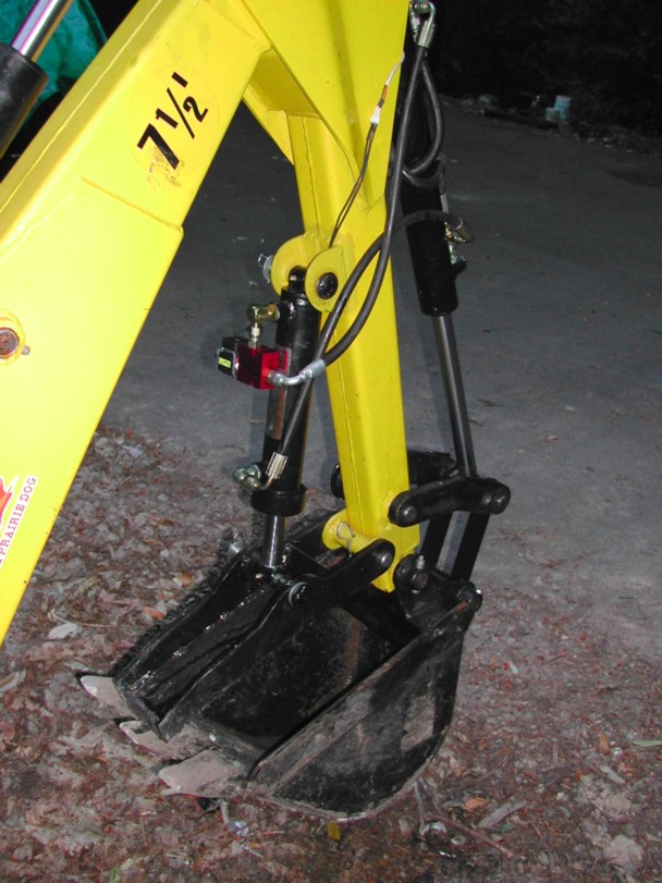

A hyd thumb can
> use a cyl plumbed to its own independent valve
> use a cyl T-ed into the curl cyl circuit, controlled by the curl valve
> use a cyl T-ed into the curl cyl circuit, with a solenoid valve shutoff,
controlled by the curl cyl valve and an electric switch
My hoe now has the 2nd choice above, a thumb cyl in parallel to the
curl cyl. I also tried #3 with a 12V poppet valve, but that method did
not work too well with the valve I had (too restrictive). Another poppet
valve or a solenoid spool valve would work better. I plan to experiment
with other solenoid valvews in the future.
My thumb cyl is 2" ID, and my curl cyl is a little less than 2" ID. With my
setup, the thumb is a bit more forceful than the bkt curl, so it pushes the
bkt back slowly when pinched together. My thumb uses a plow steel tip,
which is harder than my cast bkt teeth, so pinching them together scrapes
steel off of the tooth.
