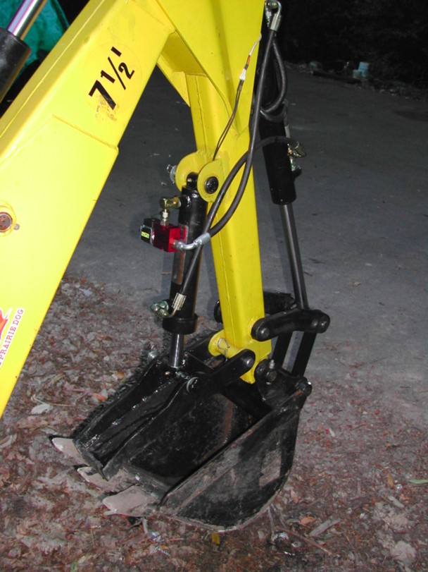

Do hyd. thumbs really work as a clamshell in gripping, or do you use hydraulics just to position the thumb and use bucket pressure to grip it? As I see it now...........you can plumb it two different ways. Since the Bradco's thumb and bucket pivot on the same pin, a clamshell would be the best, while deploying the thumb with a remote and using bucket control to grip and not squeeze would be the cheaper route.
I do not understand your question. If the thumb has an independent cyl
and valve, you will sometimes pinch the thumb against the stationary bkt,
sometimes pinch the bkt against the stationary thumb, and sometimes
operate both valves simultaneously.
A hyd thumb can
> use a cyl plumbed to its own independent valve
> use a cyl T-ed into the curl cyl circuit, controlled by the curl valve
> use a cyl T-ed into the curl cyl circuit, with a solenoid valve shutoff,
controlled by the curl cyl valve and an electric switch
My hoe now has the 2nd choice above, a thumb cyl in parallel to the
curl cyl. I also tried #3 with a 12V poppet valve, but that method did
not work too well with the valve I had (too restrictive). Another poppet
valve or a solenoid spool valve would work better. I plan to experiment
with other solenoid valvews in the future.
My thumb cyl is 2" ID, and my curl cyl is a little less than 2" ID. With my
setup, the thumb is a bit more forceful than the bkt curl, so it pushes the
bkt back slowly when pinched together. My thumb uses a plow steel tip,
which is harder than my cast bkt teeth, so pinching them together scrapes
steel off of the tooth.

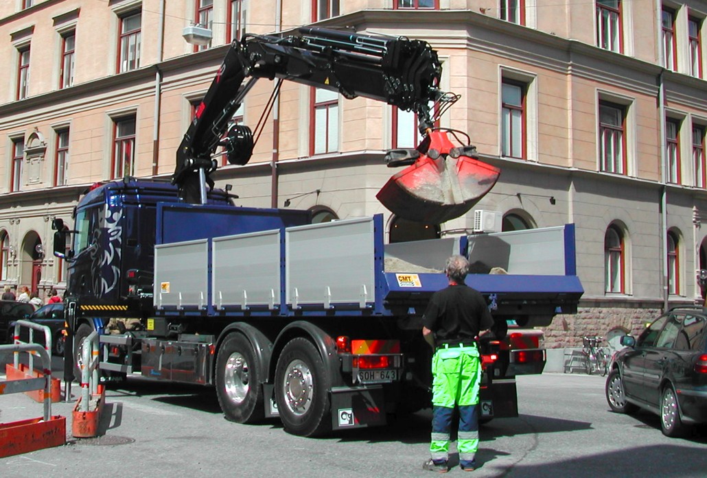

Here is a neat machine I saw when I was in Stockholm last week.
It is operated by remote control and uses a clam shell to scrape up
the last little bit of sand on the bed of this truck. The clam shell
uses a mechanism that closes the jaw with the least back-pressure
first. Just like a clam shell on an excavator at the local scrap yard.
This kind of action can be mimic-ed with a hyd thumb....easily with
a thumb cyl connected in parallel to the curl cyl, and a little harder
with a separately-valved thumb by operating 2 valves at once.
