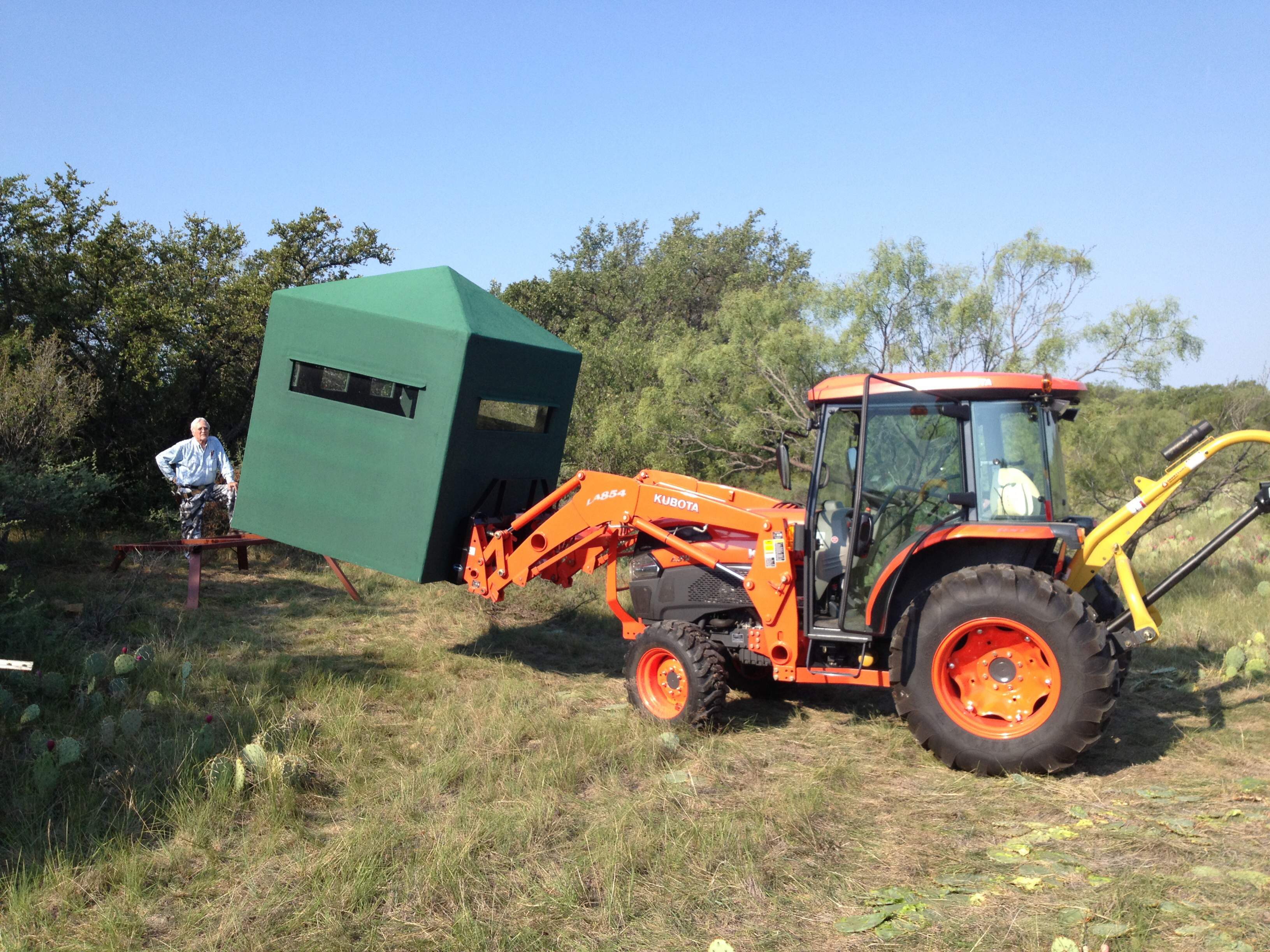

How do you all see the front tips?
I have 48". Kinda wish I had 60" because it's real hard to see the tips over the hood.
I am 6'2'' and I have 48'' forks. I can see them.
You could paint the tips of the forks Kubota orange to make them show up more.
