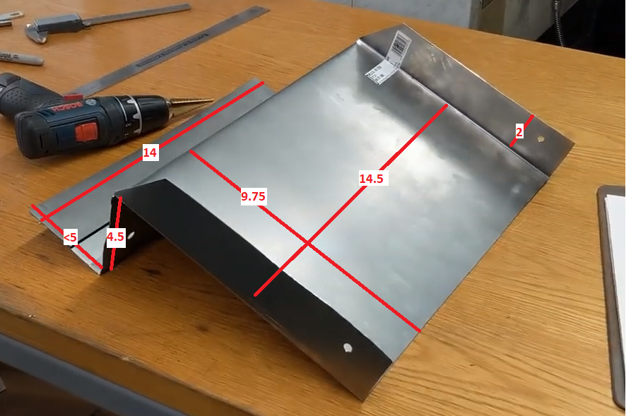

I built me one. If anybody wanna copy mine, here's it with the dimensions:
Here's a vid: Skid plate for Massey Ferguson GC17xx series tractor - YouTube
   / Skid plate for GC series tractors #143

And you don't have a bending brake, why? Considering all the stuff you fab, you outta. Speedy recovering to the wife, hopefully at most acute pericarditis that will resolve.
   / Skid plate for GC series tractors #146
Looks great! Nice build!

Thanks guys. Build yourselves one if you need it, it's easy!

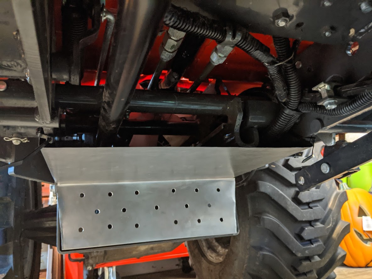

Sorry for the delay. It's pretty simple and I remove it in the winter to hook up the front driveshaft for a snowblower. Have to also remove it for changing the filter but it's only 4 bolts. I made it out of a scrap of steel of unknown parentage that I had laying around. Lots of big rocks around here and it held up real well. I bent it by heating the bends with a rosebud torch until it bent fairly easily. I don't use a mower. The skid plate cuts down the ground clearance under the rear differential by maybe an inch and so far hasn't been an issue.
I like how simple that is for those of us that won't be using a mid-mount mower.
   / Skid plate for GC series tractors #149
thats my issue with getting one installed, I use MMM a lot.
