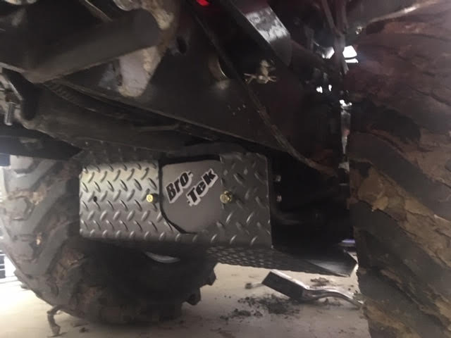

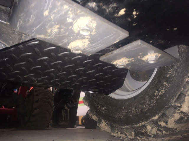

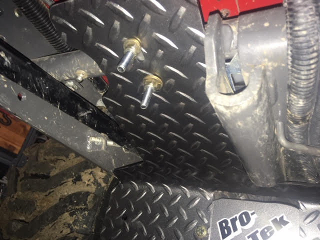

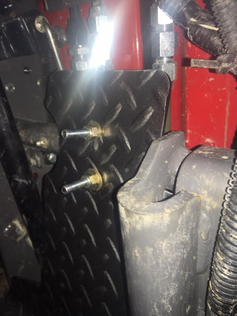

Just an update on the Bro-Tek Skid Plate - they are currently shipping them. I ordered one on 11/22/2019 and received it 11/30/2019 in Southern Illinois (pretty impressive imo considering it comes from Canada). Install was on a 2018 GC1715. I had thought about building one myself, but after figuring the money and time it would take, seemed like a no-brainer just to order one. Time is a limiting factor for me -- would have been a fun project to build, but too much stuff going on. Bolted up easily and quickly - no holes or modifications to be done on the skid plate or tractor. Will come off and back to stock just as easily.
This thing is a beast - looks like it will shield the hydro fan extremely well, and also blocks the hydraulic lines, filter, rear end, and the hydro fluid drain plug. I also have a 2" receiver bolted on in place of the factory hitch, so was concerned that this would prevent me from using the two rear mounting holes for the bro-tek plate, but there was no interference. The hydro fan has plenty of free open space on the sides and over the top of the skid plate, so I don't think there will be any issue with restricted flow (no more than a MMM would). Also, Bro-Tek has put a drain plug access hole in the bottom, so no need to drop the skid plate to change hydraulic fluid. Cut out is also in front of the mid-pto, and comes with the plate that blocks it off. I personally don't use my GC with a MMM, but i did not see anything that would make me think there would be any clearance issues if I did. This skid plate is tucked up nicely, seems very strong, and super easy to install. The only downside I saw on it is that it does lower your rear clearance by approximately an inch under the rear end. I could see that in really sloppy mud or snow, the skid plate may cause the tractor to float and not allow the rear tires to maintain traction. Personally, I think this is a good trade off, as I have already chewed up the hydraulic fan on two separate occasions and it is not a lot of fun to change.

Oh, that's actually pretty nice! And that was like 100 something bux, right? I'll wait to see if CBCGC1715 comes up with something interesting since we were all cheering him on to design/build one.

Good to hear, the Bro-Tek tucks up under way better then the one I am making so I might need to look at it a bit closer, my plate build is on hold being it is winter and my 1705 is parked and plus I have a HF trencher on they way and have a list of mods or add ons to do to that.
   / Skid plate for GC series tractors #126
Price is higher since the new design (covers a lot more than the 100 model did, from what I understood with my conversation with them).
