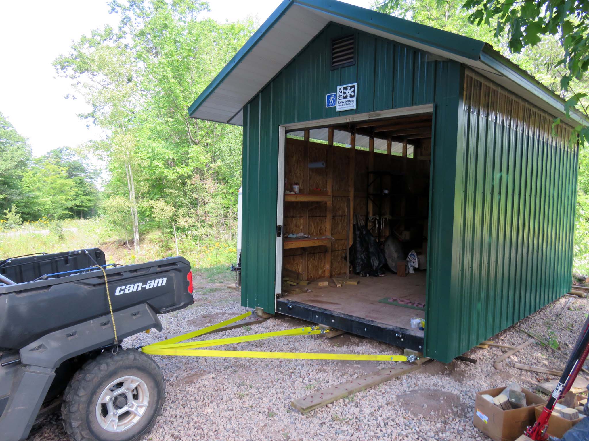

The 14x20 I just drew up has a 3/4 plywood floor supported by 2x8 at 1ft centers which is screwed down. In fact I use nearly no nails in this construction because it might get moved one day. The 2x8's are spanning 6ft so it should take quite a load. A 10ft roll-up door on the 14ft end at center. Oh and 90psf roof. Thats code here for snow. My building will be staked down for winds.
Attached is a skid shed we built some years ago and moved to to build a larger one.

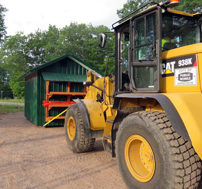

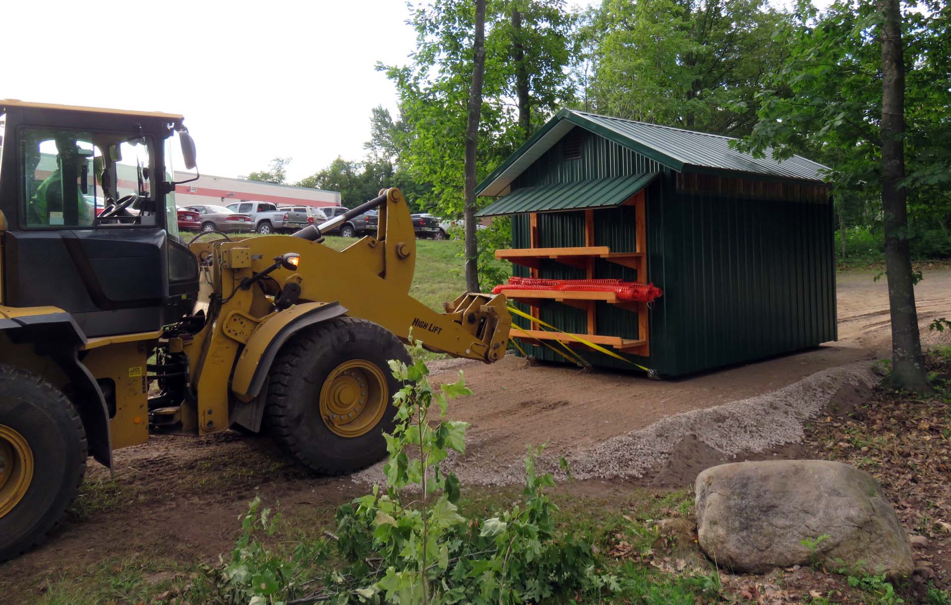

ArlyA you sure 90 psf is enough for Houghton Mi? You yoopers up in the Keewanaw sure love the white stuff.:snowman: Seriously that is one nice shelter you built. Were there any issues dragging it around with the UTV or was there any shifting in the structure itself?
/ Skid Sheds #9
We tried hard but didn't get it moved any more than 6". So we reverted to a slightly larger tow machine.. :laughing:
I build these sheds with the idea they may get moved. Yes that adds cost and time to there construction. After skidding this shed around the lot, we couldn't tell anything had moved on it.
