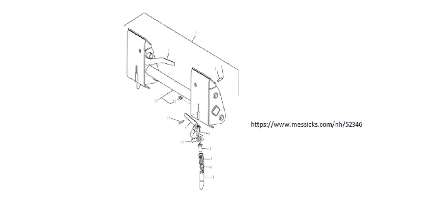

You might look here and see if it gives you some ideas on things to check.
Wheel Loader Attach

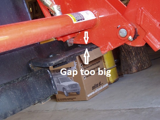

Lift the attachment off the ground. Then see how much gap you have between the attachment plate where the pin holes are and the bottom of your SSQA. Use this as a guide to add a plate shim.
The shim can be added to the top as suggested by bdog. Or can be added to the bottom which requires precise dimensions so the locking pins utilize the shim

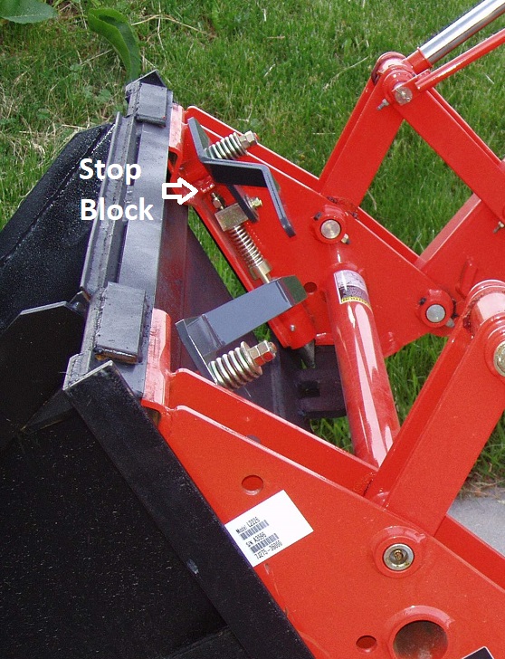

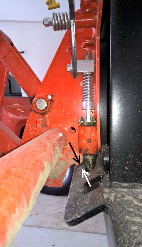

Pictures of the gap the guys are talking about:
And the stop above the latching pin when latched:
This shows the over center travel so the latch can't push the handles up:

Great pics X!!!! Thanks for adding them!!!

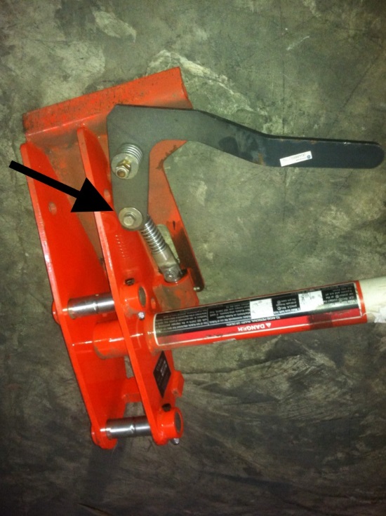

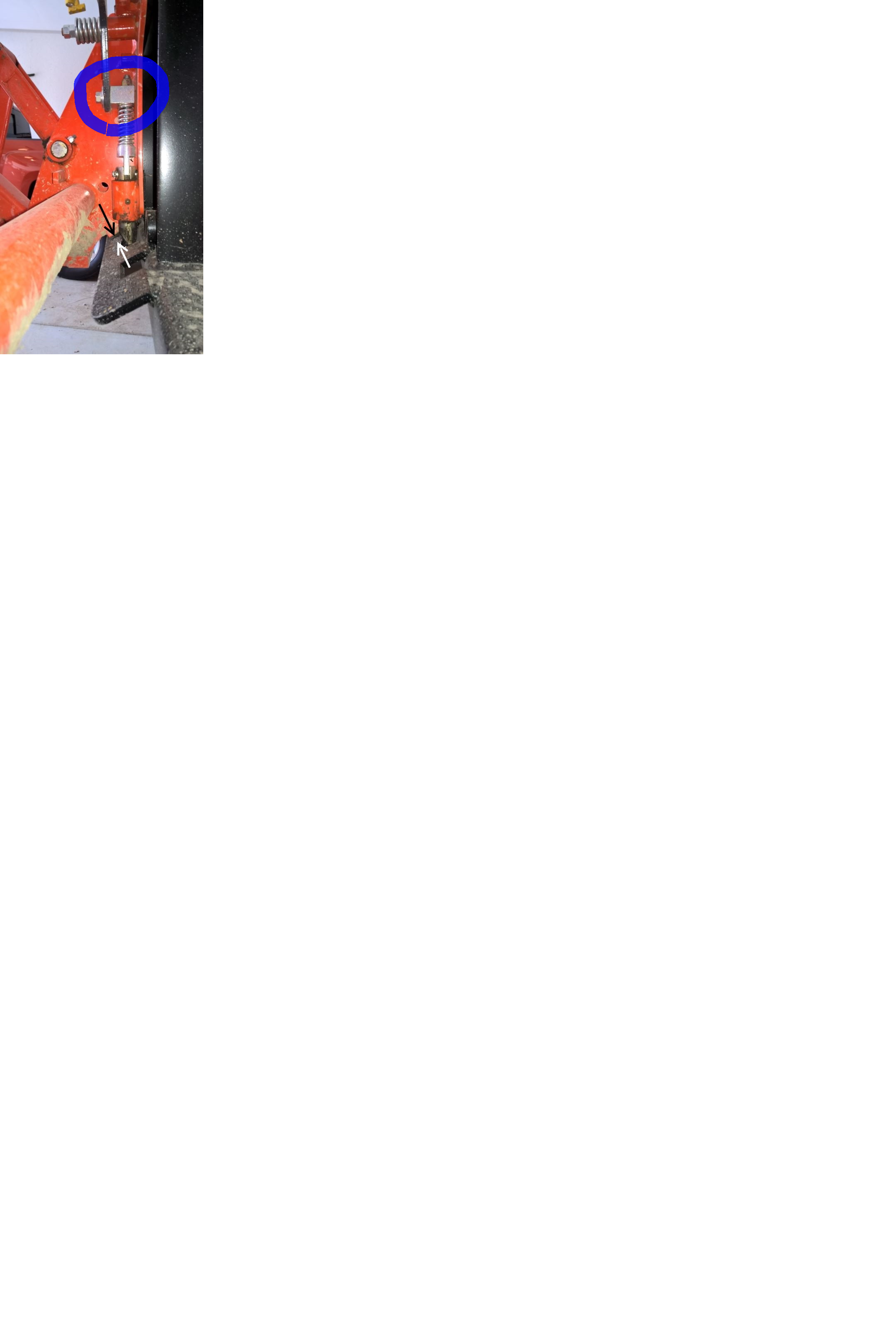

/ Skid steer attachments disconnecting #13
Wouldn't you want to make sure both of the bolts are adjusted correctly before breaking out the welder?
You're welcome. Pictures make it easier for those with little or no experience to understand the written word.
Yep, that is a good plan. :thumbsup:
View attachment 564636 View attachment 564637
Does this gap, or something close, exist with all your SSQA implements? If so, It could be wear or distortion on the FEL SSQA lifting brackets. Welding a shim or a heavy bead to the top of the plate will reduce that gap. Care must be used to maintain proper implement alignment.
I borrowed one of Xfaxman's pics to illustrate.
