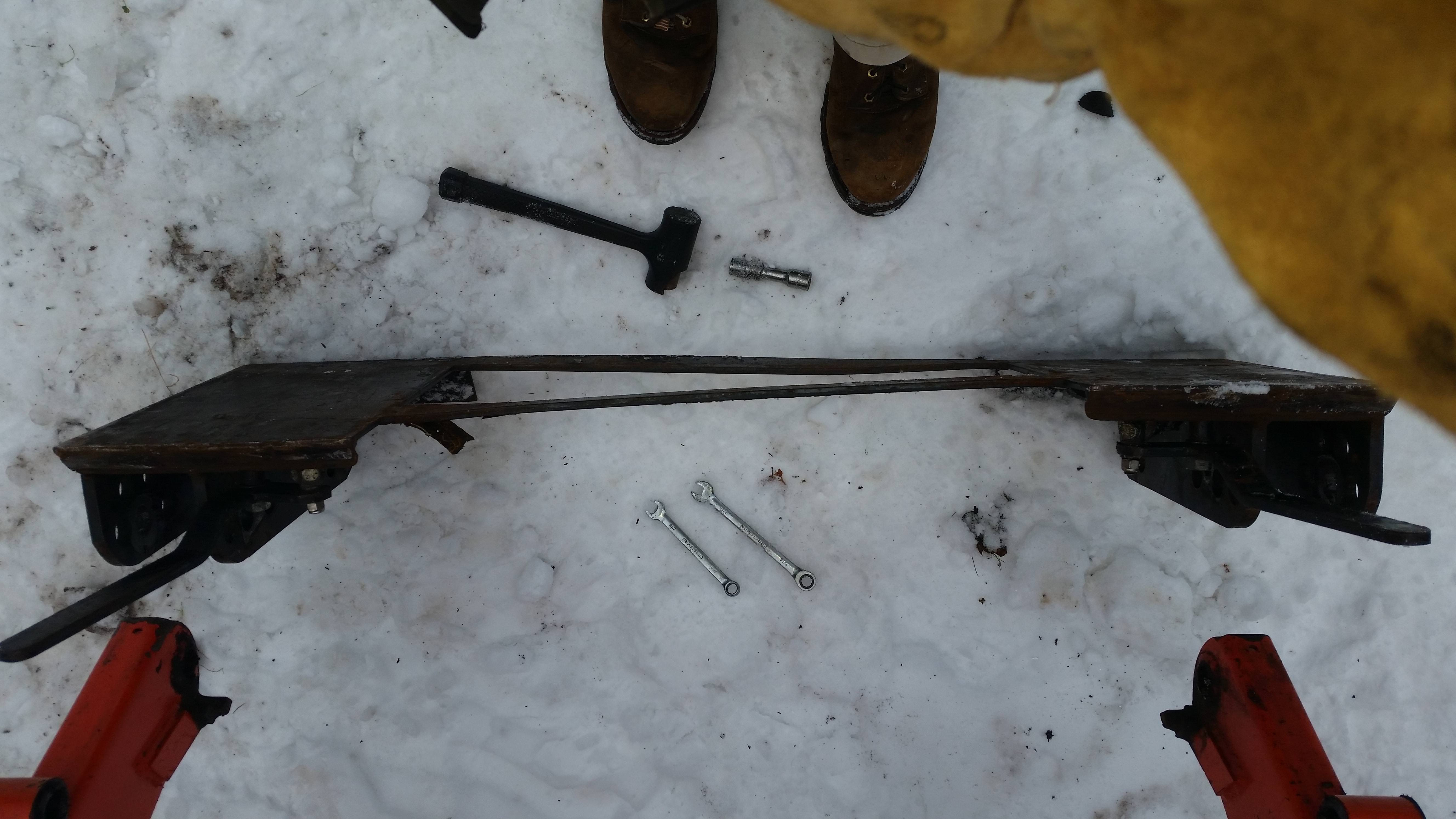

Machine is a 2001 Kubota L3710. I swap between a FEL to bring in firewood, and a plow setup from a truck for snow removal. Running a Kasco Uni-Hitch setup. Its awful. I can't stand it. Came with the tractor when we bought a few years ago. If I had one attachment that stayed on, it'd be fine. But for going back and forth, its terrible. The latch system keeps needing tweaking, the flat bars running from left side to right side easily get twisted. Just a garbage setup.
Suggestions for a new setup? Friend said I can get one for just a couple hundred bucks. I'm not seeing it. EverythingTractor has a setup for like $900. Which is really steep. From what I can see, I'll need the four pin setup, right? That connect right into the loader arms?

This is what I'm dealing with.

What keeps happening? Is it not latching because it is twisted ? If so I'd either plate the whole thing or brace it with tube steel that looks as flimsy as a toothpick now

I just have these two things fighting me. Wasn't until I popped off that adapter that you can see how warped it is.

Yea, its a pain in the *** to latch. One side will lock on, the other is off, then I'm fighting the plow plate flopping over. Then I get snow stuck inbetween the adapter and the plate.

I'd make it square and plat it in between the two sides that's how the good ones are made
   / Skid Steer Quick Attach Setup #12
You should weld a torque tube between the 2 couplers so they stay aligned.
   / Skid Steer Quick Attach Setup #13
Or remove the weak twisted flat bars completely. Before hookup do a full curl up to get the latch plates aligned. Then curl down touching the QA plate, raise up, curl up and latch :thumbsup:.

Look at his first picture, you can see the tweak.

I've never latched one side and not the other completely. Was does happen some times is if the plow flops over I can hook one side (not latch it with the dogs), and pull it back some to get another bite at it. But I don't raise the plow up or anything. I doubt the arms are tweaked, but maybe its a possibility? The adapter plate is definitely tweaked.

I fixered it:
Working fine. Just need to dub with the plow setup so the plate doesn't keep flopping forward.
