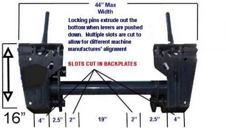

I am making a quick attach for my FEL on my tractor and was wondering if anyone new the specs on it.
I put the pins on 33 inch centers and I came up with 40 degrees for the bottom bend where the pin goes through and 45 degrees for the angle at the top of the quick attach.
I had around 15 inches for the length from the top of the 45 angle to the center of the break in the 40 degree angle.
   / Skid Steer Quick attach specs #2
Does this help any?
Yes that does.
I measured off of my Takeuchi CTL and off of my attachments.My numbers match your picture.
I always wondered if there was an industry standard on these specs?

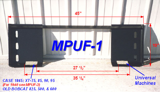

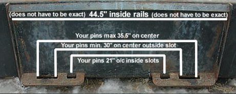

Here are some more.

There is an industry standard on the skidsteer coupler........ someone has posted it here before, but I don't recall who. You should be good to go with the measurements JJ and I have posted though.
They match what I measured on my Tak.
