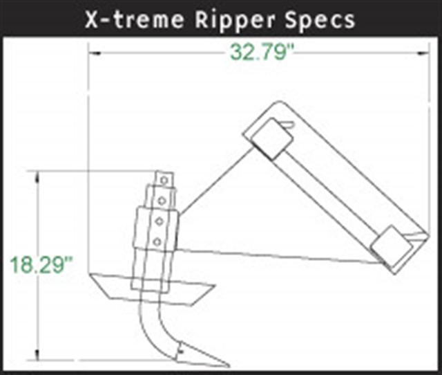

I was thinking of using a subsoiler shank too. That or a ripper for a small excavator. So far, I haven't found any shanks and the rippers have all been too far away and too big.

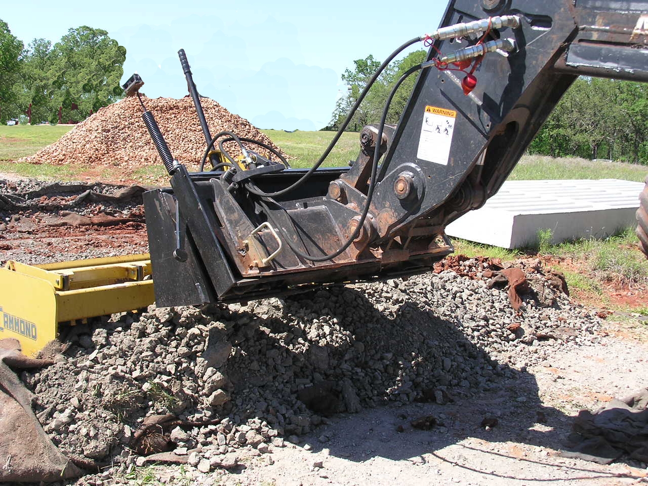

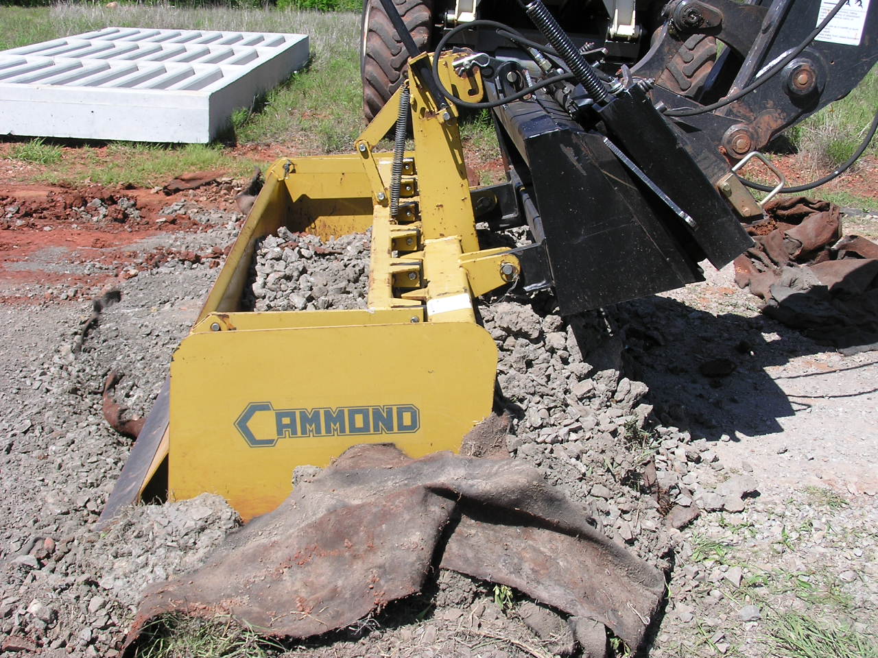

You could buy or build a 3 point to SSQA adapter and try your subsoiler.
The commercial ones are designed to be pulled in reverse, like I do my 6' box blade.

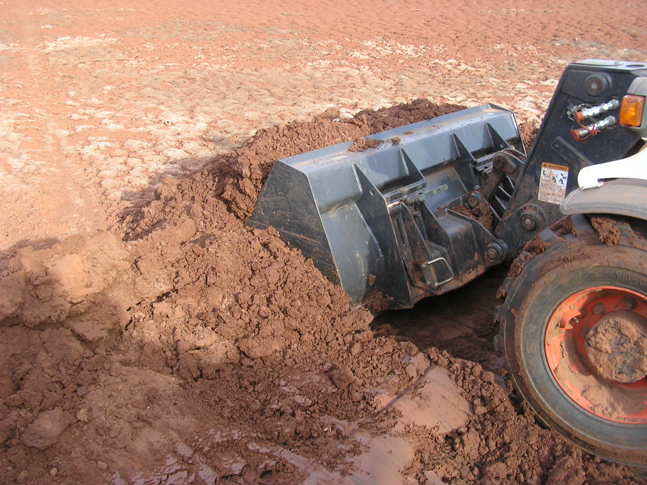

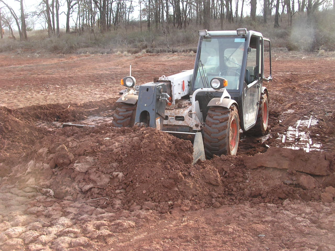

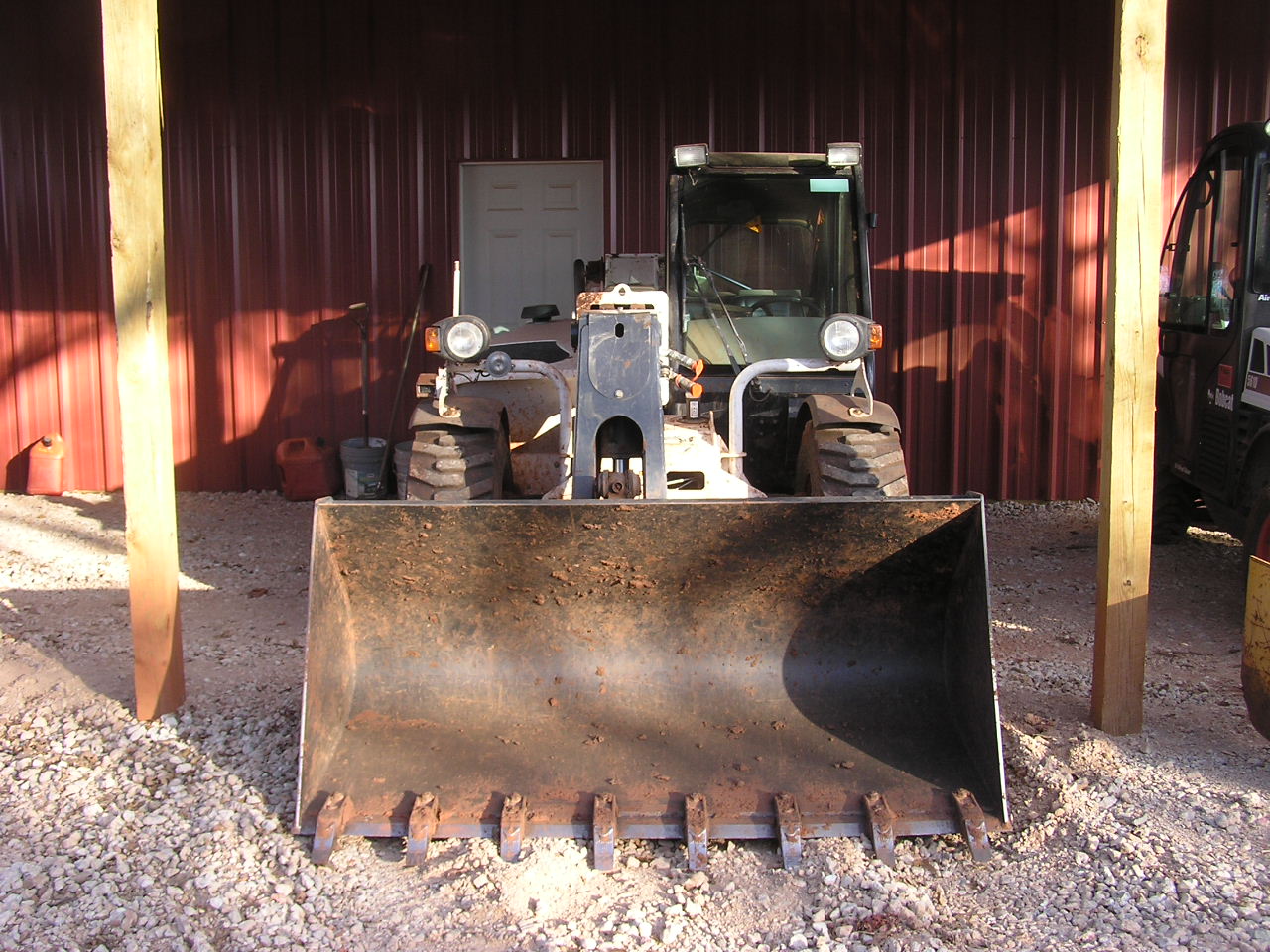

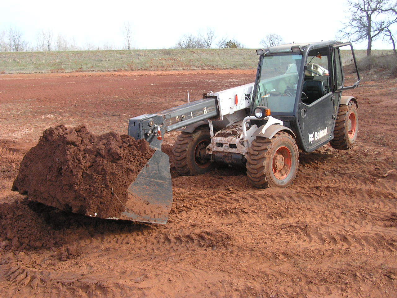

I have teeth on the bucket, it will dig hard clay and sandrock.

Get a tooth bucket or tooth bar for your bucket. :thumbsup: Teeth on a skid steer bucket turn it into an entirely different machine! A 2300 lb. capacity skid steer will dig like a small cat with teeth. That's why they don't make small crawler loaders anymore. One of the first jobs with my new skid steer was digging up a weed invested gravel covered parking area behind a garage. I thought it would be easy digging and didn't take my tooth bucket to the job. Bad mistake, the smooth bucket was useless and I had a dump truck coming with new gravel and to haul the old stuff away. I had no choice but to go home and get my tooth bucket. IT was like a hot knife through butter compared to the totally useless smooth bucket. I ate the cost of the dump truck having to wait and from then on always carried both buckets on the trailer. The customer was great and added $30 to cover some of the extra cost. If you do put teeth on, get the pin on teeth instead of the crimp on teeth. So much easier to change and last a whole lot longer. Putting rippers on the back of your bucket could twist it all to chit. You've got a big skid steer with a lot of power. The buckets aren't that strong in the back like a cat bucket.

Currently have a tooth bar mounted with the crimp teeth. Wish I had bolt-on teeth, but it's what came with the machine. If I ram the machine into the bank or dig with the corner of the bucket I can make progress, but I don't want to break something. I liked the idea of using the subsoiler, but the thing is only 48" wide and too lightly built for this size machine.
