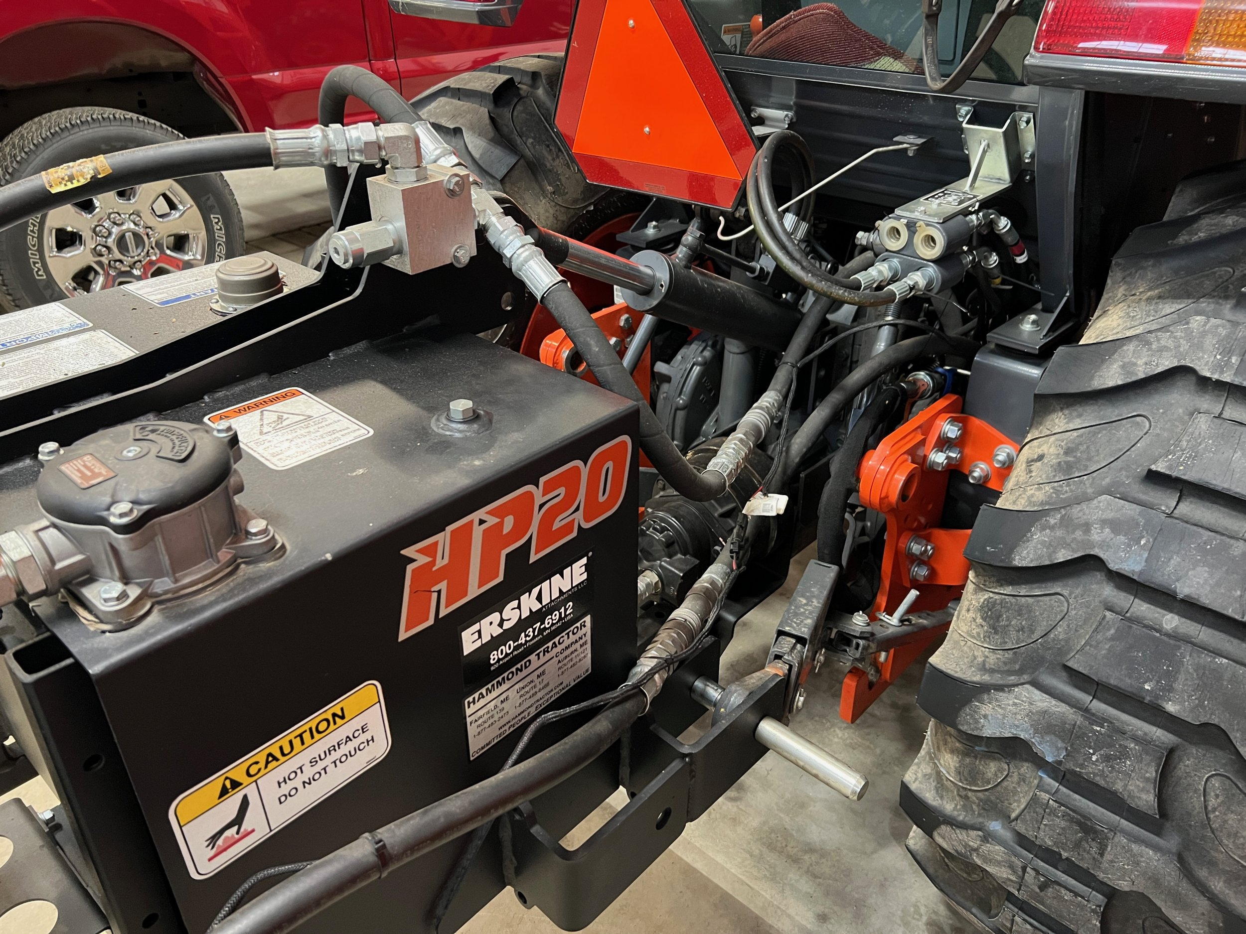

I have the same unit (Erskine) on my Gr L6060. Awesome blower. The only thing I don't like is the way they mounted the hydraulic pump on the rear PTO. The pump is very heavy (my guess is 80LBS). It is very hard to install by hand. I am in the process of building a small lift to help with the process. Once mounted, this is a serious snow removal machine. The places I use to keep the snow blown off just in case I might need to get to them, I don't worry about until I need to go there and then I just blow a path to the building or shed. When I bought mine I didn't get the electric cooling radiator. The MFG said it wouldn't be necessary using it in the winter. The oil in the tank will get very hot even in the winter. I did end up installing the cooler. Keep a eye on the temp of your oil in the tank. If I remember right 180 degrees is getting close to damaging seals. Enjoy your hydraulic blower.

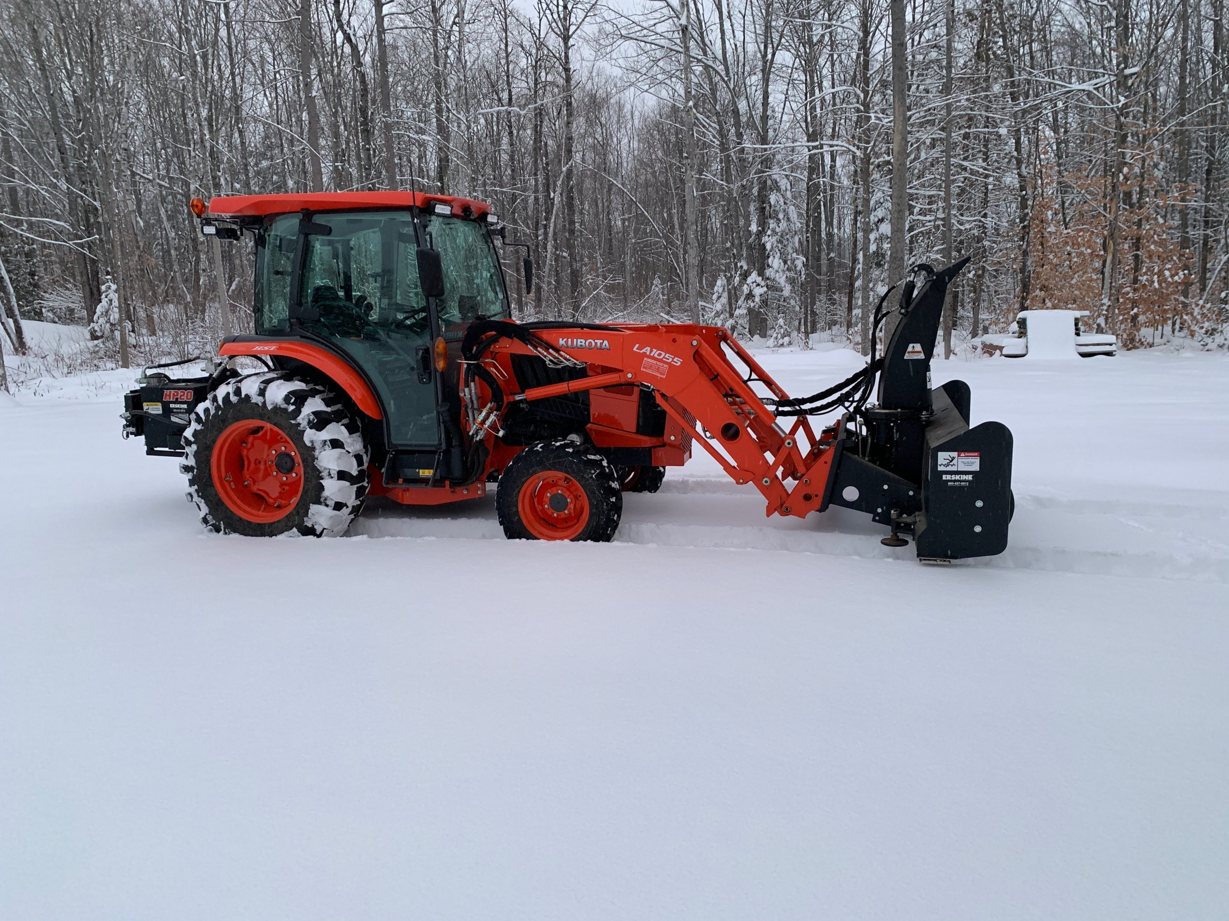

Looks like the same unit i have…or at least real close.

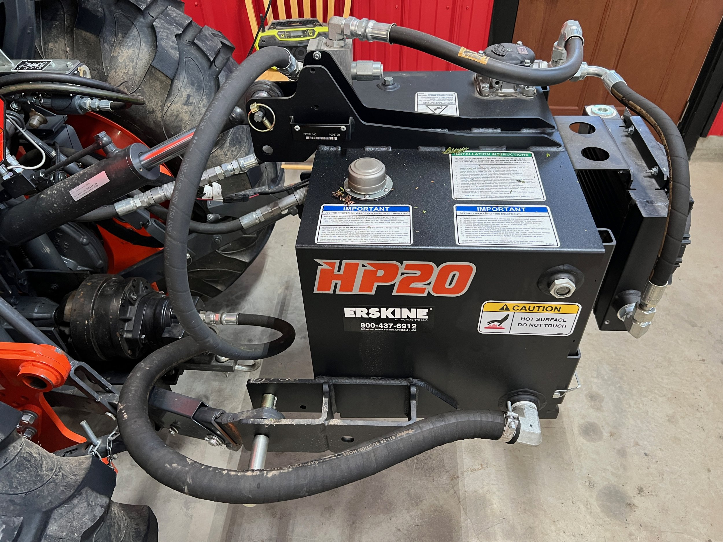

It sure does. Maybe you have a smaller power pack? I can't quite read the model, but maybe HP15? How does it all work for you, and any operational tips? Mine does not include the skid shoes and I'm pretty certain I'll need to add them since my road and parking area is all gravel. Also, do you have the fan cooler on the power pack? I'm expecting I'll need to add that to mine, but will try it out for a while first.

Thanks. You answered one of my big questions about the cooler. I'll go ahead and get one ordered. The manual talks about the duty cycle without a cooler, and of course the ambient temp. With a 1/2 mile driveway, I need 100% duty cycle.
I recall your comments earlier about the effort required to get the pump mounted. I think today I'll start with mounting the HPU to see what I've up against.

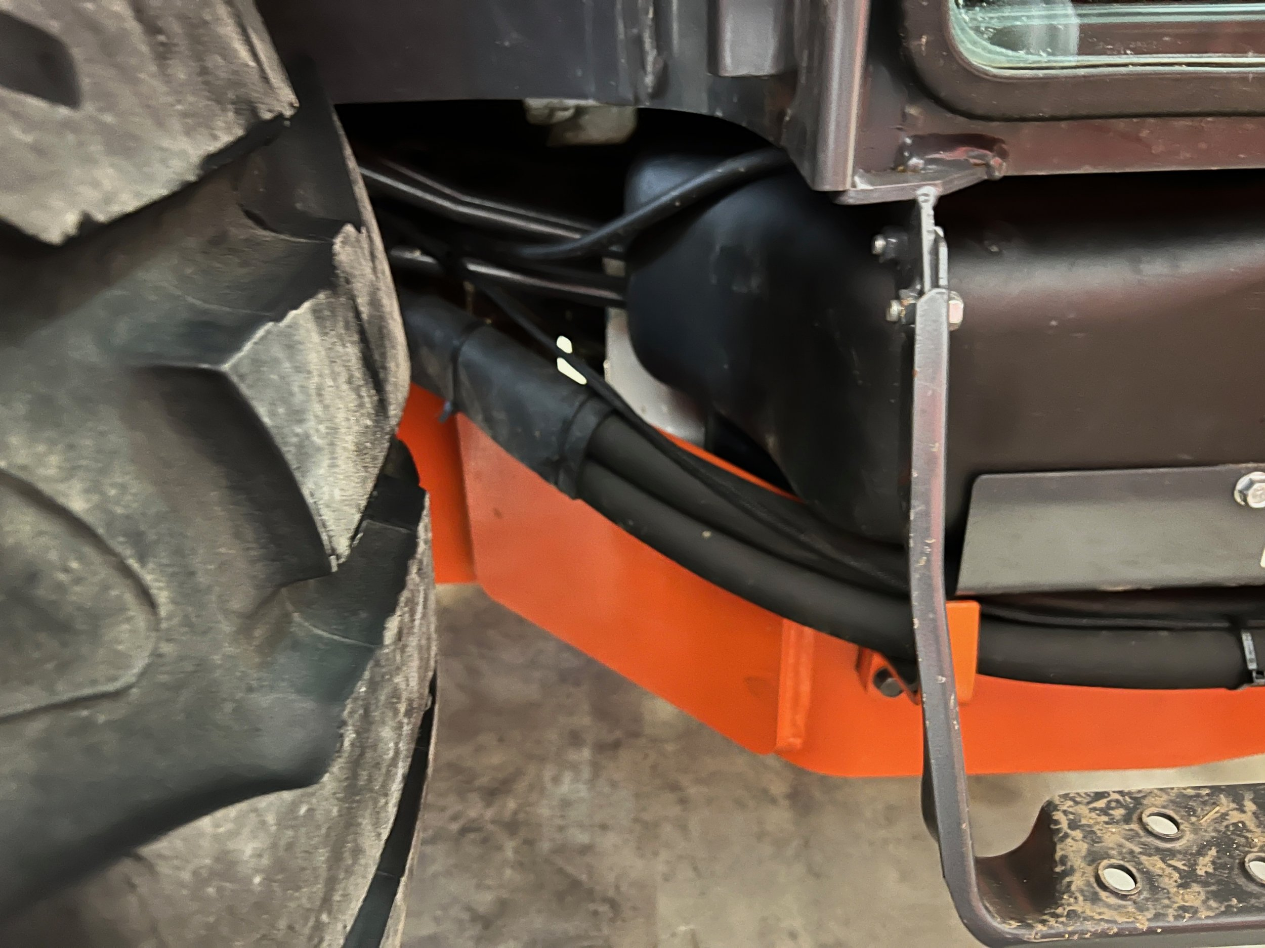

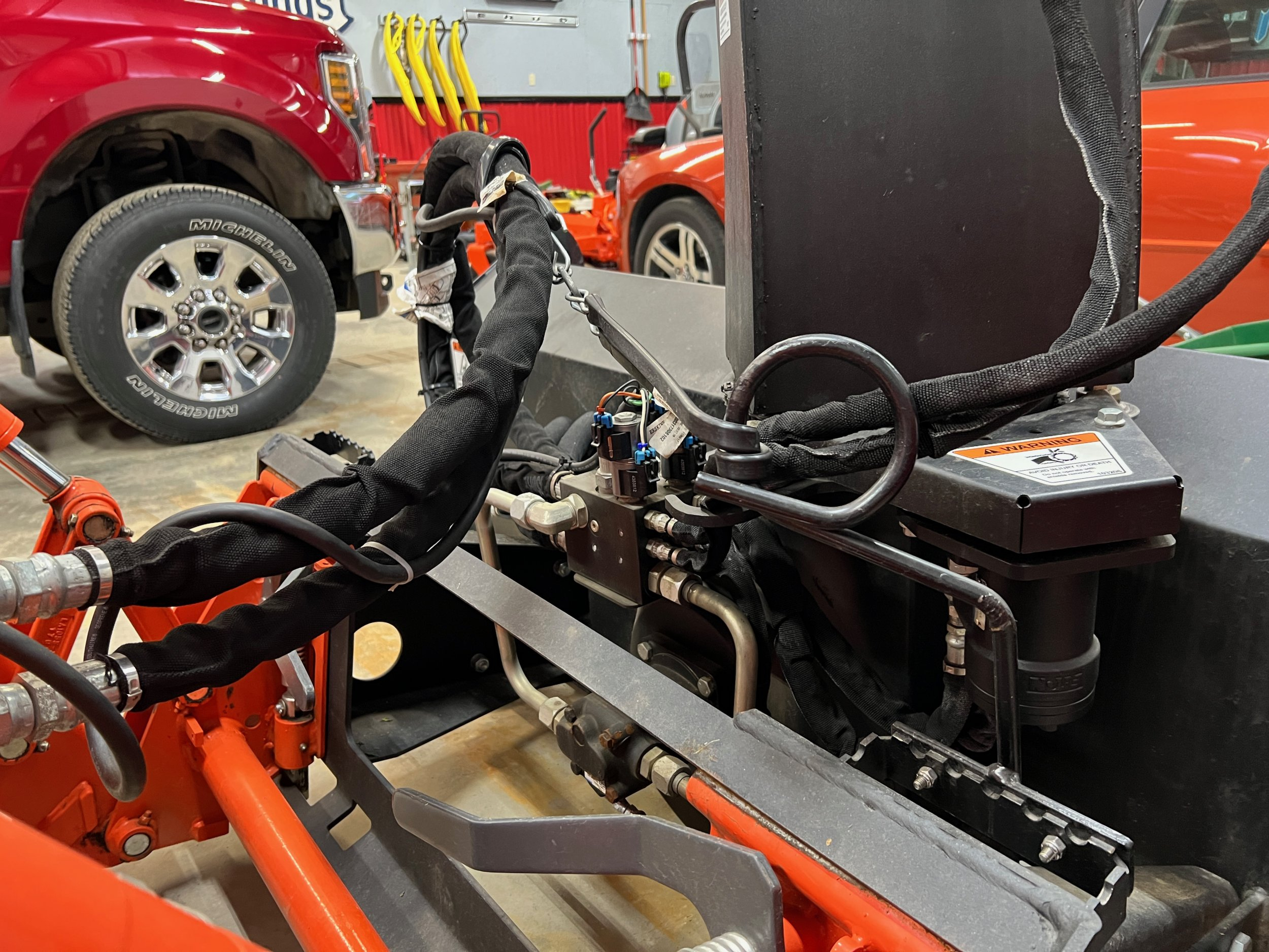

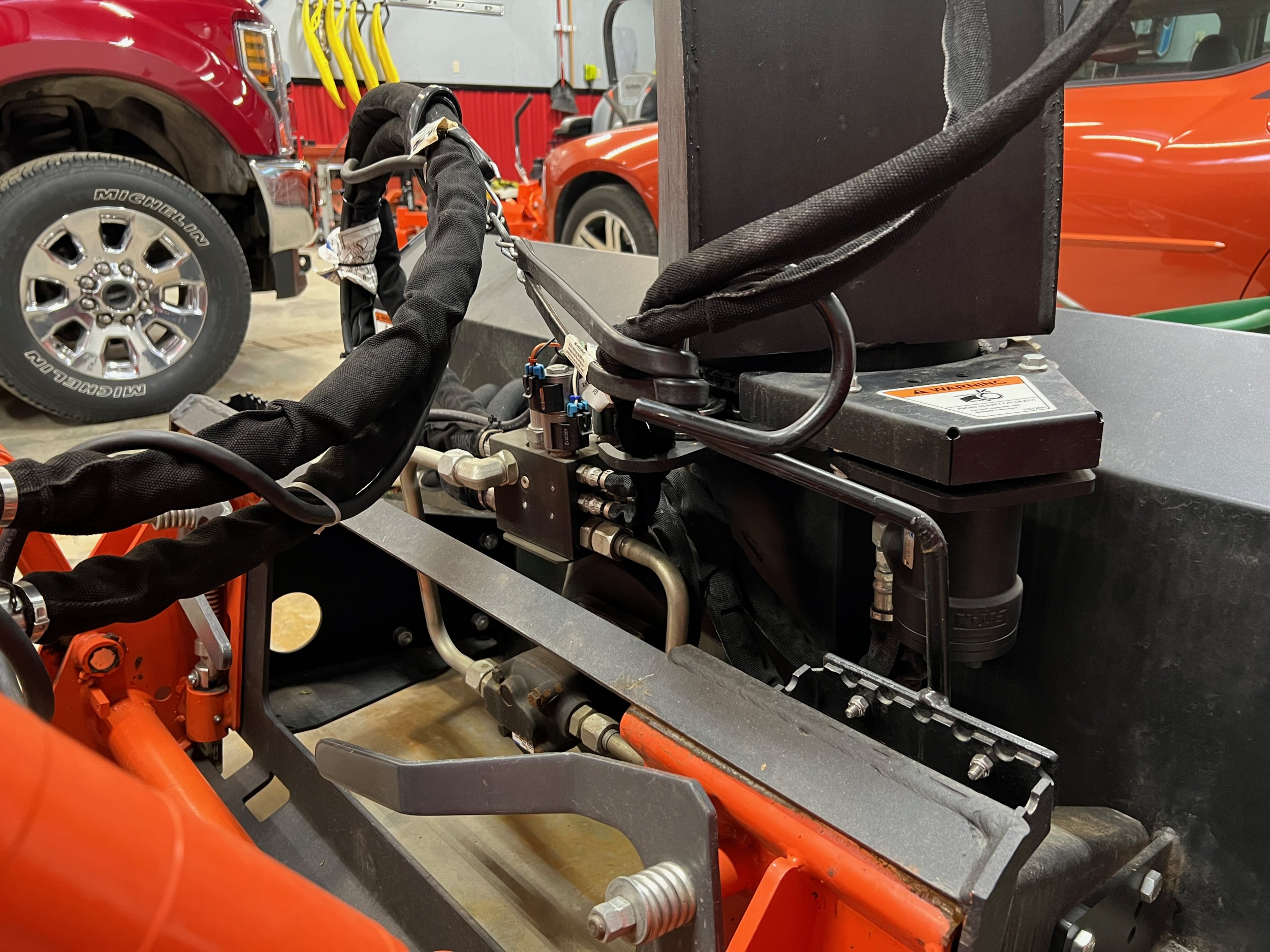

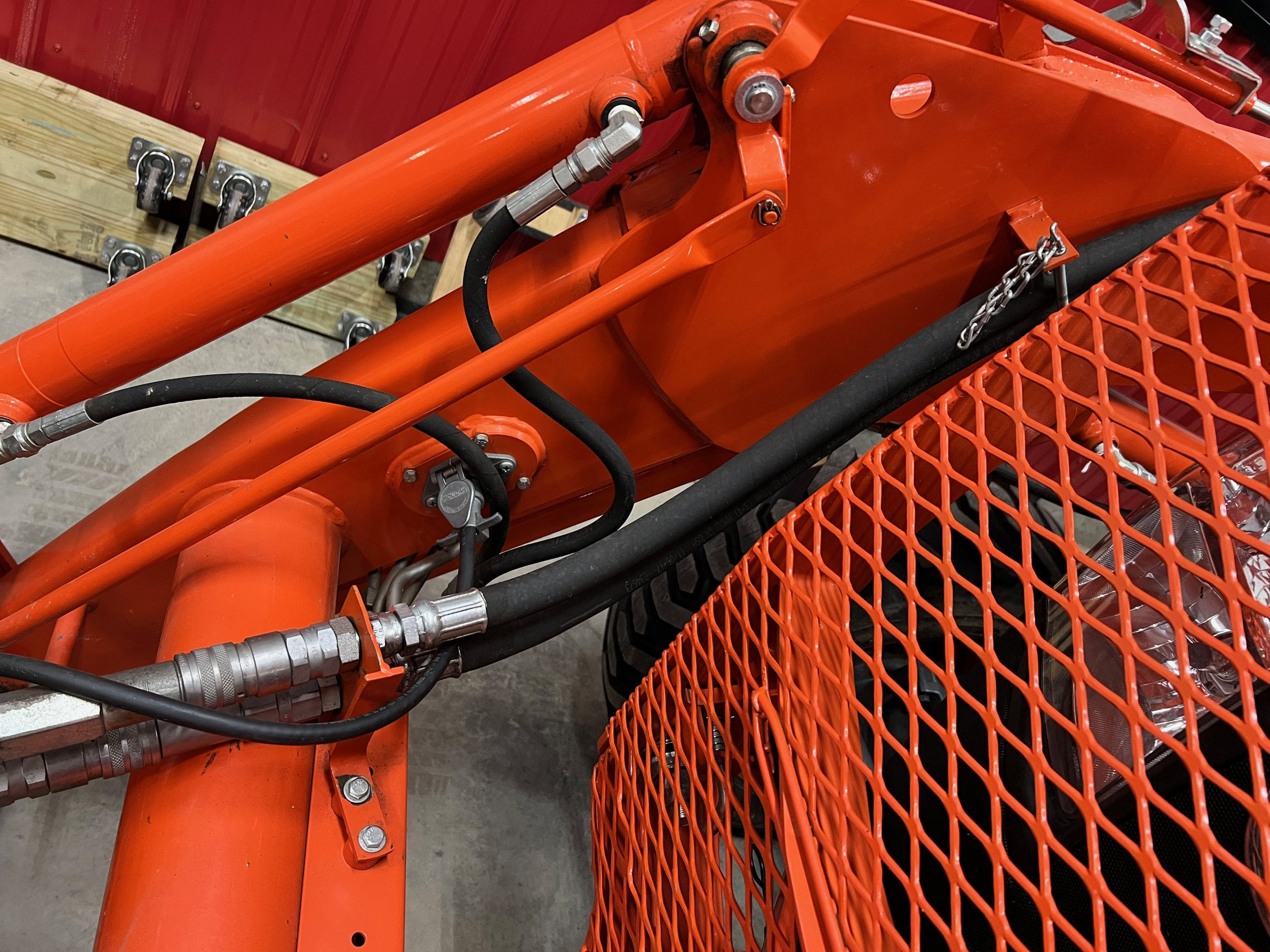

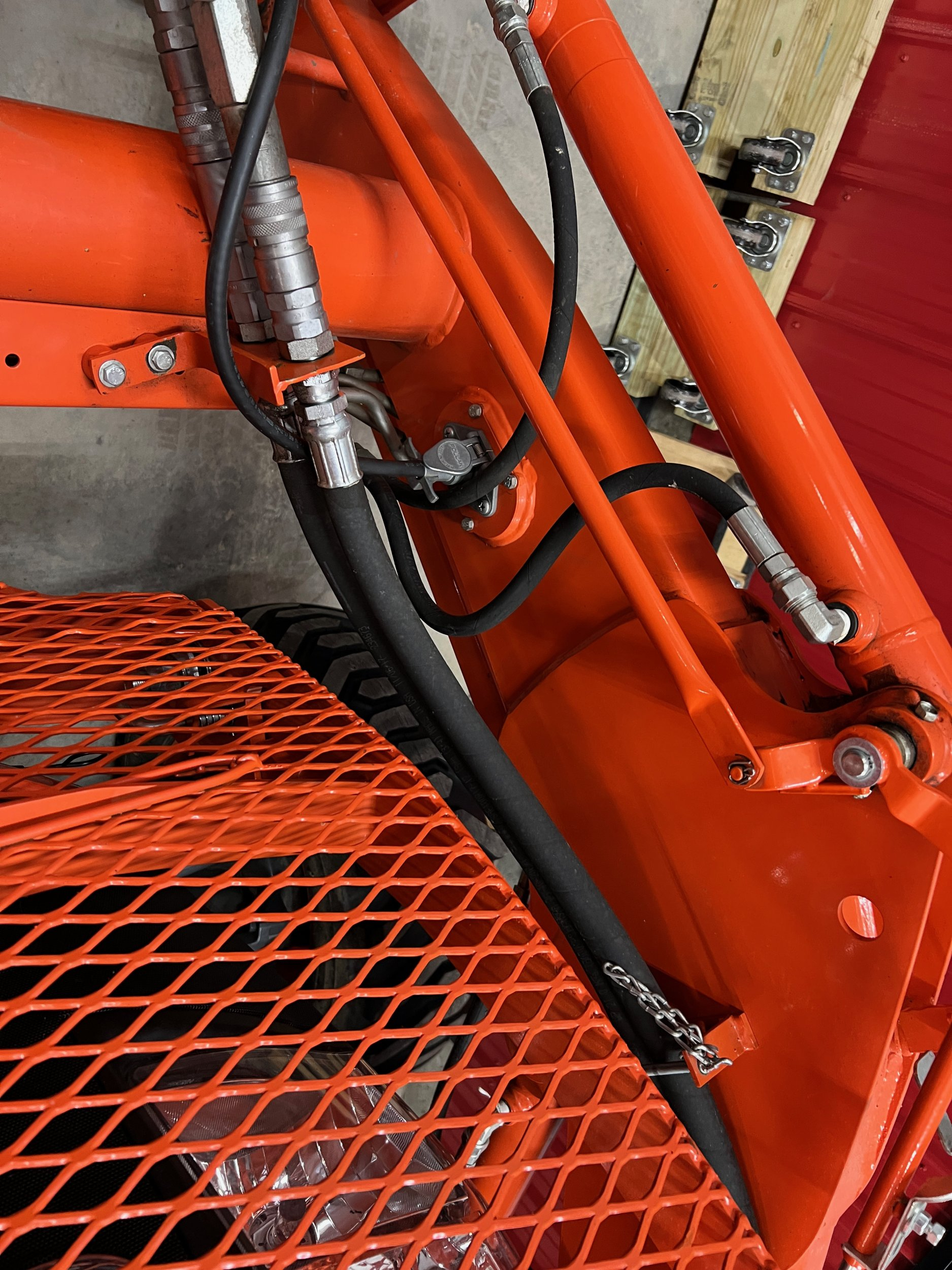

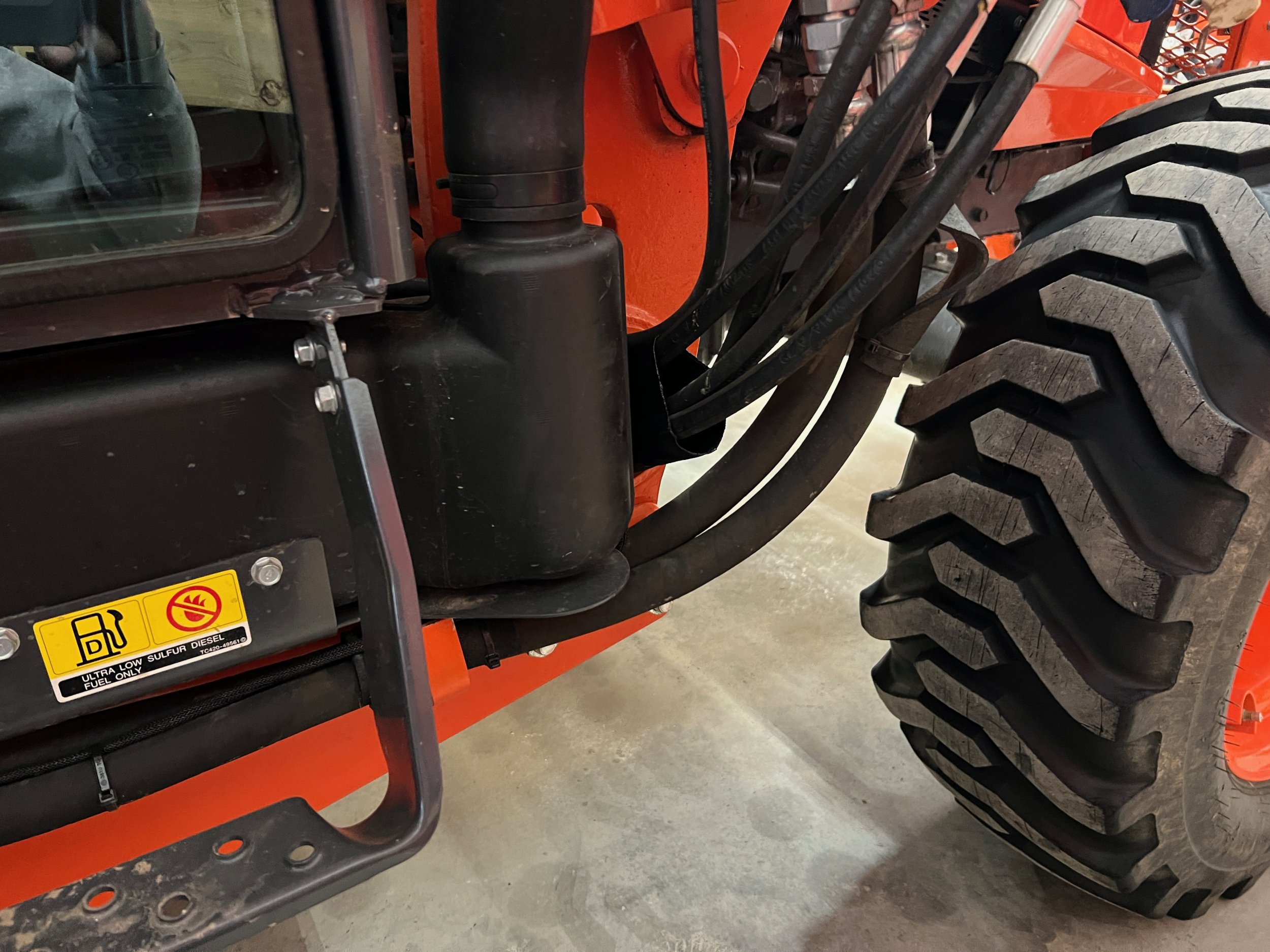

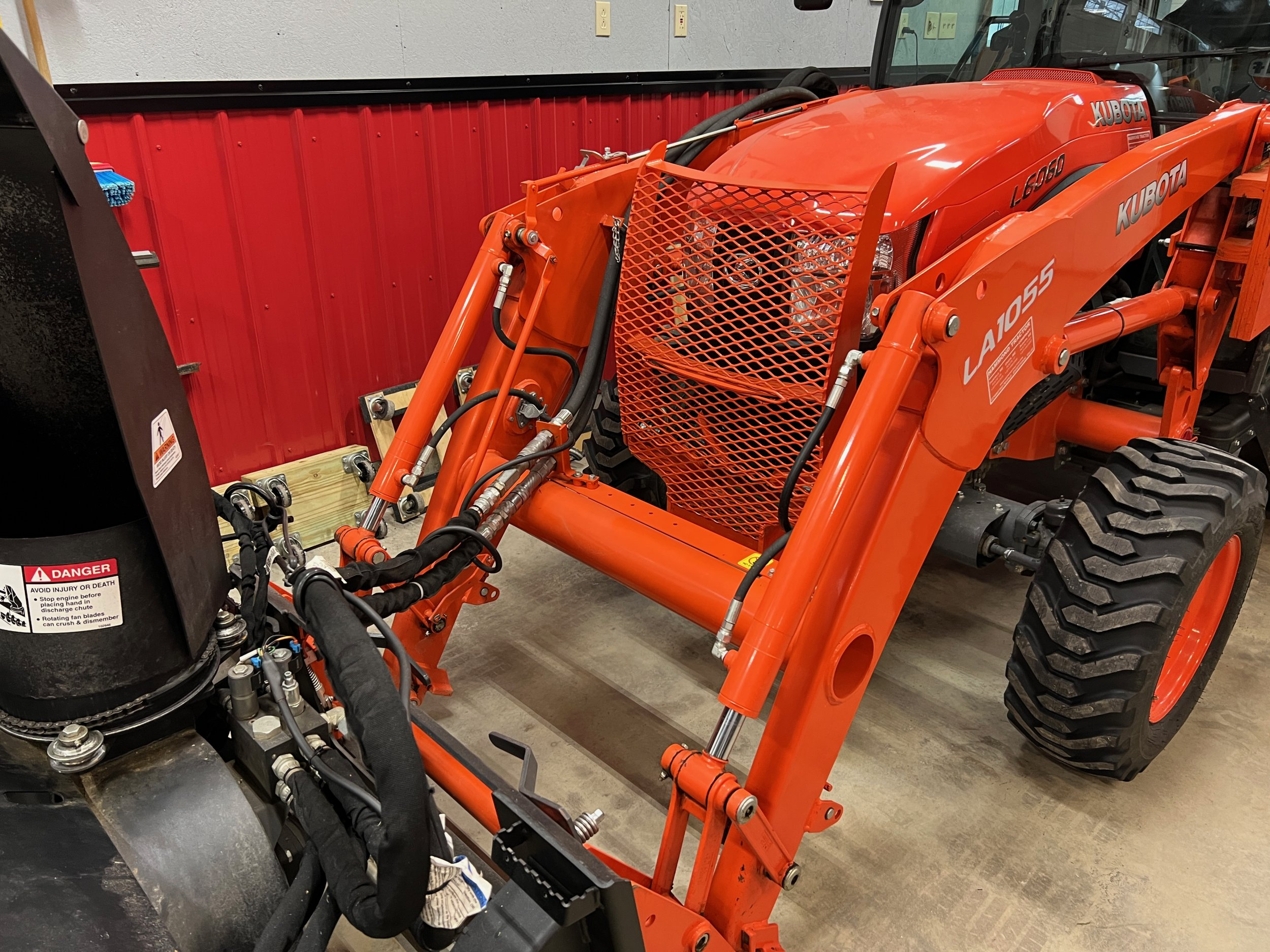

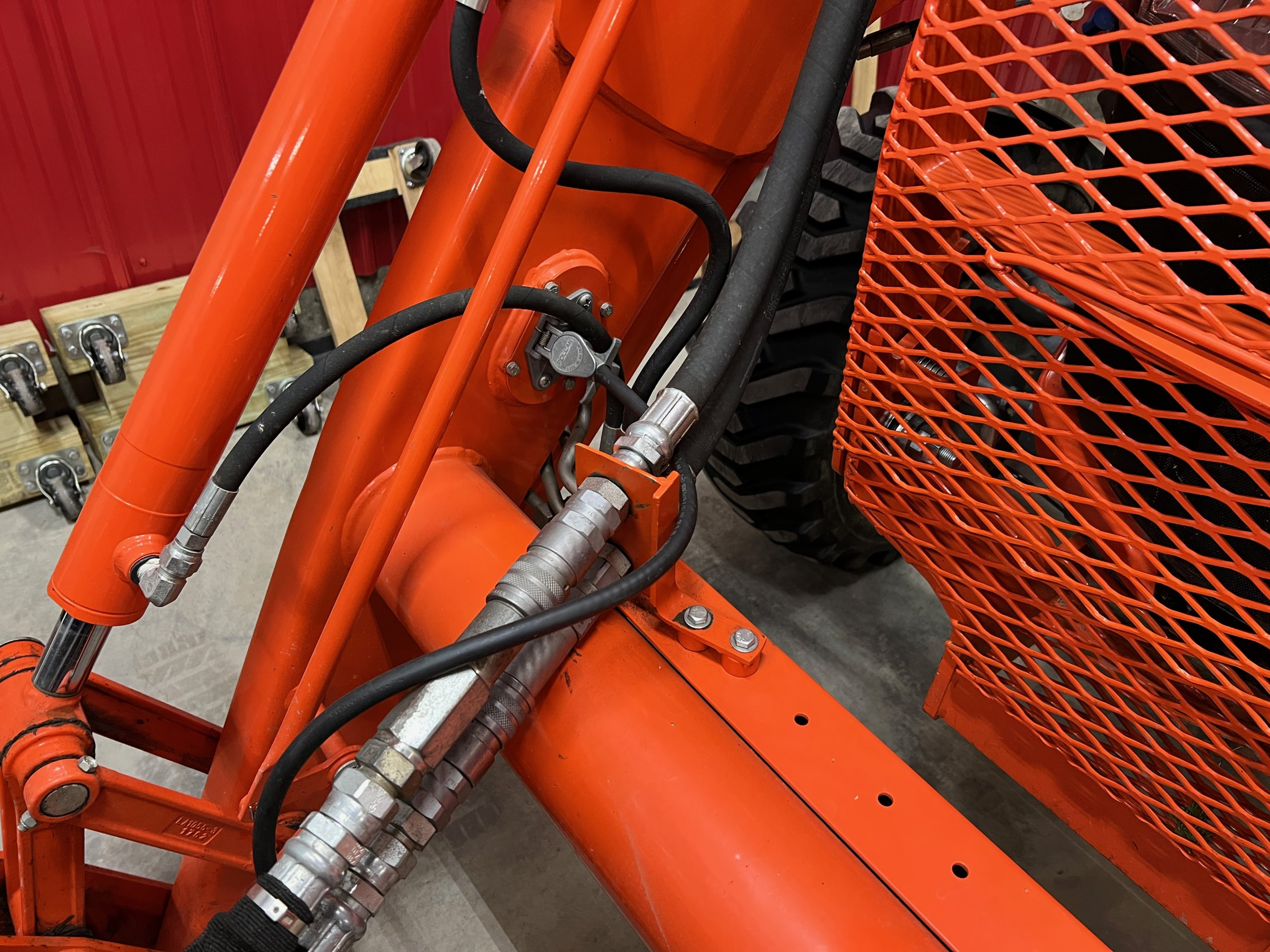

Any chance of getting some pictures of where/how you set up the hydraulic hose ends on the loader and by the 3PH? I'm assuming you leave the hose run permanently installed, and just connect/disconnect the HPU and blower? That's what I was planning on, but I haven't gotten into it yet to see how practical it is.

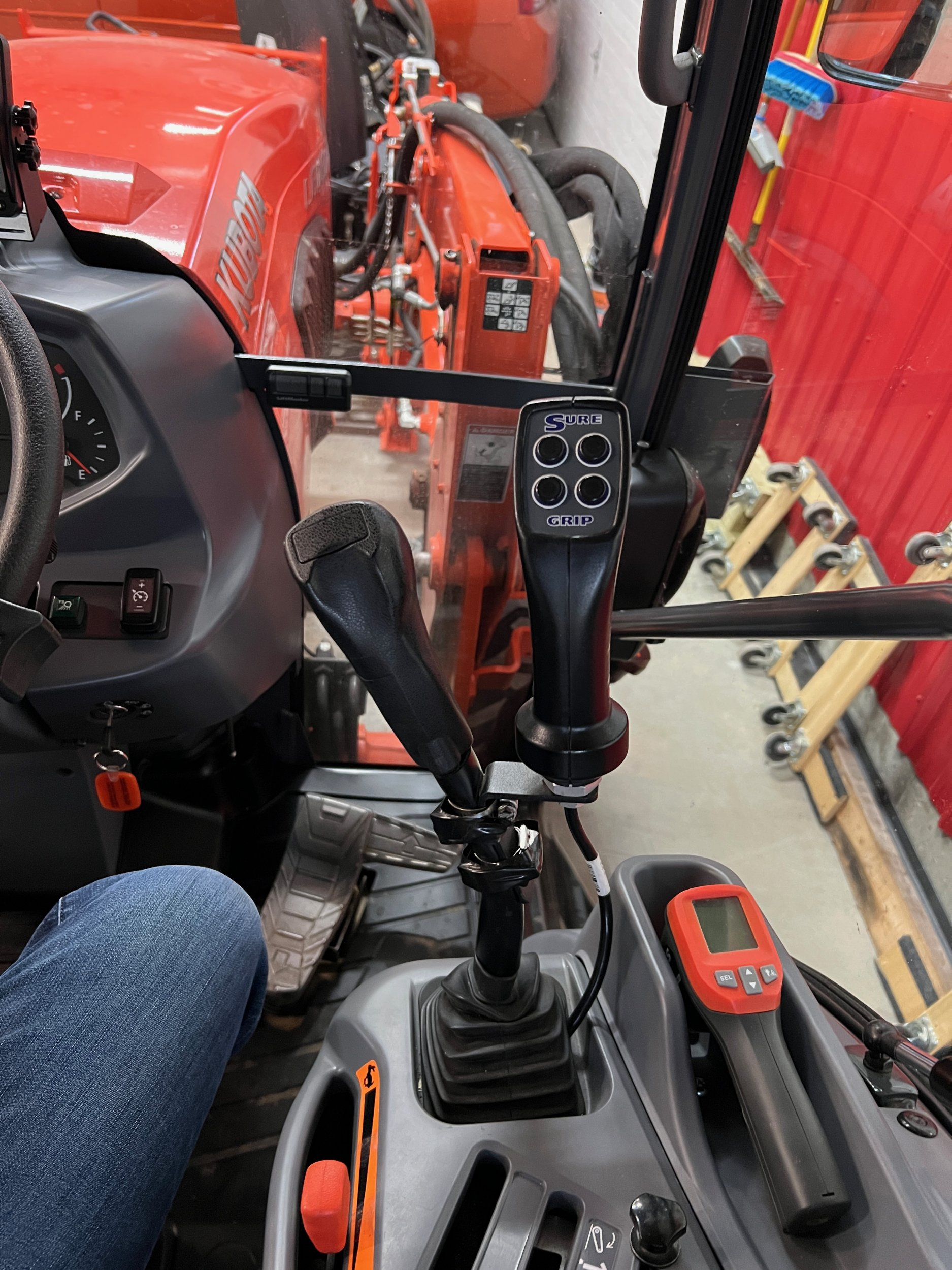

Ive used mine for 10 years without the cooler. I used an ir heat gun first 3 years, never had any issues with heat.

And yes, that pump sucks to install. An it vibrates some while in use. I was going to make up some sort of mounting bracket on mine to facilitate install and prevent vibration….. if i ever get some time.

Interesting. The power pack manual says that cooling, and the resulting duty cycle depends greatly on whether you are using the 15, 20, or 24 GPM pump. From 0F to 40F they say the 15 gpm HPU has a 70% duty cycle, where the 24 gpm is only 50%. I ordered the cooler, just in case.

I'll get you some pictures in the next couple of days and post them here. I'm also making a small lift (for lack of better word) out of a trailer jack. To help with the pump install. After it's done (and works) I'll post some pictures.

but i seriously never pay attention to that. i kept an eye on heat for first few years, than stopped worrying about that. it never got hot.
but pay attention to the 2 hose connection points inside by the auger. they have a tendency to loosen up, and when they do you will leak hydraulic fluid. luckily the fluid i use tends to leave a very bright yellow..almost florescent, drip when that happens. i usually have to re tighten they a few times a season.

Here are a bunch of pictures. if you need anything more specific just let me know.

   / Skid steer snow blower on tractor loader? #110
A couple more
