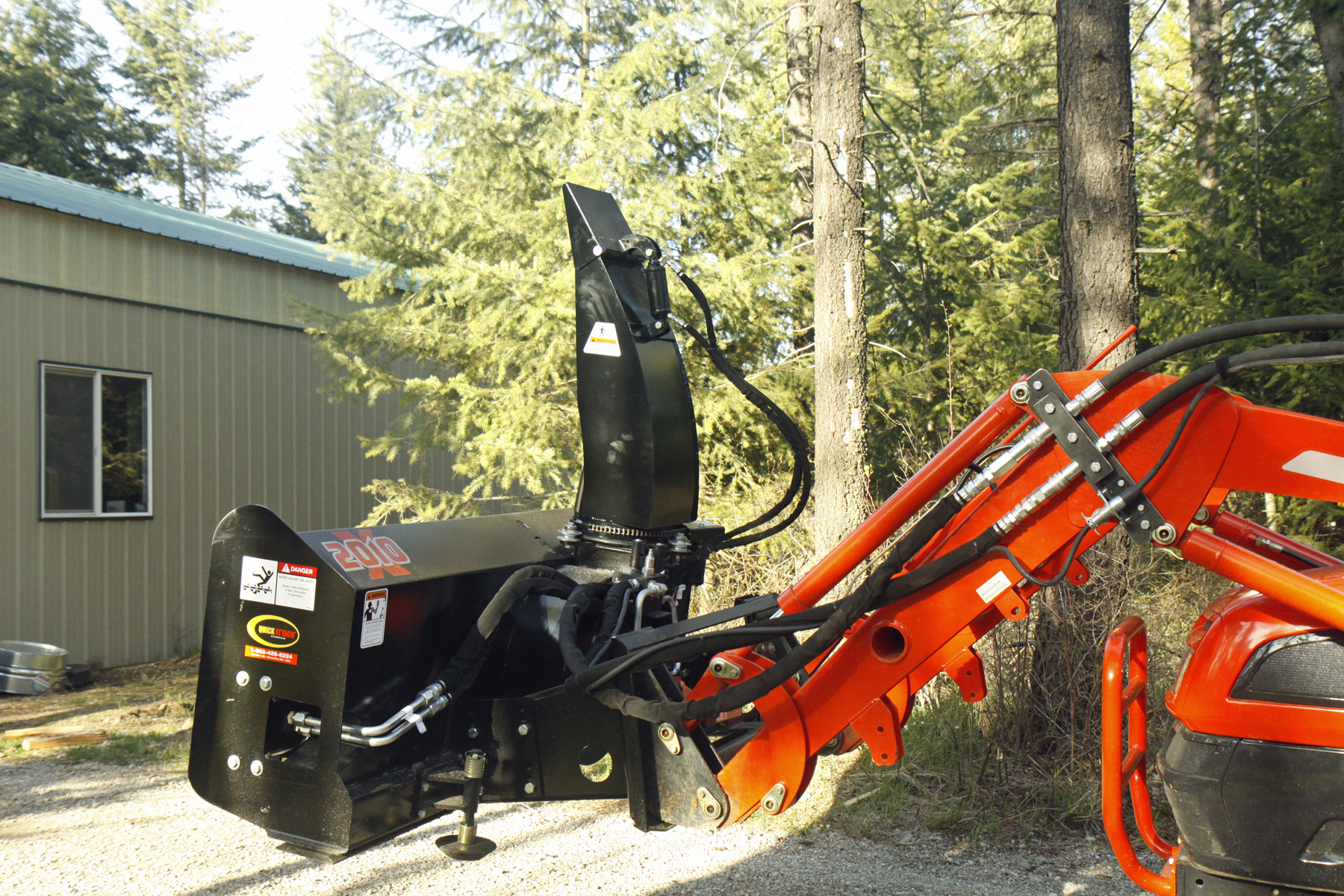

A quick update....
We got about 8" of snow yesterday so I got another chance to exercise the snow blower. After getting all the initial issues sorted out, I remain very pleased with the machine. Clearing up to 6-8" of snow works great and the tractor (50 HP PTO turning an 84" hydraulic snow blower) has sufficient power. In deeper snow it could really use more power, but with an HST transmission I can just go slower to keep from bogging down the engine too much. But under any condition, the snow blower is the heaviest load the tractor gets, pretty much running at full power/load the entire time I'm using it. I basically regulate speed to keep the RPMs from dropping too much.
I really like the power deflection control. I didn't have that on my last blower, and I think it's a good example of not appreciating the value of something until you actually use one. It's really nice to have full control over where I put the snow.
This machine throws the snow just as far as my previous 74" 3PH blower.
I've adapted pretty well to having less steering traction. Gentle turns work unassisted most of the time. When the wheels start to slip, most of the time I can correct by some combination of slowing down and/or a little brake steering. Worst case I need to stop and back up a bit to get a new angle, or lifting the blower a bit to transfer some weight from the blower to the front wheels. At this point I probably won't both with front chains.
With the oil cooler, oil temps hovers in the 95-115F range which is great. I do have one side effect from the way I wired the cooling fan. If the fan is running and I turn off the tractor, the fan becomes a generator as it slows down and backfeeds the tractor electrics and the engine keeps running for a few seconds after turning off the ignition. It's an odd sensation. It's fixable, but I haven't dug in to figure out how to best do it.
I REALLY like the extra width. I can cut back the sides of the road further without getting the tractor too far to the edge. I can also now reliably clear the road in a single pass out and back. With the old blower there were stretches where I needed to make another pass the get the full width cleared.
And I REALLY, REALLY like operating face-forward. That was the whole motivation for going down this path in the first place, and it's a big Mission Accomplished! My back likes it, my neck likes it, and my ass doesn't get numb leaning on one cheek the whole time.

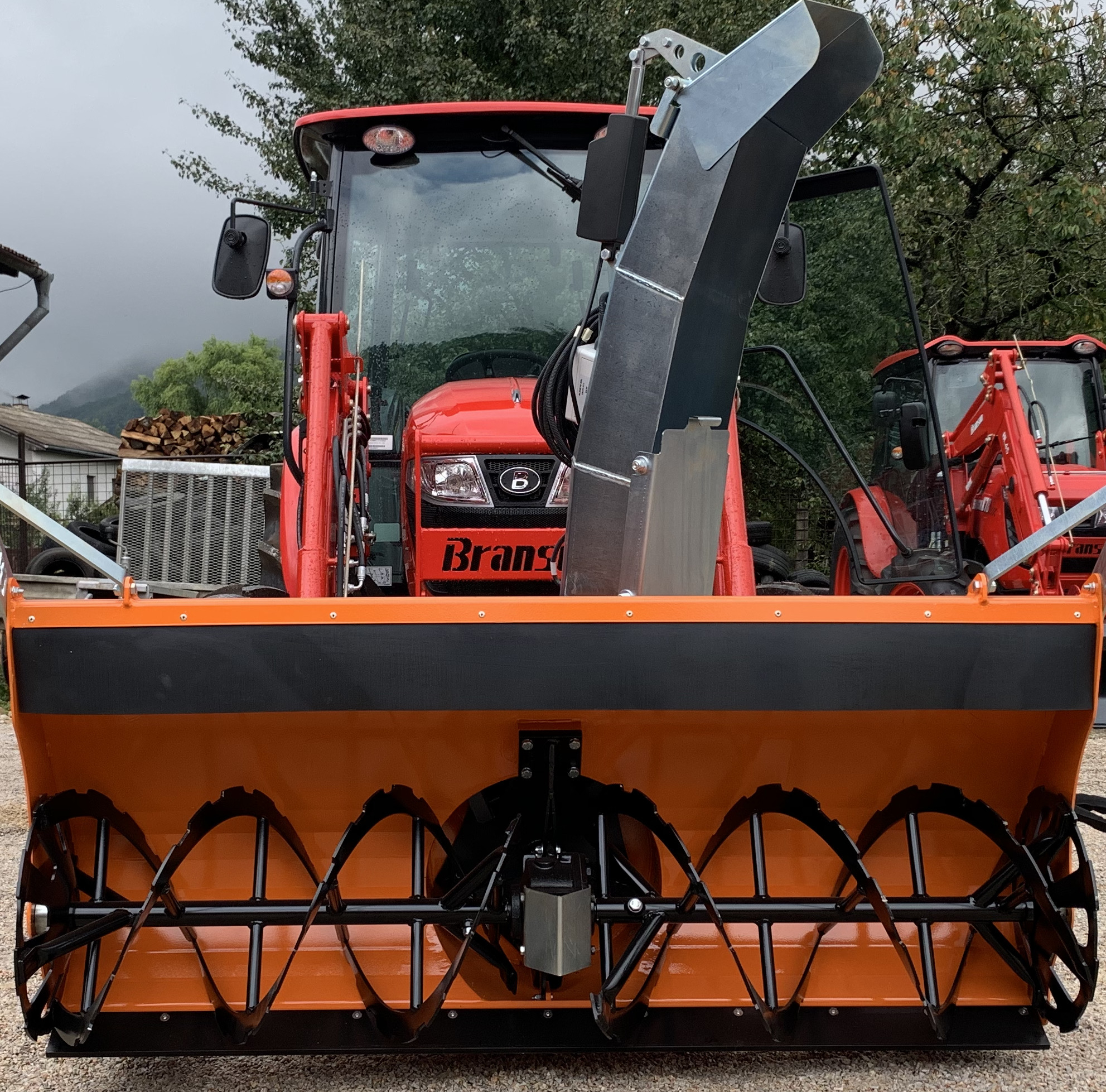

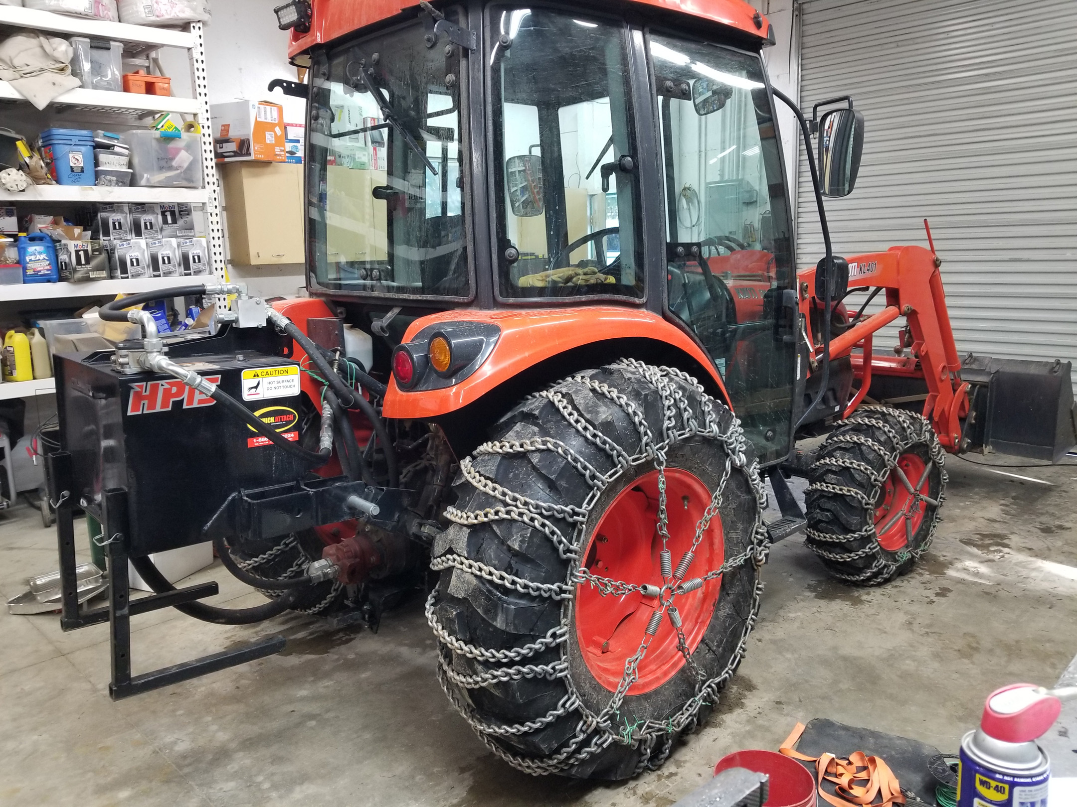

Sounds about where I would like to be! Update on the search - I keep finding machines exist that I have absolutely never heard of before. On the blower front, it usually ends up finding (after a LOT of searching) that they are way out of my price range. But after thinking I might need to upgrade the tractor to somerhingcwith a bit more grunt, I was looking at Branson tractors. And li and behold, the Branson dealer includes a blower option - front mounted and with hydraulic power pack. Found out it’s by Cerruti (Italian) and seems ok. Perhaps a tad narrow at 1.6m, but previous chat re power available makes me wary of being too greedy. All sounding positive, until I finally got a photo of the pack. The tank looks tiny! Found out that the pack is not by Cerruti, but locally made for the dealer. Blower needs 80l/min and the tank is 35l!! But they’re offering it delivered free (2hrs away), ex demo €2k discount, and willing to bargain re enlarging the tank. Sounds good to me. Think I’d put the tank above the pump, but we’ll see. One point, there doesn’t seem to be a pressure relief valve at the tank end, although there’s a small hose to the bottom of the tank, as well as the big suction hose. Might it be a prv from somewhere further forward? I haven’t seen the machine yet, so don’t know. Other half says get it delivered and save best part of a day, €30 of fuel. And if it’s no good send it back. If it’s only a new prv and tank rebuild over the summer, we’re up on the deal!
