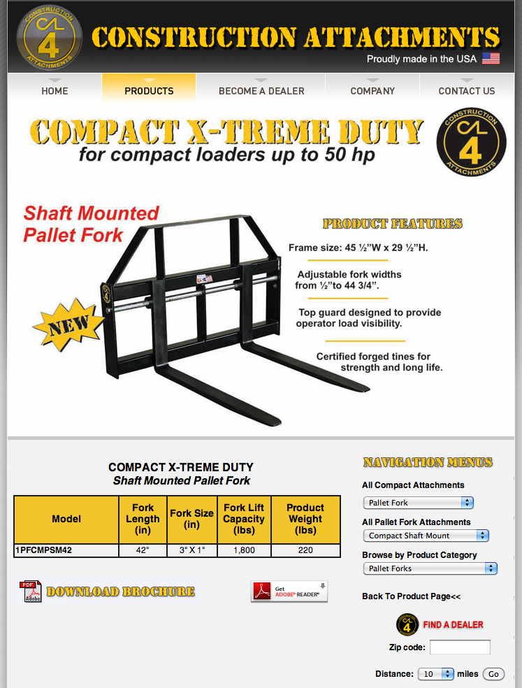

btw, check out these forks. IMO perfect size for size tractors being discussed. I had my dealer order them, but I believe construction attachments also sells them online. There is also another brand very similar in price point and design. Also, this is the older sliding rail design, which I have, they do not 吐all forward when you tilt frame forward...which is a good thing. However, the new design has the notched positive stops. Anyway, good luck in your search.

Anyone know what the Kubota pallet fork with, let's say, 42" forks, might weigh? I see the Construction Attachments forks that Tompet flagged weigh 220 pounds. Would be nice to compare.
I couldn't be quite clear on the CA web site; do their compact X-treme forks for compact loaders come with the option of the SSQA or the Kubota QA? And does anyone have a weight for the standard LA504 bucket; mine measures 58" ID so assume it would be considered the 60" bucket? If the bucket and pallet fork are not too much different in weight, and the Kubota QA is only in the 30 lb. range as CDN Farm Boy noted above, there would not be much loss of lift capacity if I stay with the Kubota system, plus wouldn't have to modify my original bucket, correct?
Forks shouldn't be more than 60-70# each, not sure on the size they use, but I have a pair of class 2 forks (like new, for sale, probably rated for enough weight to pickup the whole tractor) that are 42" long and they are around 80-90# each.

I found one post that said shipping weight of 341# which includes the pallet but I also found several listings that says the 1659 frame is discontinued. My forks weigh 80# (yes, 80) for the whole thing. Moving them by hand or the standard 60" bucket, I'd guess the bucket to be double that, 200 # at most.
