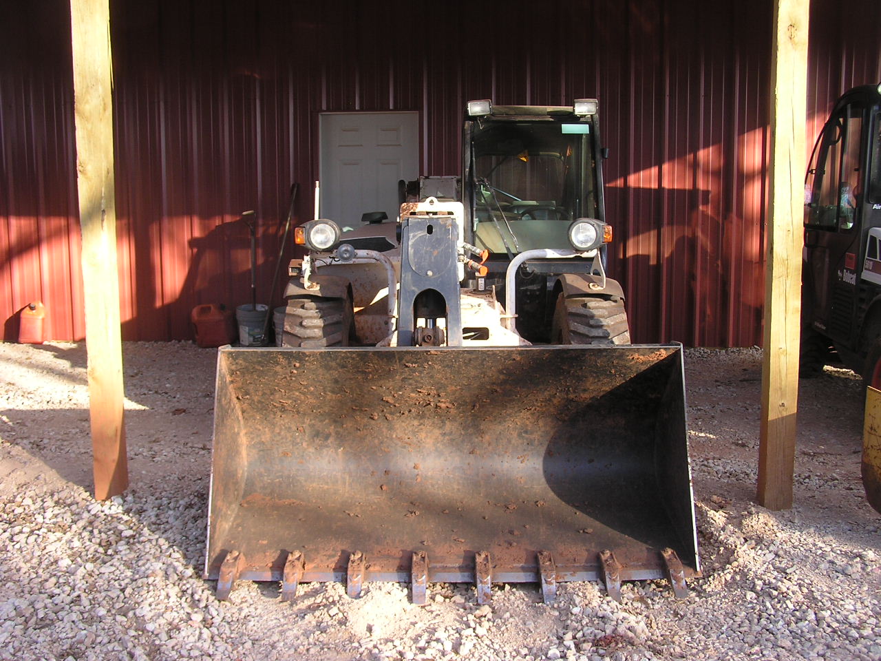

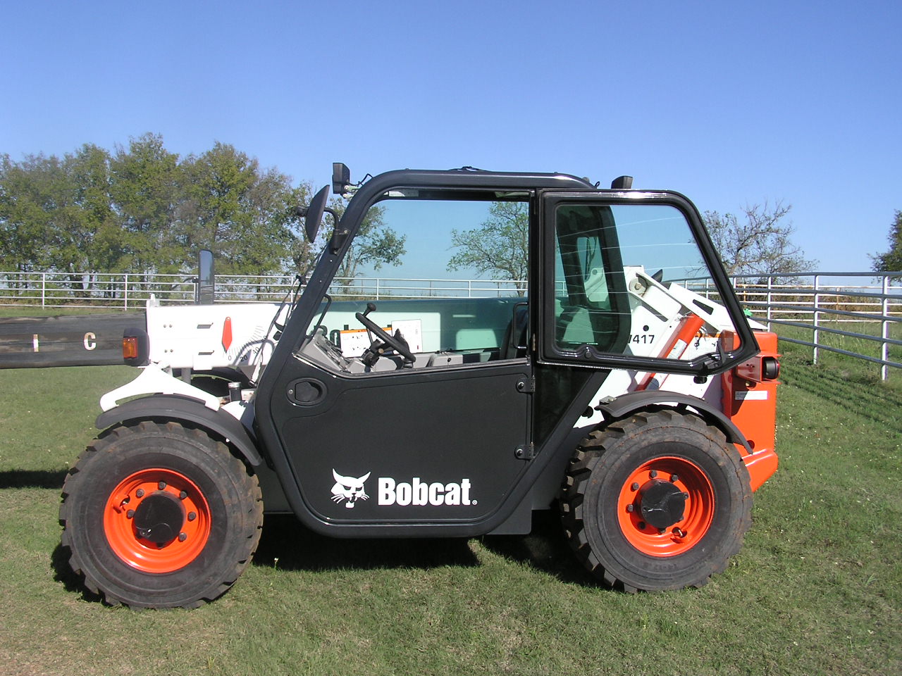

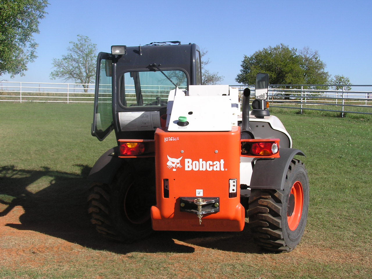

There is a machine that will do what you need done. It is a Compact Telehandler. there are several companies that make them. Mine is a Bobcat V417, it is 6' wide, 6.5' high and 13' long. Tire size is 14x17.5. Top speed is 15.5 mph, drawbar pull is 7,000 pounds, boom breakout force is 6700 lbf, bucket breakout force is 4700 lbf and it will lift over 5,000 pounds, 17 feet high.
It has a skid steer quick attach plate on the boom.
Great for moving round bales.
It is much easier to get in and out of than a tractor or skid steer. I sold my MF240D tractor soon after I bought my first Compact Telehandler.
We live on 80 acres and have 4 horses.
More pictures and what it will do: http://www.tractorbynet.com/forums/...t/160568-compact-telehandler.html#post3243370
