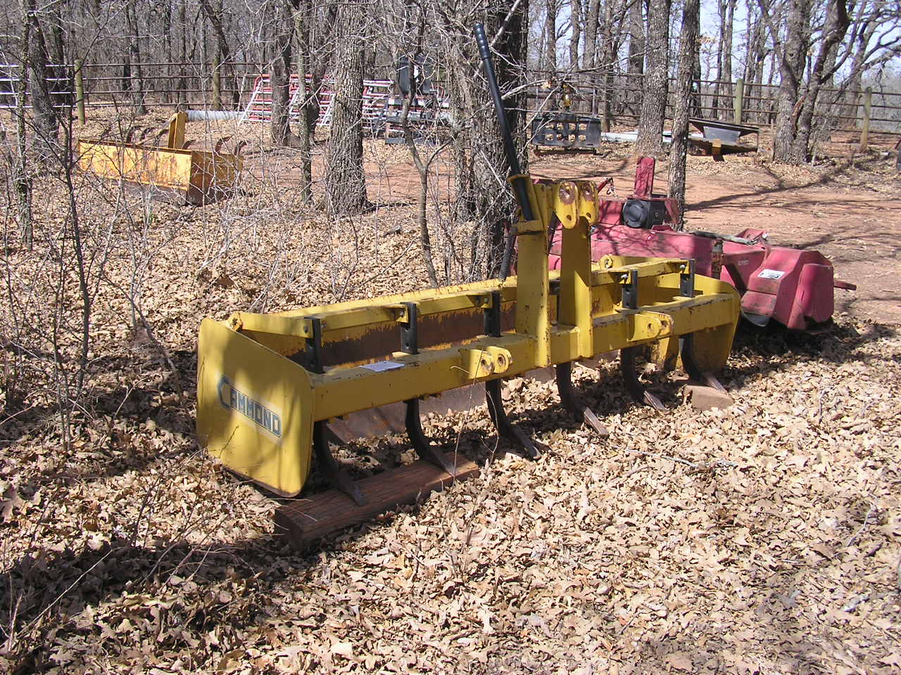

box blading 6' with a Tilt-Tach

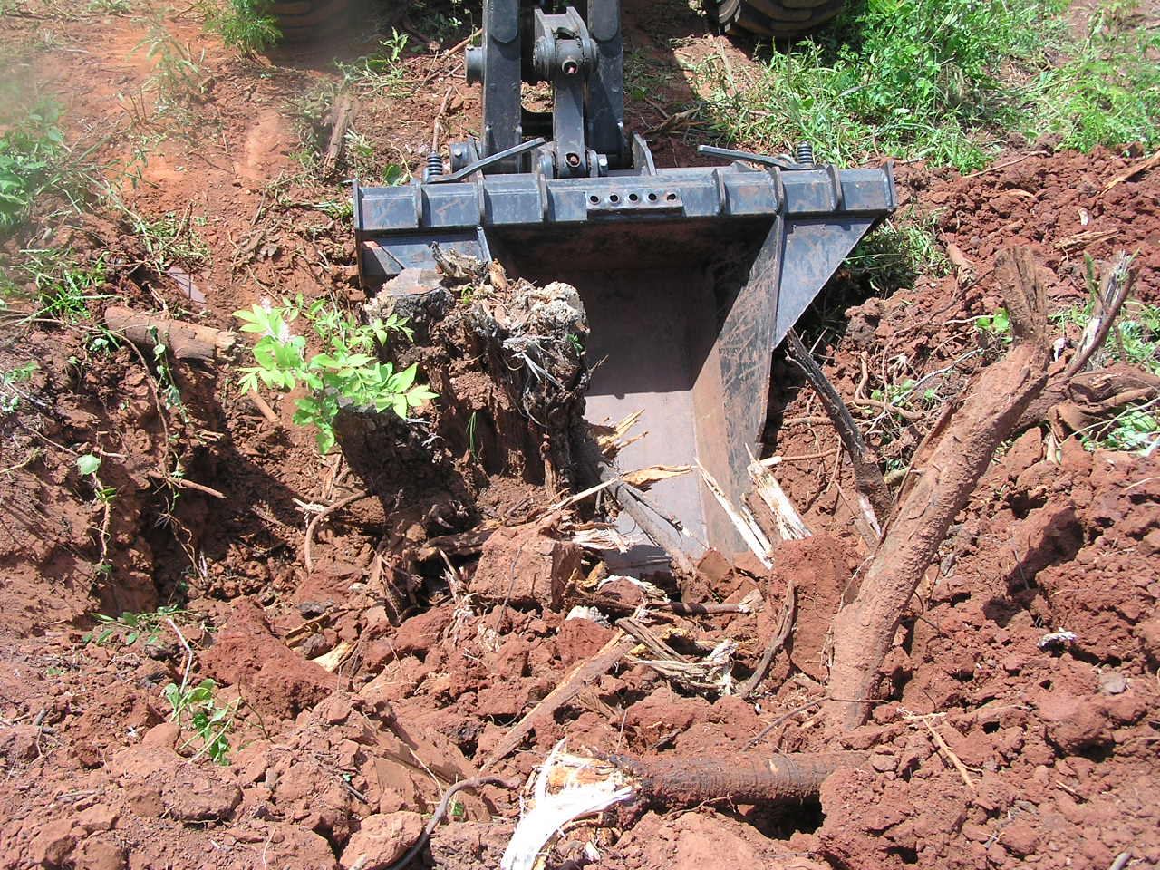

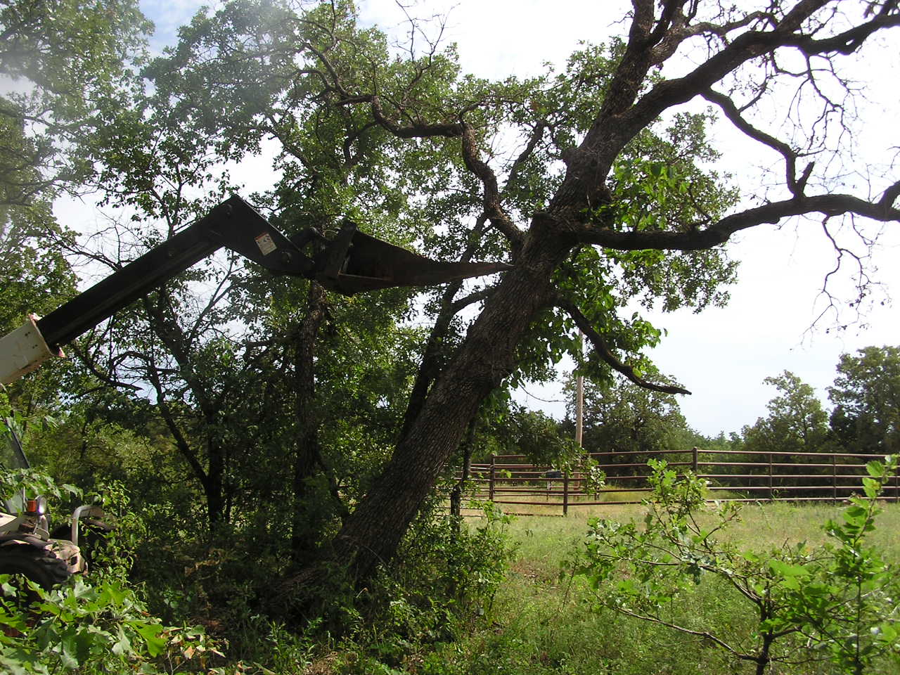

This is what I use instead of a skid steer back hoe.

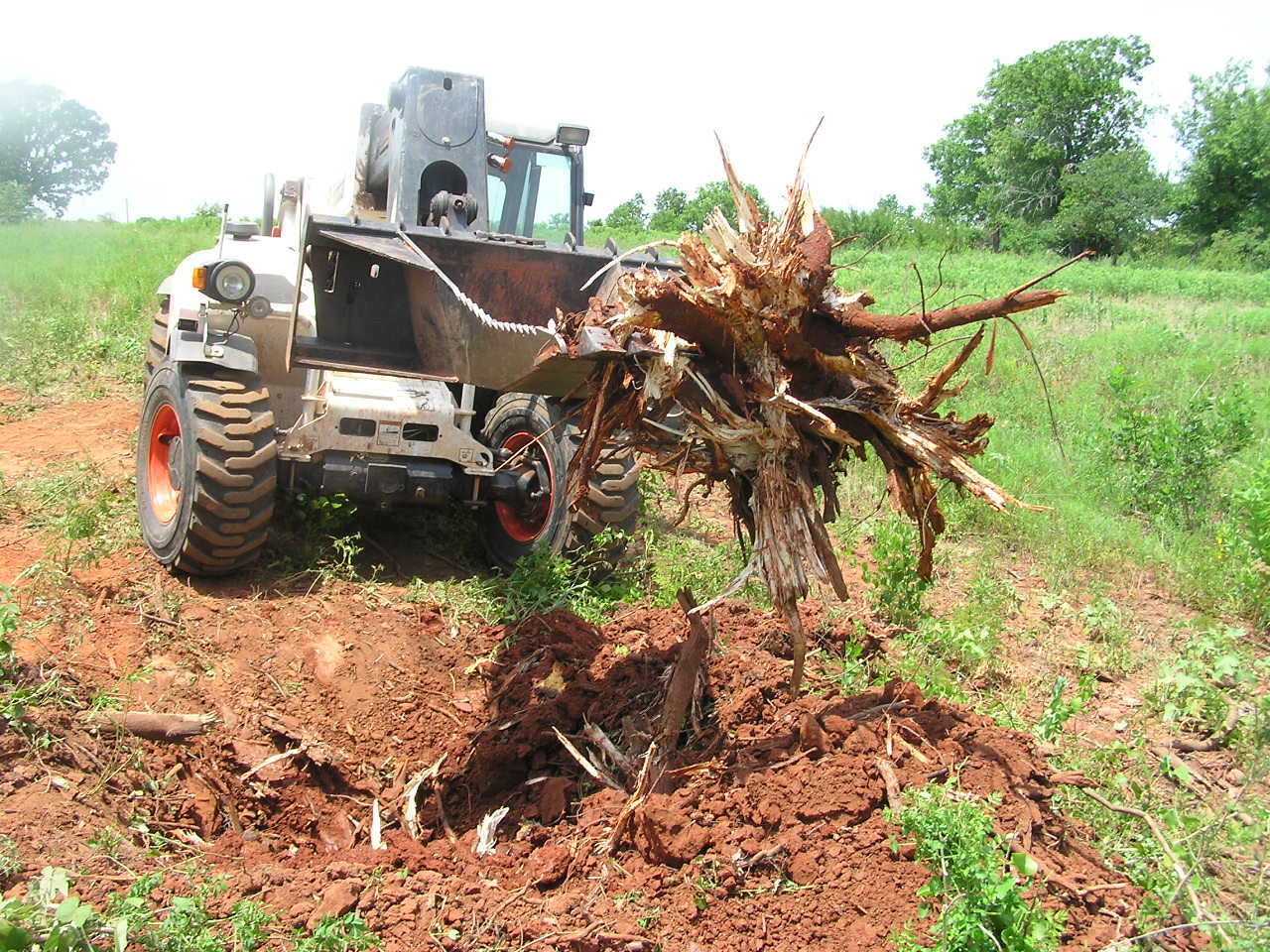

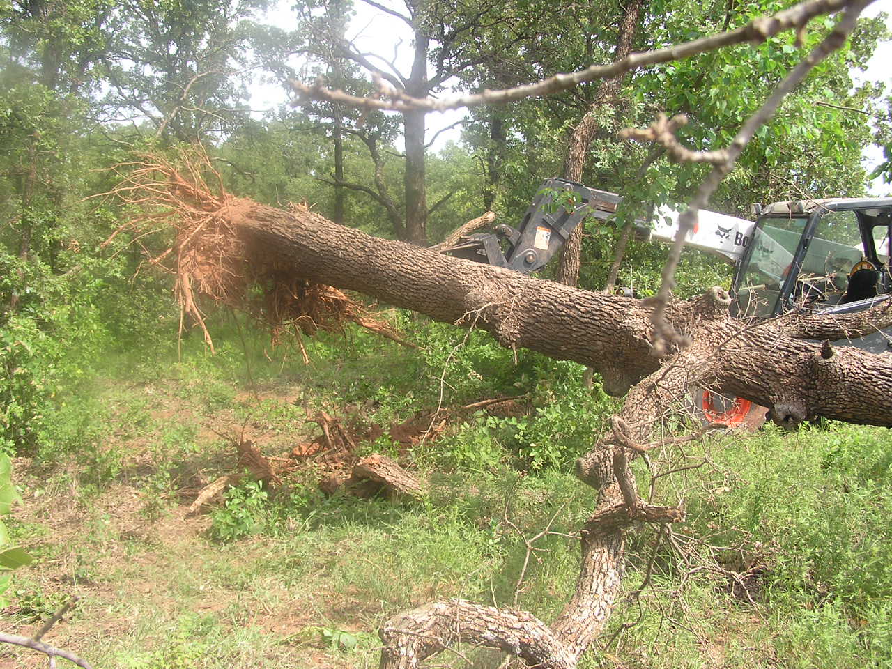

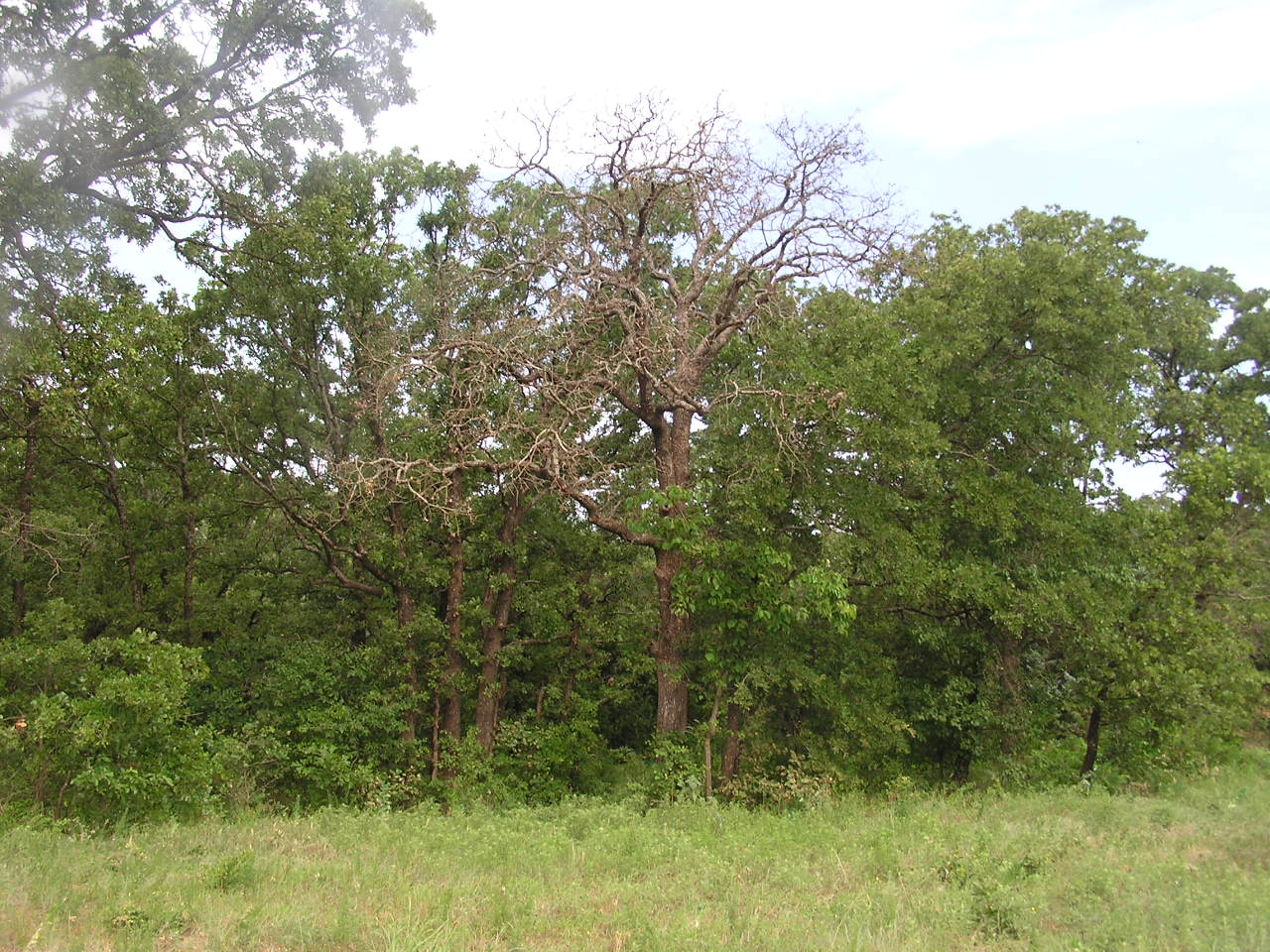

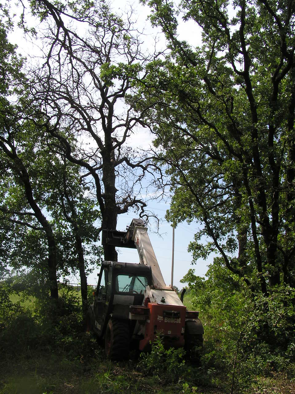

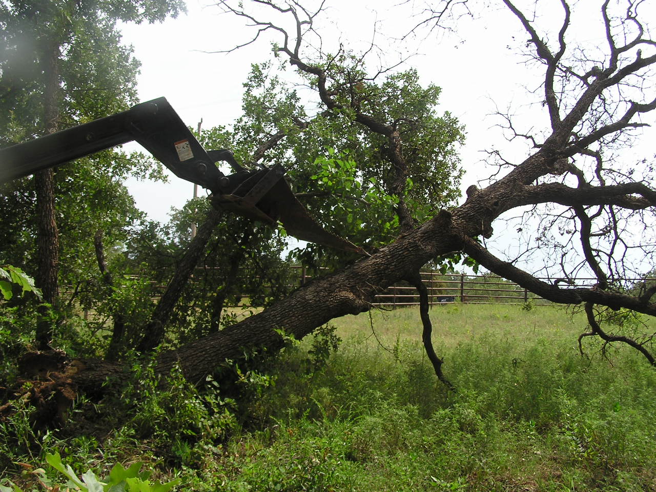

Pushed over this 40' tall dead Oak, didn't need to dig any roots on this one, some of the big roots broke off at ground level.
Had to pull the rest of the root ball out of the ground.

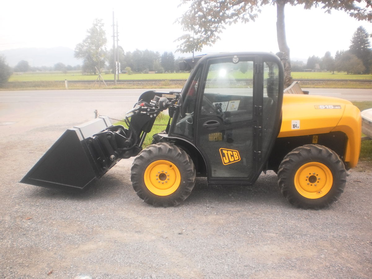

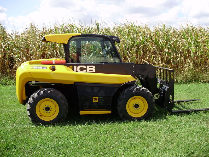

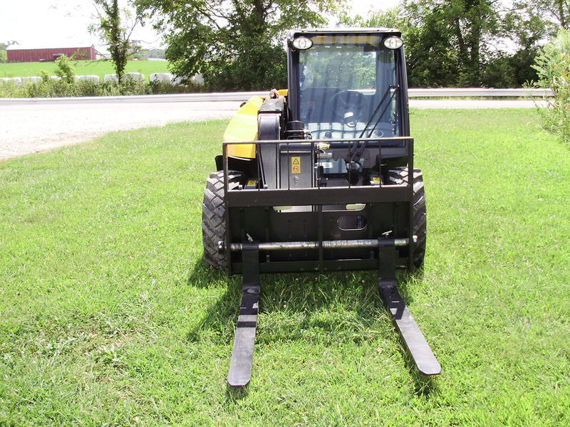

Here is one that is about the same size as the TL8, at five feet wide.
It has a SSQA and can use the same attachments as the TL8.

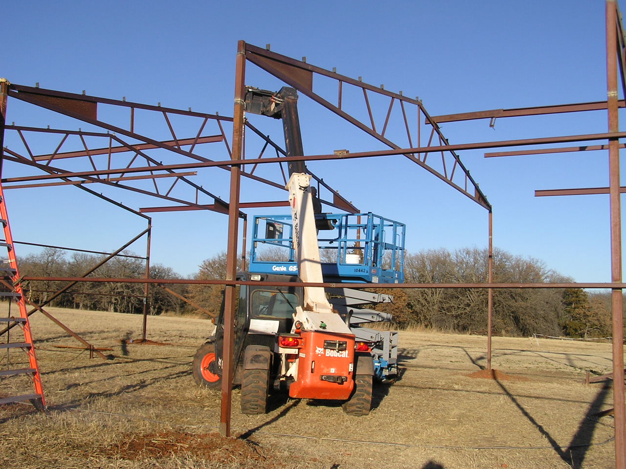

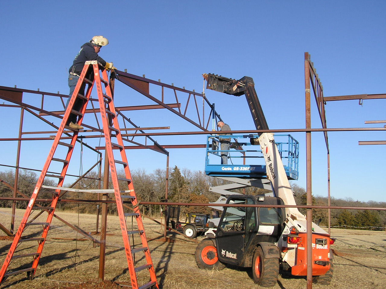

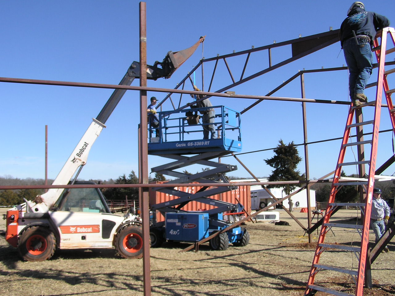

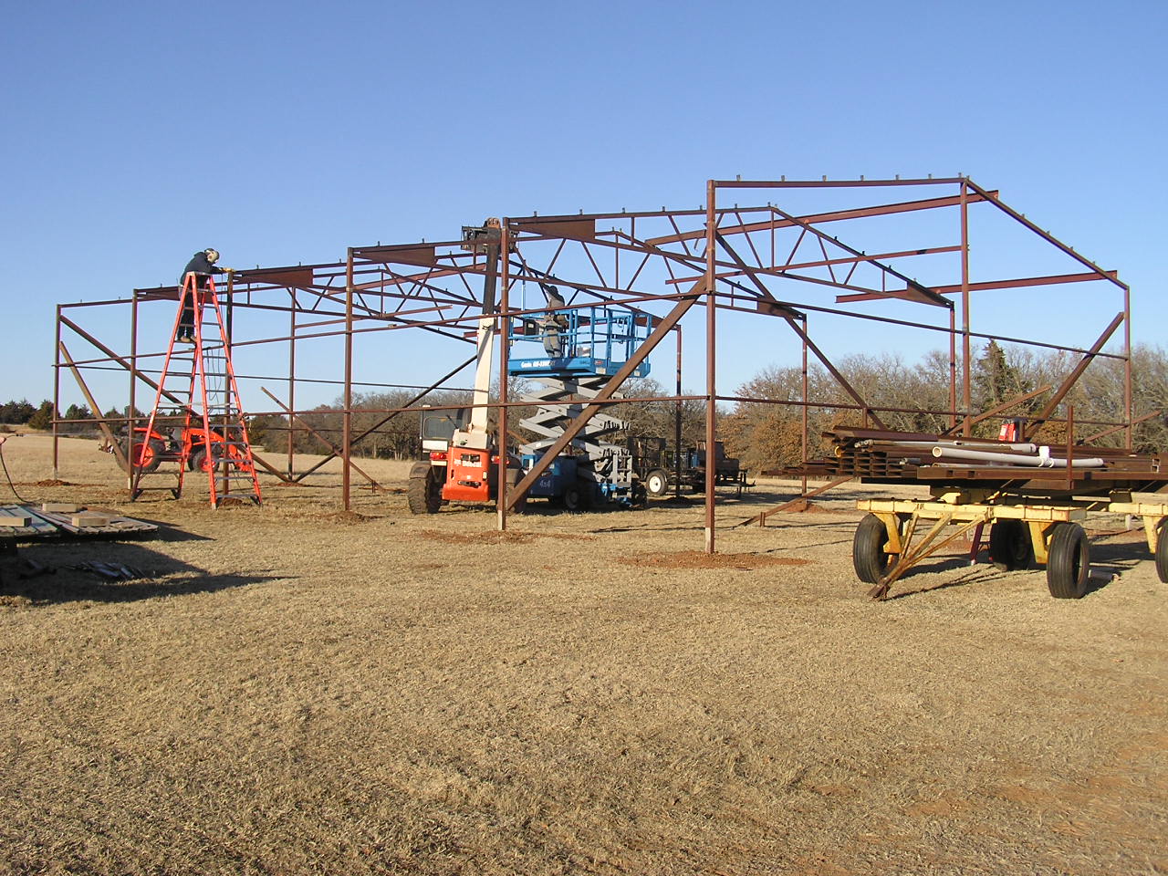

That reminds me, hauled it over to a friend's place to put the trusses up on is 40' by 60' equipment shed.

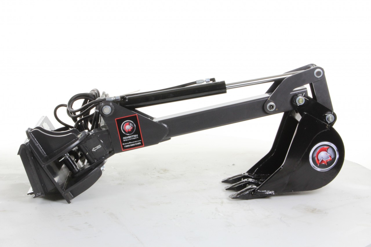

How about one of these for the New Holland L778.
Or if you need a deeper hole.
This is what I would get for the V417 if I ever need to go deeper than the stump bucket will dig.
