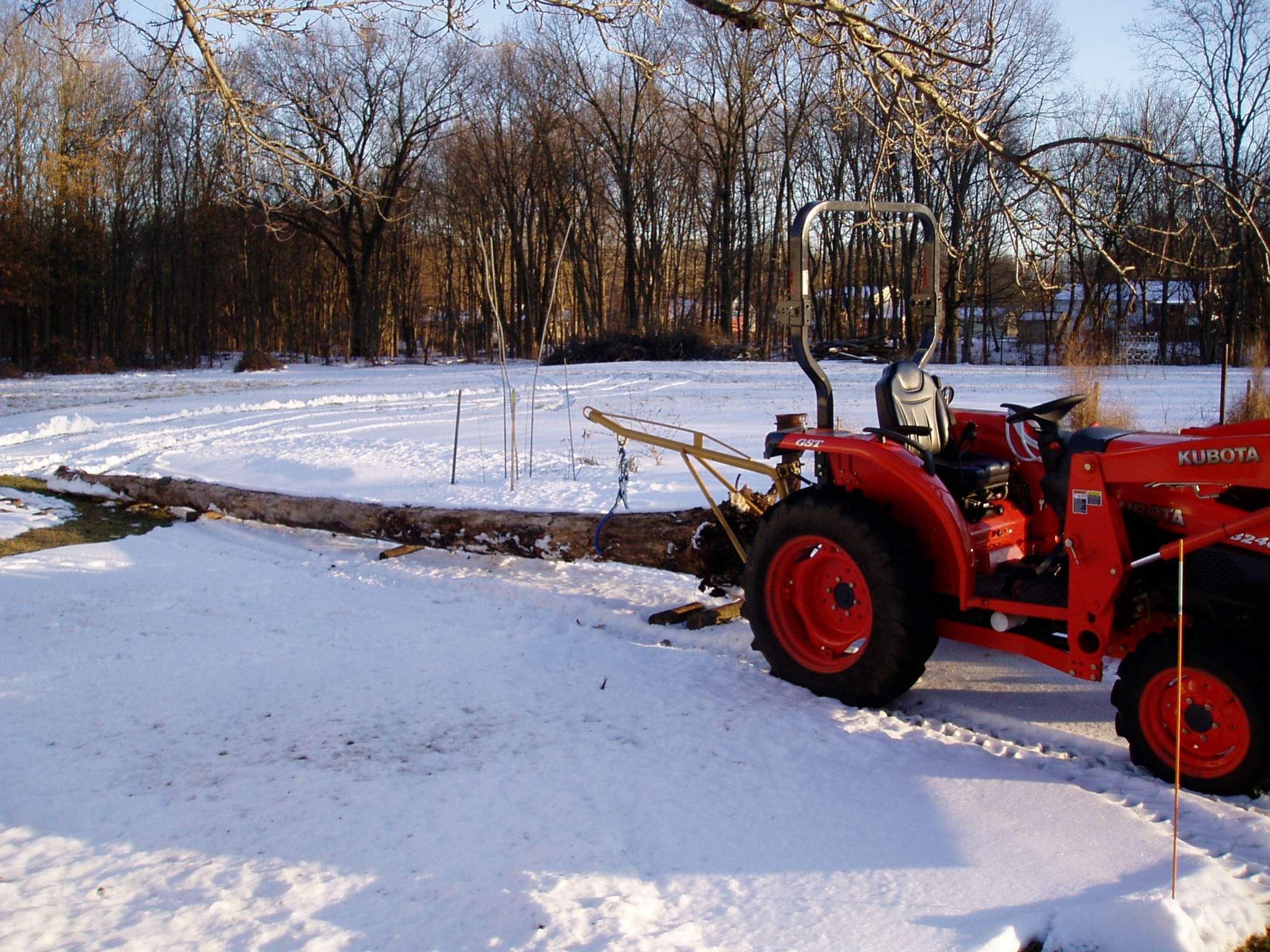

I am familiar with the boom pole/tongs team. By moving the point of suspension of the tongs aft, any dip you drive across drops the butt of the log even more. That's exactly why I use both the tongs and the choker chain (I'd already removed the chain right before my wife took this):

6011 artist,

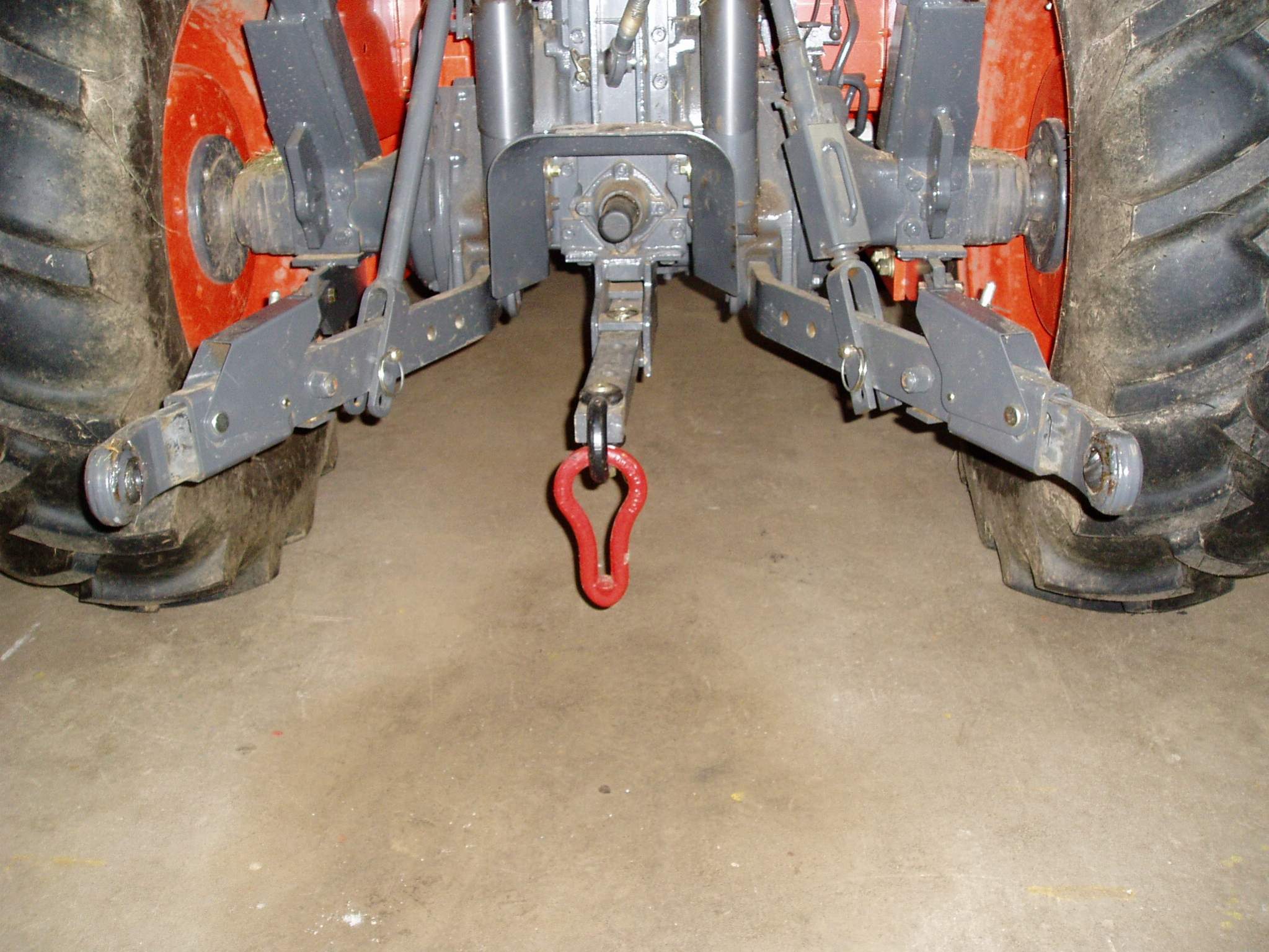

You wouldnt have a pic i could kinda go by would ya?BABY GRAND;that looks nice ,any shots of the rest of it so i could see how its hooked to the tractor?
No pictures of the entire works, but here's how I hitch the choke chain to the drawbar - it's quick & easy:
