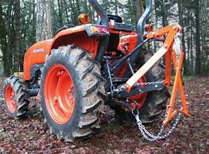

I don't need an expensive hyd. claw grapple so was looking for a setup to hang a grapple tong. I too was thinking of the added weight on the three point hitch with a logging boom attachment till I came upon the Small Wood Lots setup. It has a choker set up to to it that lets your drawbar do the pulling and the 3PH just lifts it. Seems to be made for 25 to 50 plus hsp tractors, but especially friendly and safer to smaller ones. It's a little expensive, but unless you like welding and are a fair hand at it. this seem like the way to go. At least for me. OIP.jpg

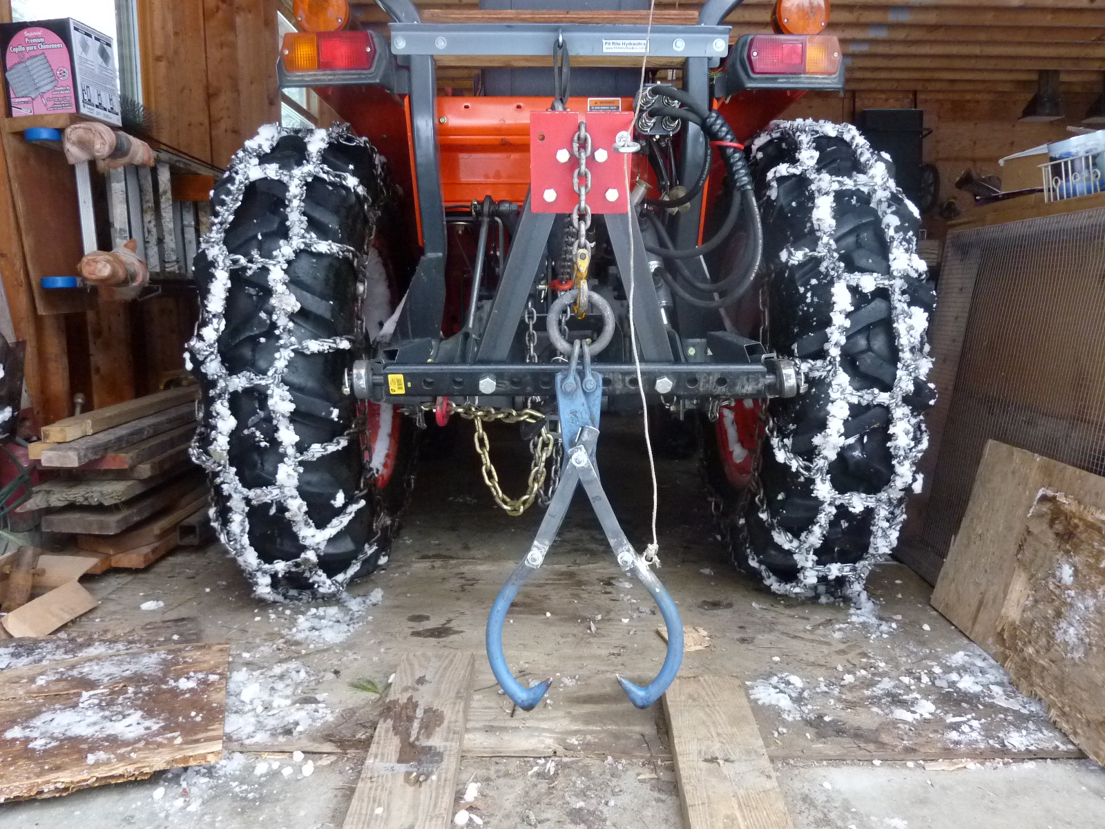

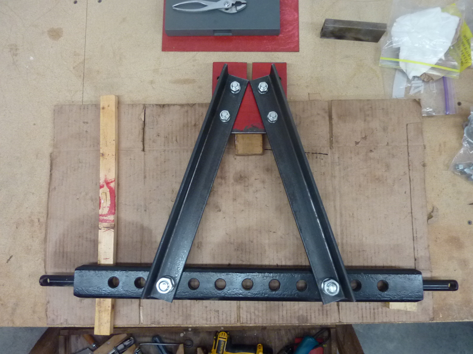

If you've read this thread you know there are tons of ways to skid a log. I made a rig similar to the one that caught your fancy w/o doing any welding. I used a draw bar from TSC, a couple pieces of angle, and a plate with a slot cut in it to make an A-frame.

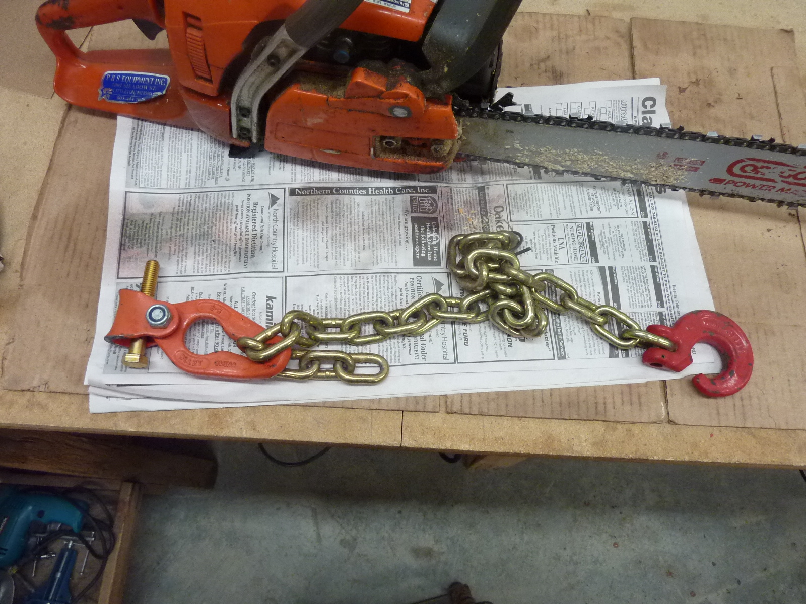

I used a choker hook and slider on a short length of chain for the top link. The pin on the tractor goes thru the slider and the skidding tongs hang on the choker hook. The chain sits in the slot to give a slight leaning out angle to the A-frame and it's length is adjusted with the slider keyhole.
Pretty cheap for me because I only had to buy the draw bar which is also useful for other stuff.
You have to get off the tractor to set the tongs the way I described but later I made it so I could pic a log w/o getting off the tractor but that took some minor welding.
