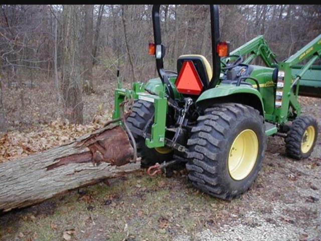

We had several oak trees blow over this year and block trails so now I need to move them out. I was thinking of building something but then I saw this picture using a quick hitch and tongs. I have tongs so I could do this for free. any reason why I should build/buy something rather than just do this?

If you drag a log down a hill, what are the odds that it will try to buck up against the back of your tractor with nothing to stop it? I only mention this because the tractor tree winches seem to be designed so that the butt of the log is secured against the winch for towing.
/ skidding logs #3
A lot depends on how big your tractor is (weight), how big the log/tree is, and your terrain. Not enough info to say much of anything intelligent, yet.

all of the trees we move are in hardwood river bottoms, we don't have any elevation changes to speak of, the only time I can think of that being an issue would be a creek crossing. I would have to look closer at the tractor but I believe the quick hitch would keep it from going into a tire and the draw bar being extended should keep it from hitting any thing else on the tractor. the log would have to be lifted very high to get above the draw bar and I don't think I have that much 3pt lift.
Thank you for bringing that up, I really don't want to tear something up!

That is a great way to move logs without a lot of "new equipment". I've been doing it for years.
If things get dicey, just drop the load.
It's not rocket science!

I wouldnt worry to much about the log pushing the tractor down hill. It would have to be really steep for that or s really smooth log.
I have used a chain or log tongs over the back edge of my box blade. Anything really works.

Thats what your PTO shaft is for. Log Stopper.

Don't lift your 3 pt all the way up when skidding unless you are not driving. If the log starts coming at you drop the load on the ground.

Drawbar would be the lowest center of gravity, but you can't raise the butt of the log to keep it from digging in unlike the rear 3pt. Have to be cautious with the 3pt not to get in a situation where the tractor can tip backwards. FEL might get tweaked trying to pull a large log.

That seems like it would work well. Both tractors have some weight which will help you stay in control. Start out slow until you learn the limitations of your tractor, and how big of a log you feel comfortable working with.
If you do hit a spot that's dicey you can always drop the load and hook on with a chain. That just will meam more filing when you start cutting them up.
There have been a lot of logs dragged out using a chain and drawbar.

What would be ideal would be to lift the butt of the log with the 3pt but pull from the drawbar.
I suppose you could lift with the 3pt, but drop the log onto a sled to pull from the drawbar. Some guys used to use car hoods to skid things around. Not sure if the current car hoods would stand up very long to that use. Or look for a good sized piece of steel plate you could weld a lip on so it doesn't dig into the dirt. Or take a 55 gallon plastic drum and reshape it into a logging cone.

We haul ours on the cable. Drop them, drive forward, then winch back to the tractor. Logs don't slide by themselves.
