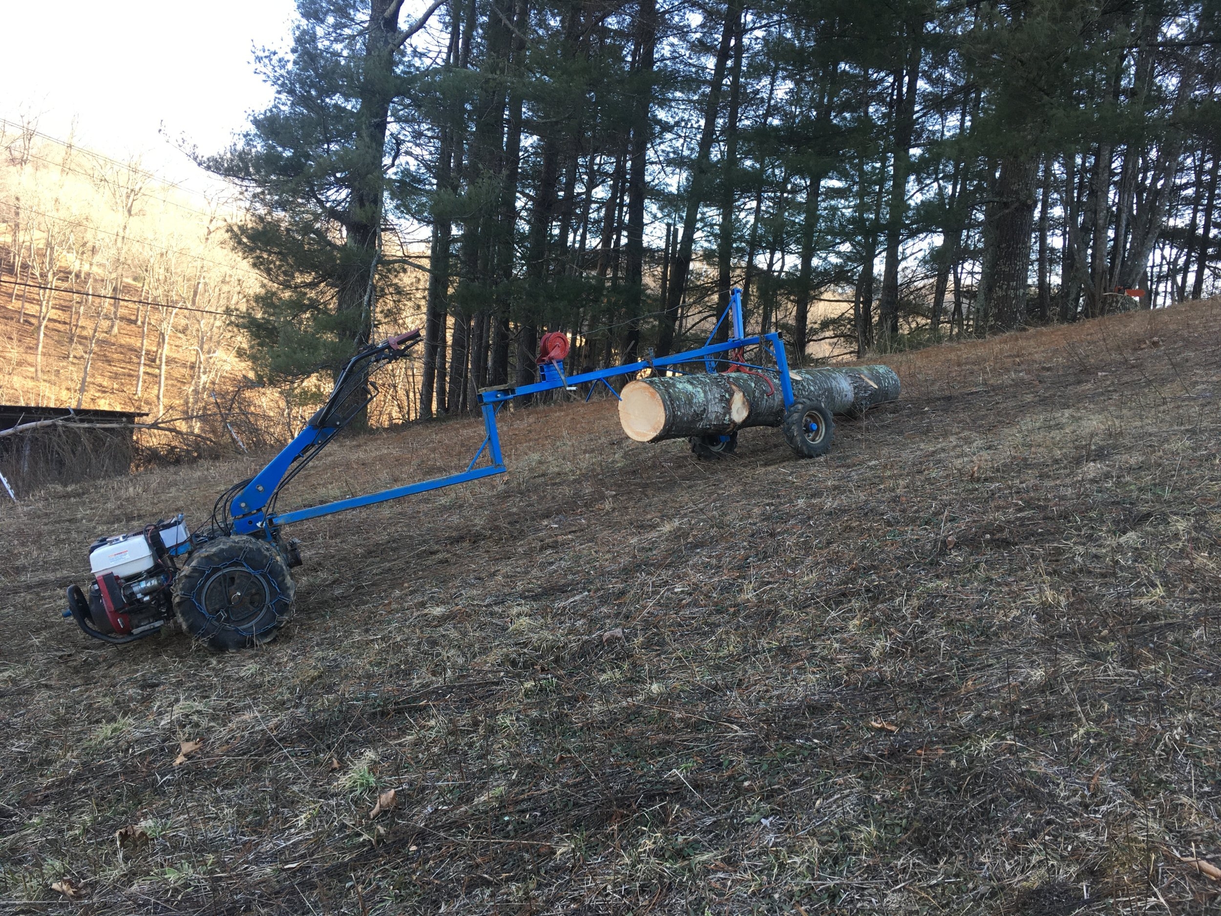

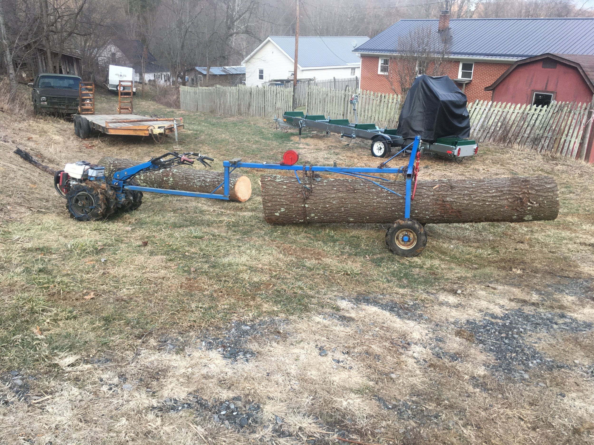

Here is a fairly small logging arch, built to handle a 25" by 16' log. Started off for a 2wheel BCS tractor, but I also made the hitch so I can pull it with a regular tractor or a truck(slowly) I usually use tongs to lift, but I can also use chains or chokers. Built the arch out of 2" tube, old trailer hubs and leftover tires/wheels. Just a hand winch on top, I think I'm on the second one so far( I tend to try to pick up stuff that may be too heavy)
I now have a Farmi winch, but the arch is still useful.
