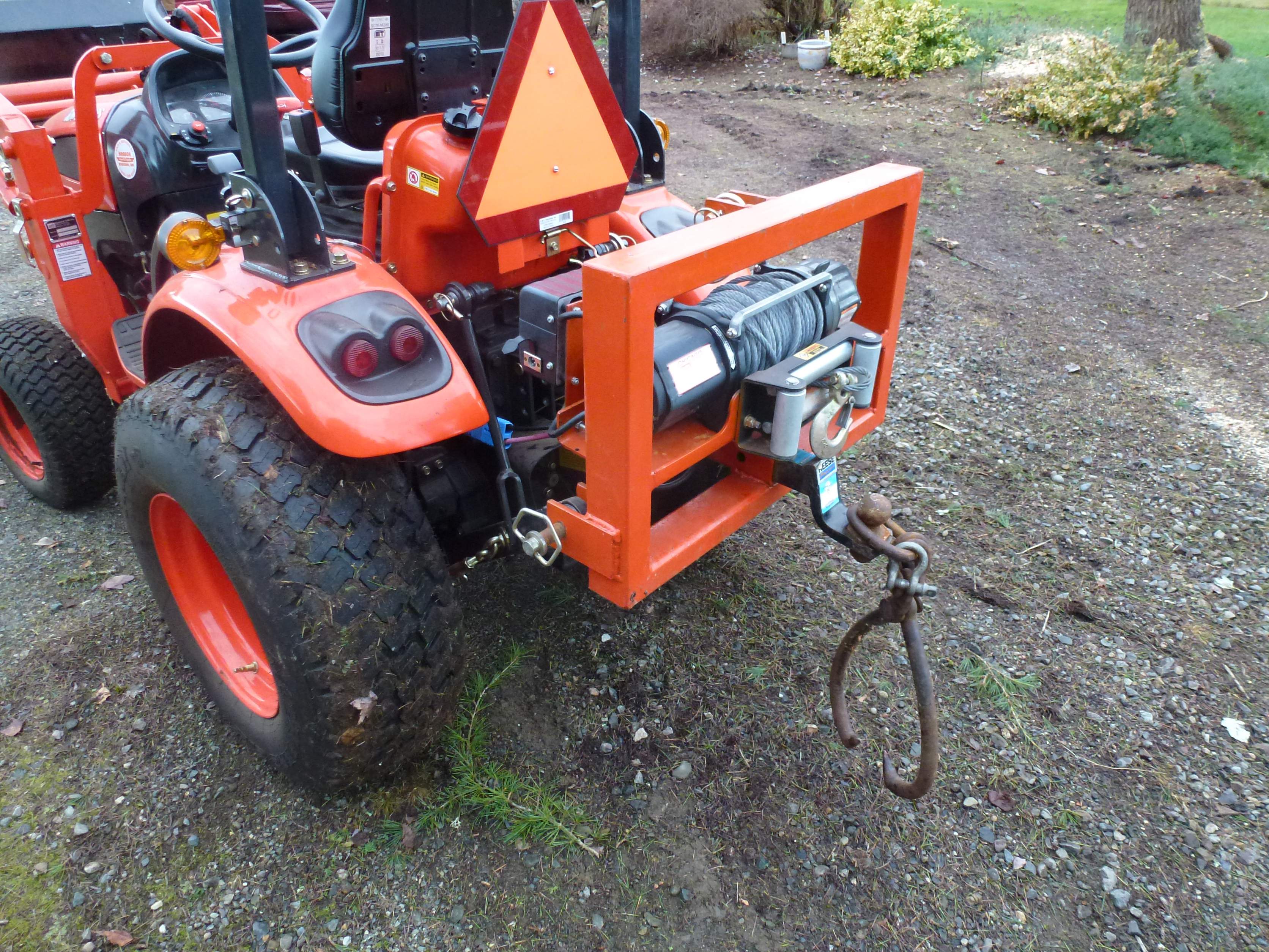

The electric works well, my hydraulic works better. I used to build pto winches, wish that koenig still made winches.

Thanks. I wonder if you could get that speed and power out of a hydraulic (affordable) winch.
Depends on what you view as "affordable" along with your log size. Ramsey has a 8000# hyd planetary winch that runs around a ft./second for around $1200. Slow compared to pto winches but on my rocky & previously timbered (stumps) property, I'd get in trouble or break something at 2+ feet a second. Like anything, there are clear advantages to each. One is the speed & cable capacity (pto) vs. having reverse (huge in my use). I'll get jammed up against something and moving the valve lever is much simpler than mounting the tractor and backing up. MileMarker makes a 2 speed hyd. winch that the military put's on the Humvees that also has a decent line speed but iirc the high (fast) speed is greatly reduced in power but for a firewood cutter hauling smaller stems or thinning might just a good economical fit.
