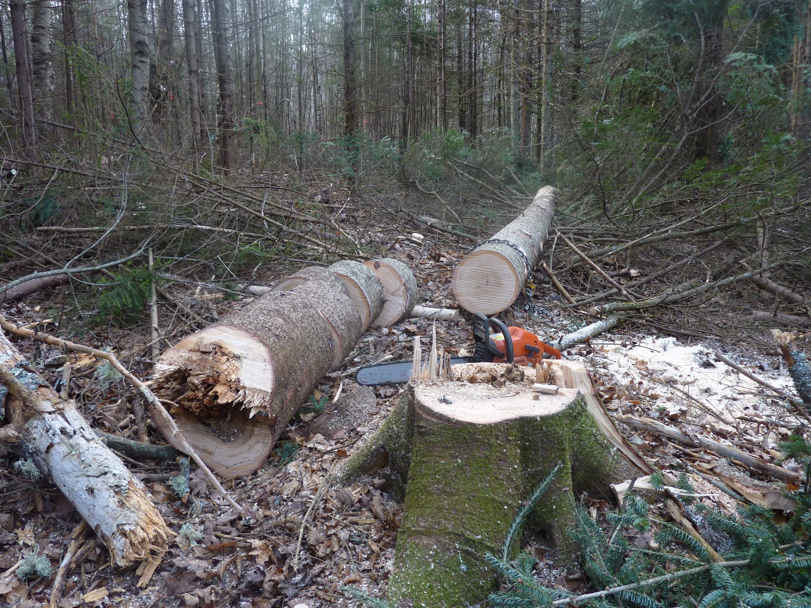

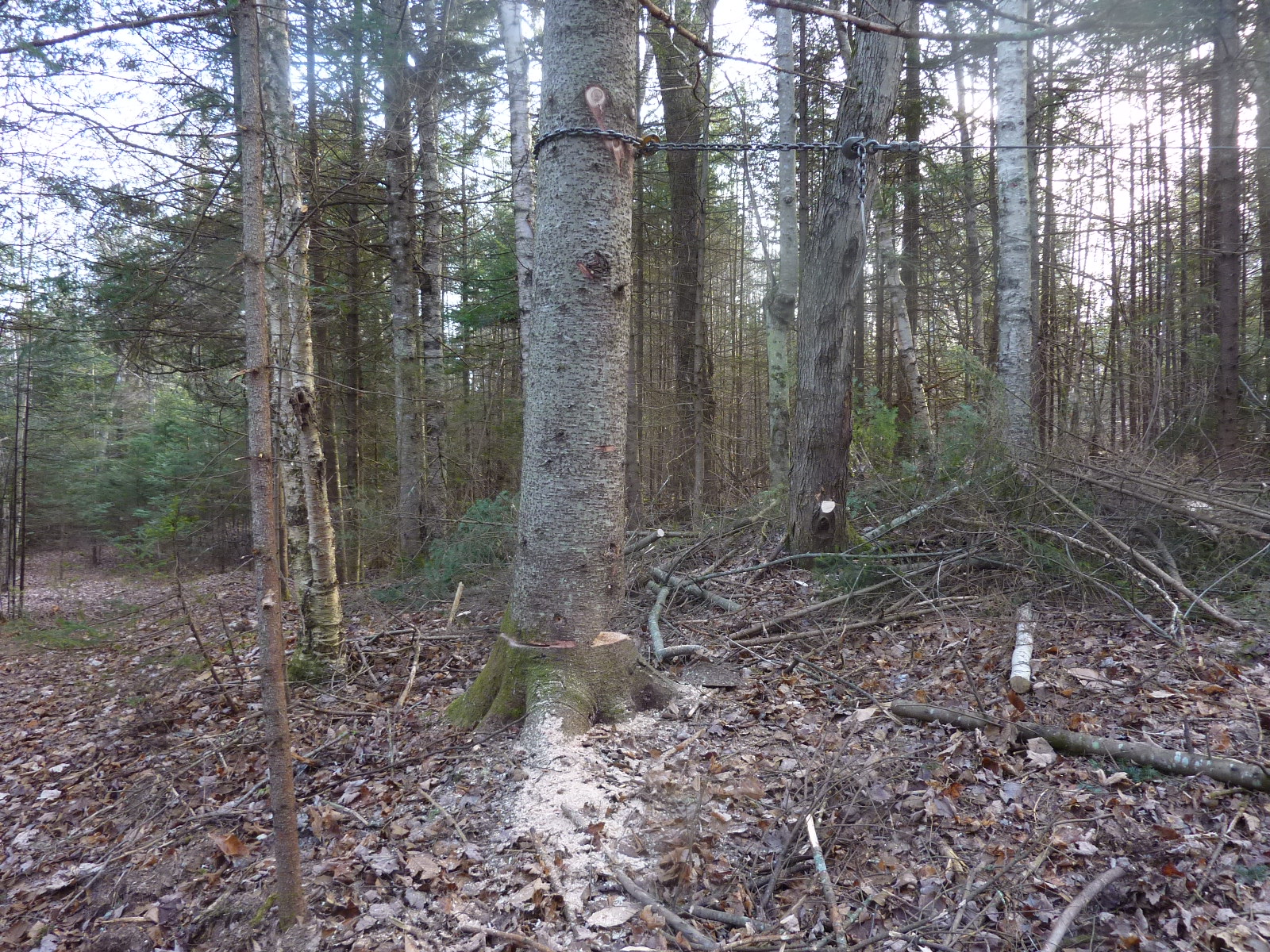

Doing my thing cutting fir today I came to a tree with a dead top. The top ran up thru some small branches of an adjacent maple. Normally it would not be a problem to get the tree to fall thru the small branches. But since the top was dead I elected to pull the tree down with my winch rather than work under the tree sawing when it started to move or worse hammering a wedge trying to make it move. I set up snatch block and took the slack from the cable.
Then I cut my notch and back cut. While cutting I kept a close eye on the kerf to make sure the tree wasn't moving. I left an extra heavy hinge for stability. That is why I got all the stump pull. Besides the dead top these fir I am cutting also have rotted bases which is why I am cutting them.

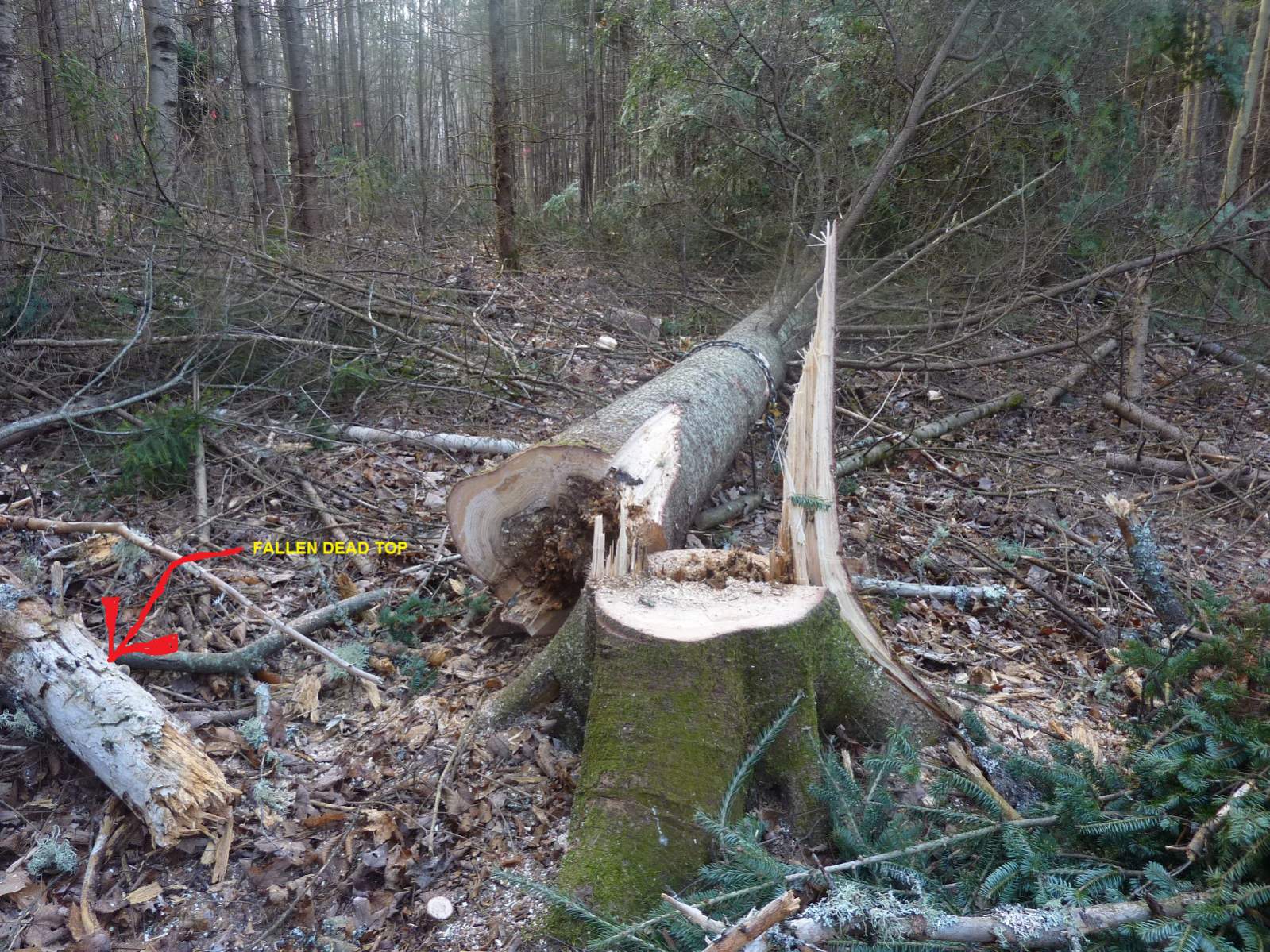

I pulled the tree down and as you can see the dead top fell right in the area I would normally be working. A winch is a real safety benefit on trees like this and I never hesitate to use it when there are dead limbs over head.
It is all limbed and the rot cut off the butt. If you look down the log you can see that the top is missing.

Gordon, since you have a lot of stump rot I suggest that you set up your notch on the outer edge of the tree and then bore cut to finish up the hinge. That way you are sure of what you have for hinge wood. A hinge in the middle of the stump is pretty weak when placed in the middle of a rotten stump. All the live wood is on the outer circumference. I learned that in GOL training cutting large hollow beach trees.
   / Skidding Winches #100
Thank you for the good suggestion. That is a very good method to use when cutting a hollow tree that you want to lay in it's natural lean. But no one way works for all trees. And many ways may work for any one tree. This was my thinking on that particular tree - it had some back lean which the winch cable was holding during my cut and I intended to eventually pull the tree over with the winch. I did not use a bore cut for the back cut but if I had the result would be the same. That is, when the trigger was cut the tree would not fall because of the back lean. In addition, all of the branches were heavily on one side of the tree which is the same as side lean. So my biggest concern was keeping the tree from going over sideways. I elected to make a thick hinge in the wide part of the tree to give me maximum side support. Even though the center was rotten I had good holding wood directly behind the side lean to hold it.
If you look at the fourth picture down, where I have rolled the rotted butt log pieces that I cut off 180 degrees you get a good view of the notch cut. It is right on top. You can see that even if I made a tiny notch with little depth it would not give me any more holding wood in the hinge than the way I cut it. And being in the narrow part of the tree and in front of the side lean there would be much less support for the side lean I was concerned about.
